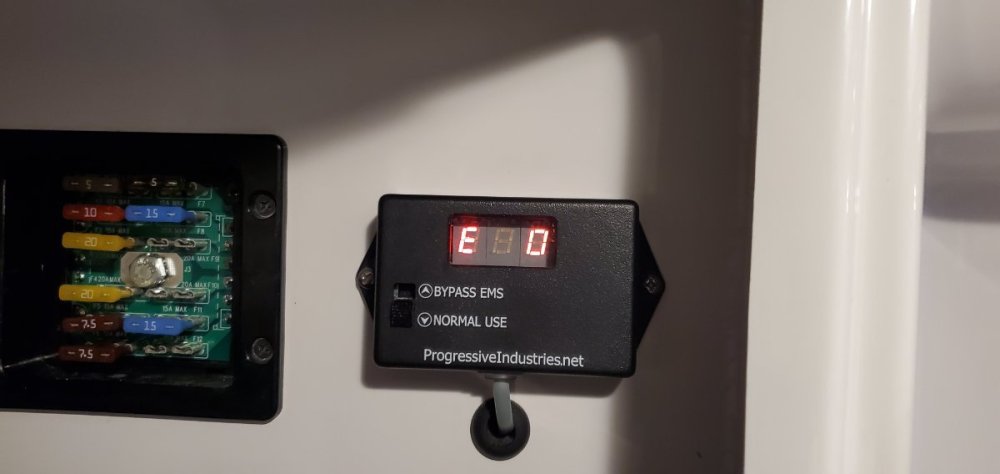

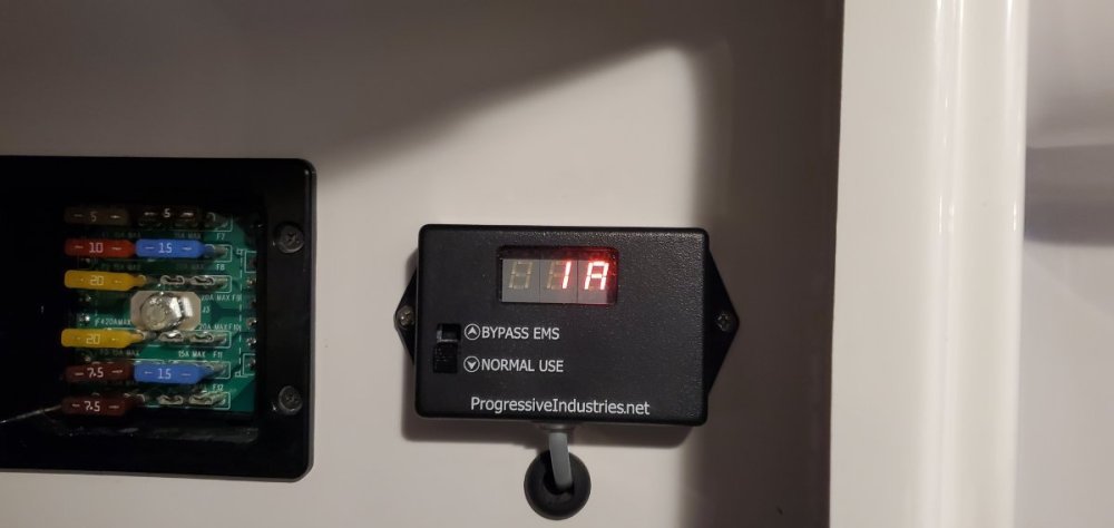

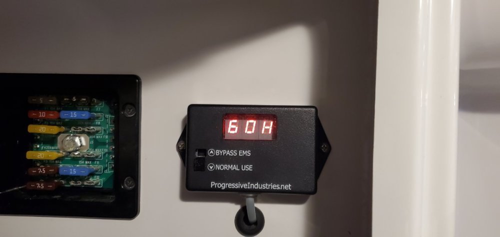

Viola:
My trailer had the tail light issue being on whenever moisture got into the 7 pin connector (could also be corrision in the plug as John indicated). Keep this trailer connector dry by tucking it up behind the fiberglass body at the front metal frame or buy a device to keep it dry.
As far as the shore power - Are you plugged into a 30 amp circuit? If not, you may have a ground problem in the house circuit. Is your house circuit a 3 prong (grounded) outlet? As mentioned by Jim_Oker check the EMS readout to see if you are getting any error codes. My Oliver likes a 30 amp RV trailer receptacle the best. When I plug into a house 3 prong 15 or 20 amp house grounded receptacle sometimes I have to unplug it and replug it in for the EMS to not show a error message.
Below are pictures of the EMS messages. It will flash between E-0 for zero error codes; line voltage, RV amp draw and Line frequency. If you are getting a error code (not a zero), thee is something wrong with the incoming power and the EMS is (protecting) the RV from getting unreliable power coming in.
Hope this helps. Good Luck
