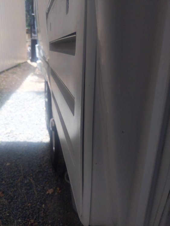

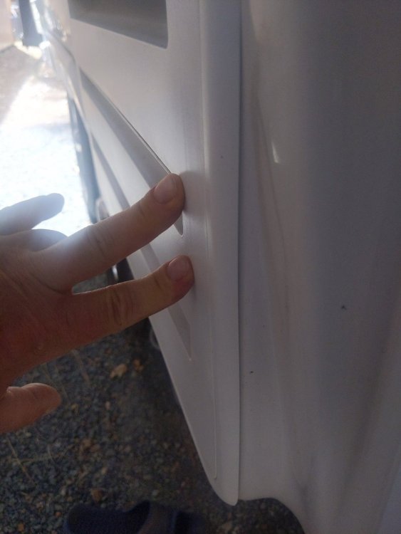

hello, just noticed this after a camping trip, the exterior plastic panel (fridge) seems to have warped a bit, maybe it's picking up some of the wind which is pulling it out?
I'd hate for this problem to continue and discover that I've lost the panel. Other than duct tape, I'm hoping someone has an idea of how I can make this flush again.
I'd put in a Service ticket and see what they have to say about this.
Obviously, if you are still under warranty then it will be a "no brainer".
If you are out of warranty then maybe look at a piece of aluminum angle or tubing attached on the inside of the vent.  Maybe a piece on each side or just one in the middle would suffice.  You could experiment with different stiffeners and temporarily attach it with zip ties.

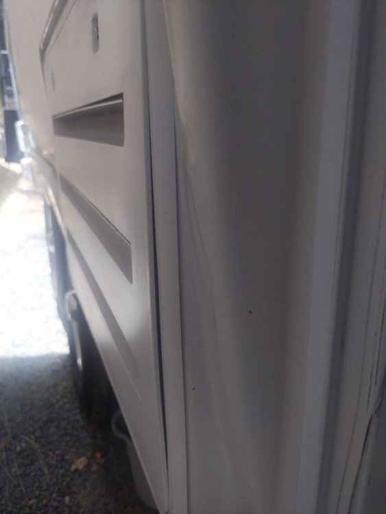

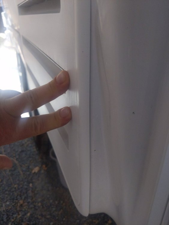

I just submitted a work ticket on this same issue. We are still under warranty. I have requested service send me a new frame and refrigerator vent panel which I will install. I sent a video and these pictures to Mike Sharpe along with the work ticket.
Add/edit - here is the left side of the vent which sits flush -
Update - Mike Sharpe let me know he is having the parts department ship me a replacement vent frame tomorrow.
Yet again, awesome Customer Service by Oliver Service Center Staff. I will post up a few pics after I install the new vent.
