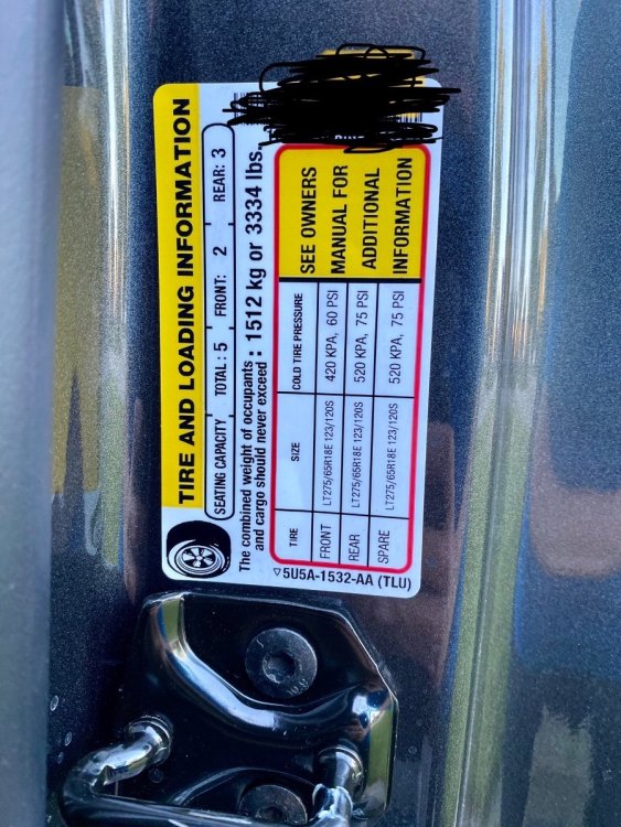

There should be another sticker that looks like this with the statement “The combined weight of cargo and occupants should never exceed…..”.  That is your payload limit.  And the tongue weight of the trailer counts toward that payload number.  An Elite II typically has a tongue weight of 500 to 600 lbs. so that plus two adults gets you to 1,000 pounds of payload real quick, and then start adding any camping gear, a bed liner, bed cover or cap, etc.
I will go look again. I totally gooned up the payload 🙂 I was adding and subtracting the wrong numbers.

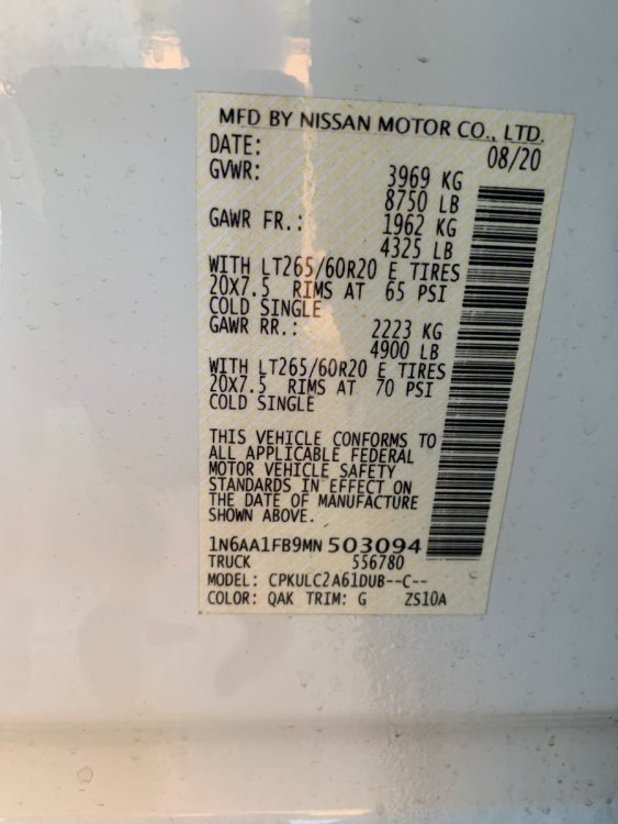

Your GVWR is 8,750.  You need the empty weight of your truck as optioned to subtract from that number. I think you made a great choice for the TV.  Larger brakes, higher payload, etc. Also the color will match perfectly with your new Oliver!
Looks like payload is about 2K. Thanks again Chris! It is quite a vehicle And rides and drives like a dream.
2022 EII owner, Hull 1284, Tow Vehicle: 2021 Nissan Titan XD. 2022 lithium pro package which is 630 amp hours and 340 watt panels with a 3000 w inverter.
The sticker you posted previously does show the GVWR (Gross Vehicle Weight rating) of  8750 pounds. That is the heaviest it can ever legally weigh. If you were to weigh the truck with full gas tank and no cargo on a commercial scale and subtract it from that number, that figure is what you have left for payload. That method takes into account any aftermarket stuff a previous owner might have added, like a really heavy rubber bedliner (100 pounds) or heavy offroad accessories like steel bumpers and skidplates, up to 500 pounds 😳. The factory payload sticker represents how the truck left the factory, before a dealer or an owner started adding stuff to it.

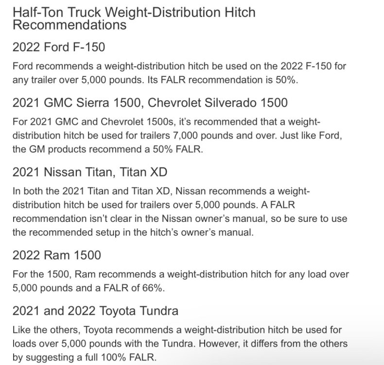

Another spec will confirm you need the Andersen WDH.   See the table John Davies posted earlier.   It states the Maximum Tongue Weight capacity for a Titan XD  hitch is 500lbs (no WDH).   Your vehicle  might be different, but probably not.  That spec is not on the door stickers, it may be in your owners manual.     The Oliver LE2 Tongue Weight is 490 lbs, empty & parked, without the front basket.   Therefore, you will likely be over capacity without the Andersen WDH.  If you are ever involved in a crash (your fault or not) your insurance contract could be voided, because by law you must adhere to OEM towing specifications.
