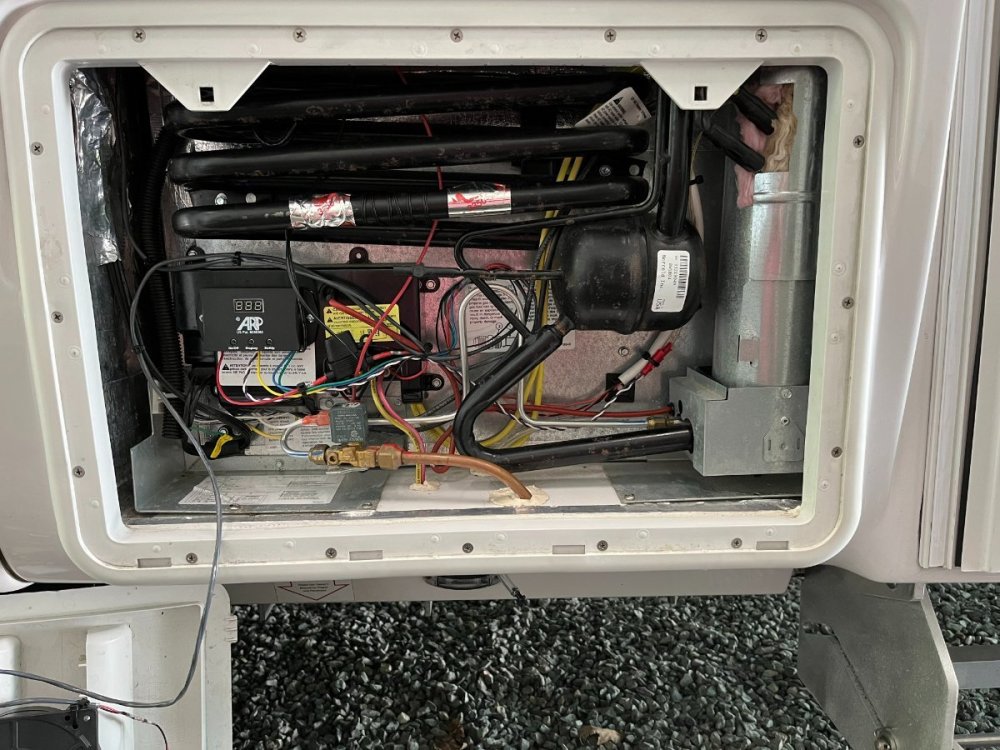

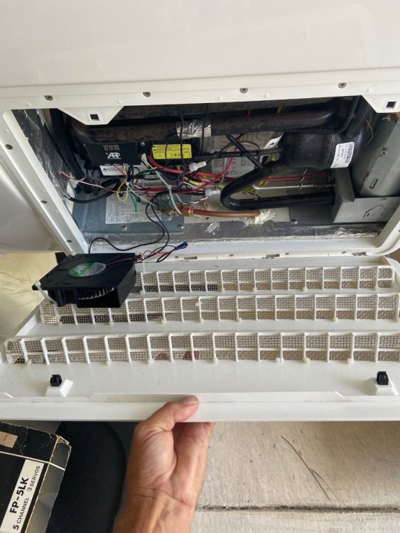

Installation was easy. Hardest part was deciding where and how to mount vent fans. Used double sided VHB tape along with a long screw for added support on the upper fan and zip tied lower fan on vent panel. Would liked to have centered lower fan left to right but space constraints dictated mounting to the left.
Thanks for the pictures. A couple of follow up questions.
  1. Are these fan weather proofed and safe to use when it's raining or towing while raining?
  2. How did you get 12V to the upper fan?
Updated: I found some answers from ARP website but couldn't find whether the fans are weather proofed.

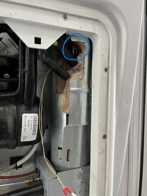

Where in the bottom pic is the location of the temperature sensor ?  Is it behind the shield on the right side?

The fans are not weather proof as far as I know. However, I have not seen a significant amount of water entering through the frig vents while traveling in rainy weather. When washing the trailer I try to be careful with hose and not direct water upward into the vents.
     When installing upper fan I used 20 gauge wire to extend the leads off the ARP module to the fan.
     Yes, when sitting under the awning the fans can be heard occasionally. More so on very hot days. Not too annoying though.
     There are 2 temperature sensors. One is mounted against one of the horizontal tubes that zig zag on rear of refrigerator and the other is behind the heat shield on I guess what you would call the boiler tube. The instructions are very specific where to mount probes on the tubes. Especially the boiler tube.

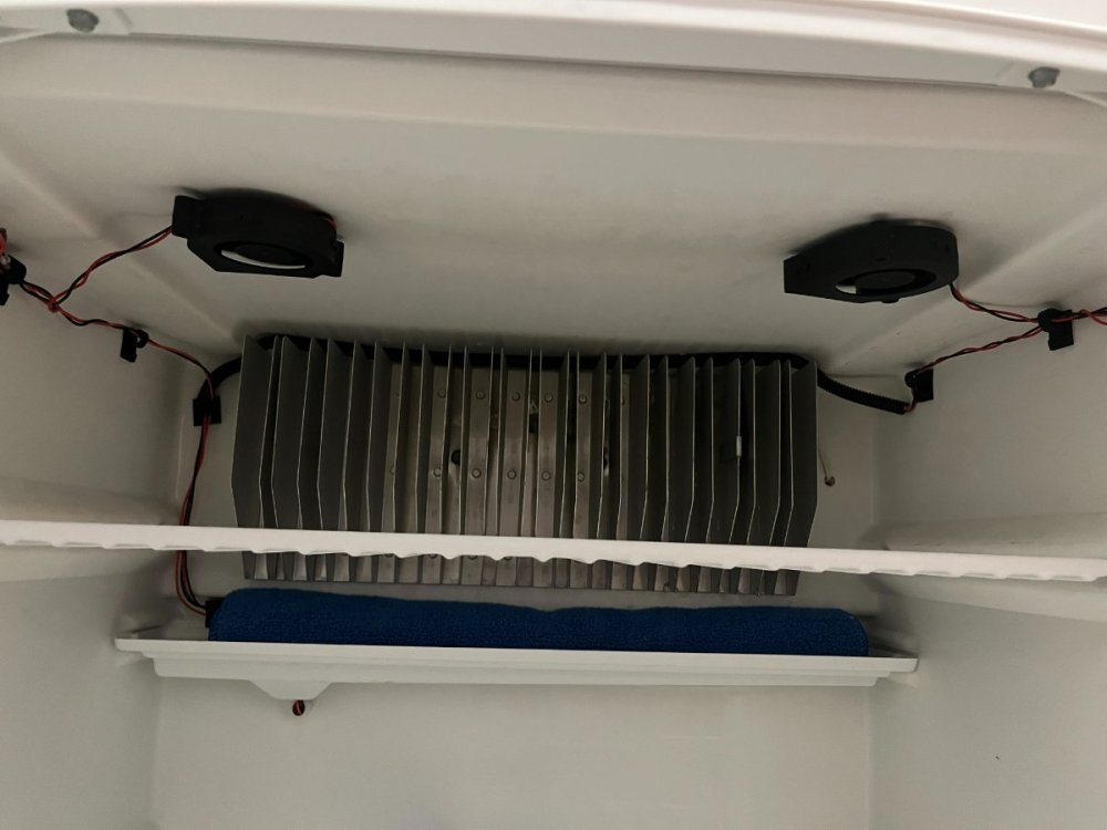

I just installed the full kit with the 4 additional fans.  Glad I did as the fans seem to have an immediate positive impact on efficiency on hot days even though Oliver had already installed one fan within the vents.  Based on some initial tests, I'm pretty sure the ROI is pretty good for this device on efficiency improvements alone.
The installation on our Norcold 4000 was pretty straight forward but tedious with all the small wiring required for the full kit with fans.  Fortunately I did not have to remove the fridge to get the sensor on the boiler tube.  I also had an easily accessible drip tube to run the interior fan wires.  It took me 12 hours start to finish (4 hours per day for 3 days).  That includes the research, planning, getting the electrical components needed and the installation, testing and configuration.  Of course, knowing what I know now, I could install another one on the same model in a couple hours max.  🙂
Here's a few pictures - not a lot of detail as online manuals and videos are really good - and each fridge is going to be different wire colors, etc.  I mounted the external fans pretty much exactly like @C&MCurrie, so not going to duplicate those.  Happy to answer questions though!
Here's where I put the boiler tube sensor:
 And here's a picture of the two little fans I installed on the roof of the fridge:
What it looks like after the install:
