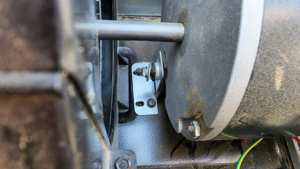

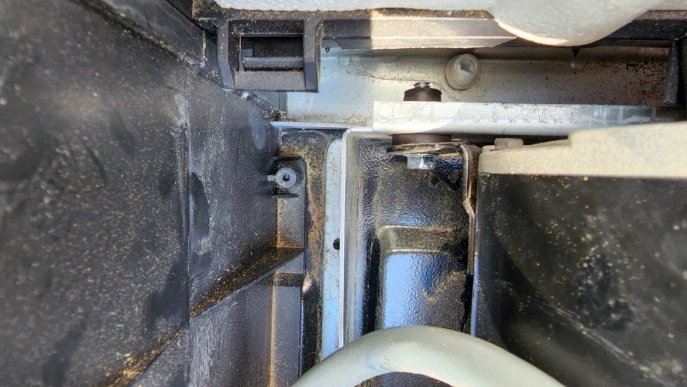

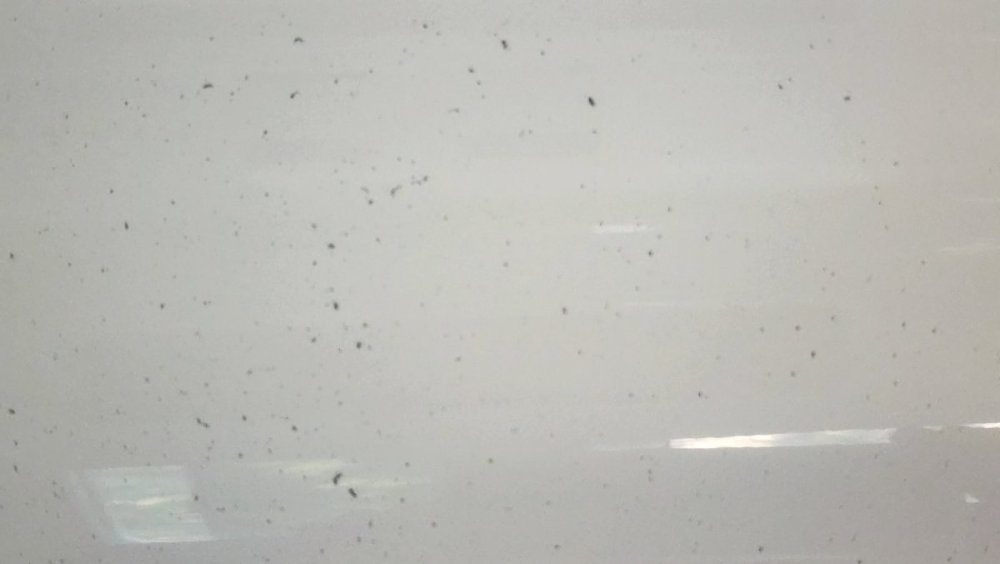

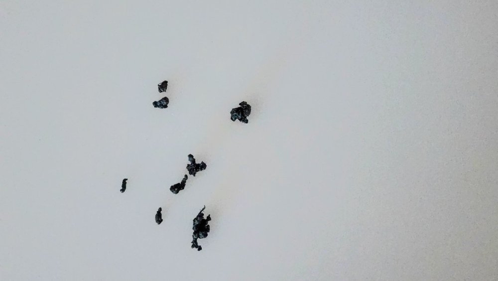

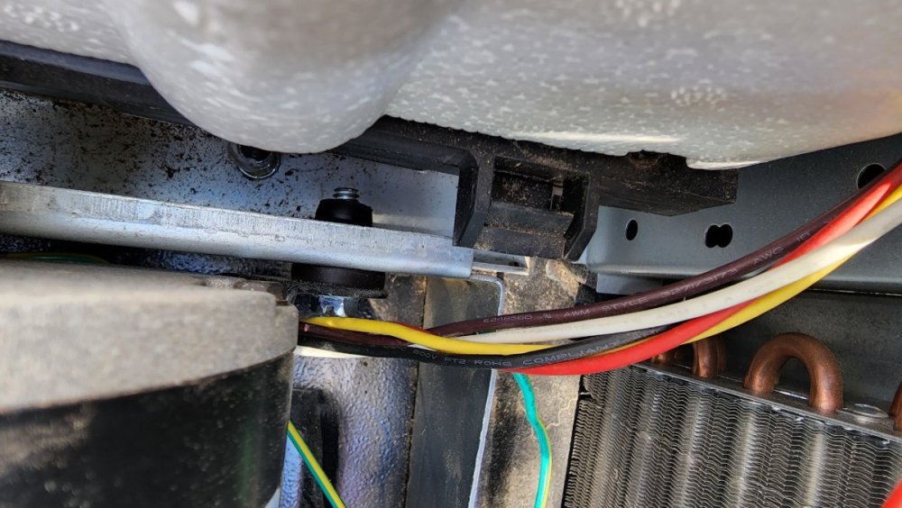

Mine was a little different....Upon starting the a/c after not using for a week, we encountered a very strange noise as the fan came on.  We shut it off and I removed  the outside cover to inspect.  We had a frog get on the fan blade of our Casita and that was a strange sound as well and I was expecting to find a similar problem.  Upon a quick inspection I found no critters, so we restarted and the the noise was much louder.  We shut it down and I took a closer look and found a bolt missing on one fan mount, the other side was loose, and the smaller aft mount had its nut halfway off the bolt.  The noise apparently was the fan blades gouging into its plastic shroud and sent pieces into the trailer and deposited them onto the inside roof by the side vent..  I was able to tighten things down after finding the bolt laying in the bottom of the a/c pan.  I figured to look around while I was up there and found the easy start capacitor unattached.  It wasn't causing any problems that I could see.  The 2 sided tape used to mount it had given way, I'll probably reattach with VHB tape soon.  I'll need to talk to service first.
Question....I'd like to put a self locking nut on the bolt where it comes through the rubber mount bushing and would appreciate any ideas.  Longer bolt to get the nut on?  It appears that the bolt threads in to something embedded in the rubber shock mount as it tightened up pretty well.  All seems to be working for now, will take another look in a week or so.
