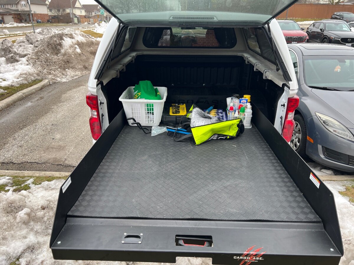

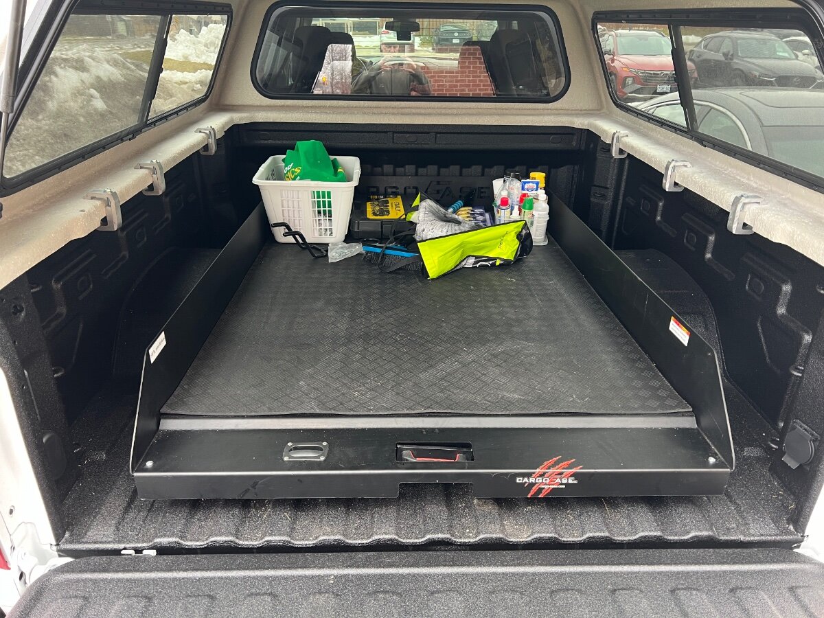

2 hours ago, jd1923 said:
I'm not ever again going to have a truck with a cap, making it near impossible to get to half the stuff in the bed! Did that for years when we had two Labs and was so relieved to remove the cap from the bed. Love our open long bed, so convenient and easy!
Nooo John, that must’ve been in Adam and Eve’s days, these days there are bed slides…..like this one we have, love it 1000%! 😁
