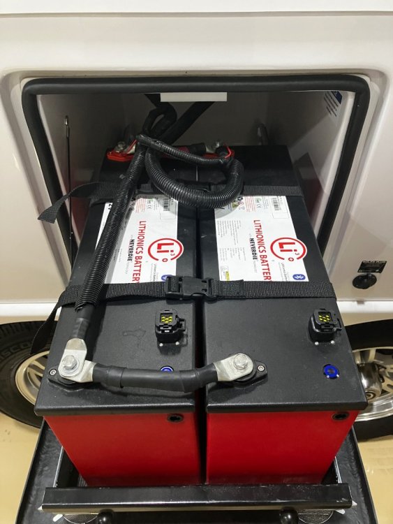

BBL Posted September 4, 2022 Author Share Posted September 4, 2022 (edited) Update since our recent (Second) visit to the Oliver factory. We live less than 2 hours from the Oliver plant. We went back this past Friday to talk and take some more pictures in the showroom. @SeaDawg @John E Davies and others who were talking about the new solar. I learned Oliver WILL have a Smart Shunt on 2023 models! I didn't think it was there because I assumed the Victron display that I briefly saw in the trailer was to replace the ZAMP charge controller display. NOT SO, the Victron Solar Charge controller 100/50 with BT does NOT have a display, you MUST control it from the APP. The Victron display is the BMV 712 Smart Battery Monitor with BT and this display requires the Smart Shunt to provide information to the display and the APP. SO...when you open the APP you will see TWO Victron components, the BMV and the Solar Charge controller. Victron MPPT 100 : 50 with BT BMV-712 BT If something doesn't sound right, let me know. Would love to discuss. Brian Edited September 4, 2022 by Brian and Brandelyne Lewis spelling 1 2 Link to comment Share on other sites More sharing options...

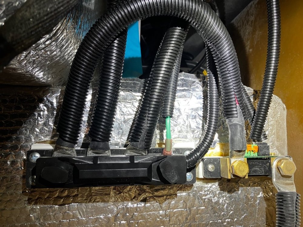

BBL Posted September 5, 2022 Author Share Posted September 5, 2022 16 hours ago, John E Davies said: Brian, did you see where they mounted the smart shunt itself (not that remote display)? Did this reduce the clutter inside the battery box? Did you see any sign of vents inside the cabin for the electronic bays? Which they need 😬 More PICS please! Thanks. John Davies Spokane WA @John E Davies John, There is really very little clutter in the battery box compared to others I have seen. The Shunt seems to be in the basement, not in the battery box itself but I could have been looking at the wrong component. There really wasn't anyone there to discuss the design with and I was told the trailer I was looking at was kind of an experimental "Frankenstein" model and they admitted that no one has actually seen a "Production Representation" of a 2023 yet. Here is what I think is the Shunt but it gives me pause that I see "RED" on the cable and I am under the understanding that all "Grounds" have to go through the Shunt to work properly. Someone tell me what this is: To the point that this may be a "Dumb" shunt, I now see the wires tapped off the center that likely run up to the Victron BMV 712. Here is the current battery box: Brian 2 Link to comment Share on other sites More sharing options...

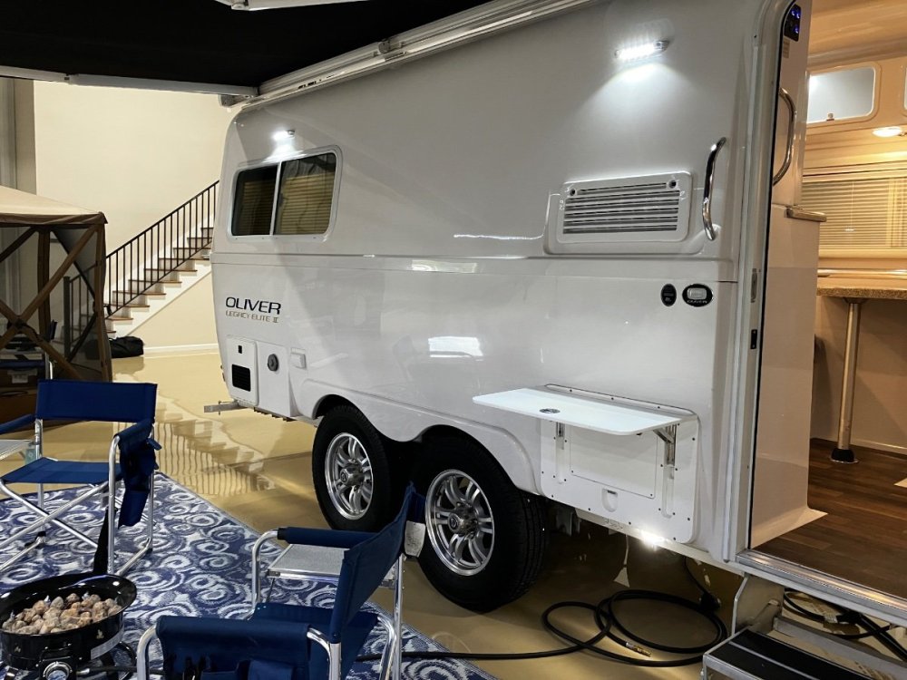

BBL Posted September 5, 2022 Author Share Posted September 5, 2022 This is a picture of the new "Side Table" that was created when the lower fridge vent became obsolete because of the all-electric fridge. They did a great job on this and it is very sturdy. Will make a nice meal-prep or cocktail table. 4 1 Link to comment Share on other sites More sharing options...

Moderator+ ScubaRx Posted September 5, 2022 Moderator+ Share Posted September 5, 2022 2 hours ago, Brian and Brandelyne Lewis said: Well..you might be right about that. I have actually never studied the difference between the "Smart" and "Dumb" shunts with respect to Victron because I always assumed (you know where that gets you) that they only used Smart Shunts. I will look into that and see what I can dig up. Brian The only difference between the smart shunt and the one that comes with the 712 display is the SS is BT enabled. The earlier 700 series monitors did not have BT. With the release of the 712 the SS became redundant for new installations. 3 Steve, Tali and our dog Rocky plus our beloved Storm, Maggie, Lucy and Reacher (all waiting at the Rainbow Bridge) 2008 Legacy Elite I - Outlaw Oliver, Hull #026 | 2014 Legacy Elite II - Outlaw Oliver, Hull #050 | 2022 Silverado High Country 3500HD SRW Diesel 4x4 Link to comment Share on other sites More sharing options...
BBL Posted September 5, 2022 Author Share Posted September 5, 2022 Scoob - that makes perfect sense and I was aware of the differences between the two. My incorrect assumption was, when I saw the 712 with BT I assumed it was BT to the Shunt, not taking readings from the Shunt and sending out info via BT. I actually like the little display as a quick glance reference along with the ability to get the details via BT. Overall, I am pleased with the selection of hardware and the integrations. BL 2 Link to comment Share on other sites More sharing options...
