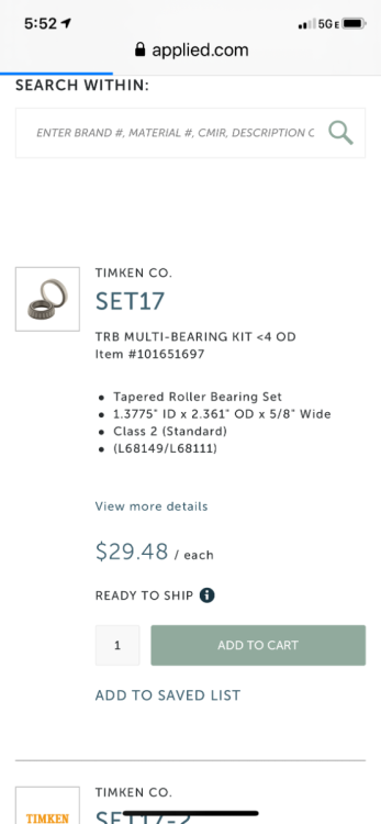

Frank C Posted October 17, 2022 Share Posted October 17, 2022 58 minutes ago, dedroll said: This is bothering me now... I calculated the price for 4 Timken wheel bearing sets from Summit Racing at $75.92 and the price at Motion Industries was $308.28 ?? There are a lot of counterfeit “Timken” bearings out there, especially on Amazon. At that low price I’m not sure I’d even trust the ones from Summit to be genuine Timken bearings. I bought mine through an authorized Timken distributor (Applied Industrial) and it was about $60 per wheel for the two sets needed (inner and outer bearings sets) for each wheel, plus the new seal needed. And I use the WBA bearing app available for smartphones to scan the QR code on the bearing packaging to confirm they are legit. 1 Link to comment Share on other sites More sharing options...
