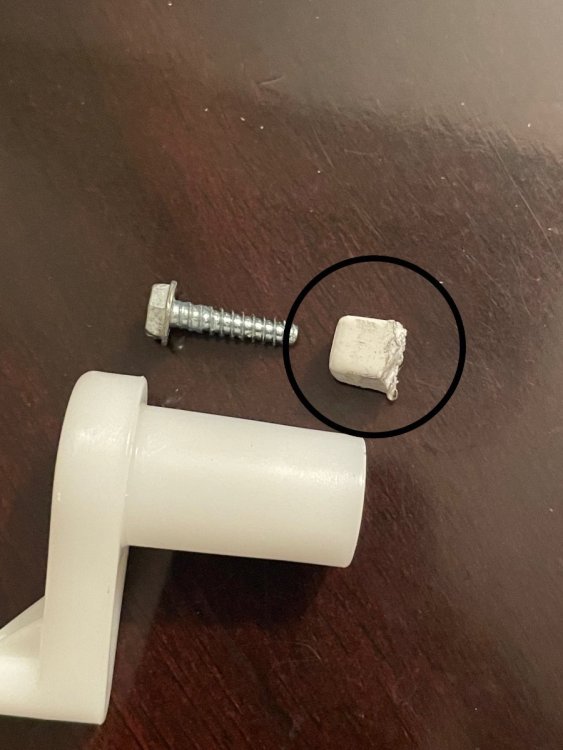

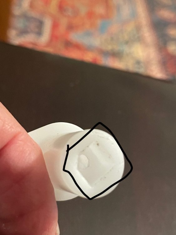

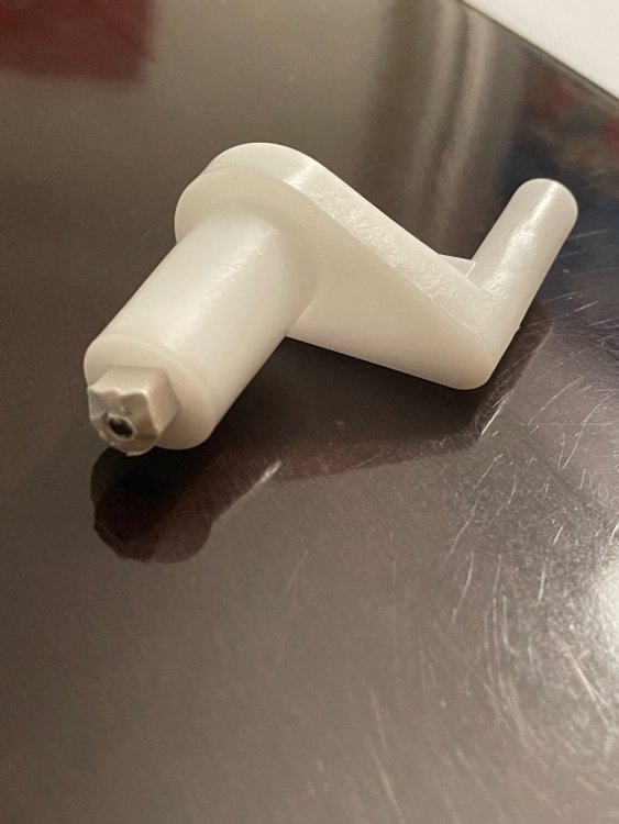

chuckstovall Posted October 21, 2022 Posted October 21, 2022 (edited) Sorry. 🙂 Hull #297. Love this camper. This week on our last trip of the year to Great Sand Dunes Nat'l Park the flush ball valve started to give out and eventually did. Water comes on when pedal is pushed but the ball valve stopped working. After some research today I was looking at the actual pedal to flush ball connection as a likely culprit. But after disassembly, it looks solid. Then I pulled the lever shaft that actually actuates the valve and the end that fits into the valve is worn out (see pic 1). The last pic shows what it is supposed to fit into. I've put in a service ticket. But, I understand that Dometic does not sell individual parts - in fact the manual and schematic don't even list the pedal assembly, much less lever shaft as separate parts. I believe I'll be looking at buying a new toilet (about $220) for want of a small plastic replacement part that Dometic likely has on hand. 😞 One of the YouTube videos I found helpful showed a guy printing a part with a 3D printer. Not to be critical, but the video is way too long, but the 3D part creation might be interesting to some. It's not the part I need but it got me thinking. This YouTube shows disassembly/reassembly of the pedal assembly and I hope the part of spring replacement will be helpful if any of you need to do this job.  So, my questions:  1) Anyone have this little piece that connects the pedal lever to the ball flush valve? (see pics below) First pic shows the actual part (minus whatever has broken or worn away). Second pic shows the hole thru which the part attaches. I tried to mark it up to show the five sides. The third pic shows it installed in it's lever. The fourth pic shows where it 'plugs' into the flush ball valve. 2) If you don't have one (and why the heck would you?), would anyone be willing to take theirs apart and take a photo and maybe even some measurements? (I'm considering the 3D printer aspect.) 3) Other ideas or suggestions? Thanks in advance. Chuck  Edited October 21, 2022 by chuckstovall corrected reference to pictures 2 2

Geronimo John Posted November 2, 2022 Posted November 2, 2022 On 10/20/2022 at 5:25 PM, chuckstovall said: So, my questions:  1) Anyone have this little piece that connects the pedal lever to the ball flush valve? The exact failure occurred to us in Idaho this summer. It is insane that we have to replace a whole toilet for a 50 cent part failure.  I would rather replace the whole unit and never buy another Dometic unit again even if it costs me double! Where is the corporate integrity at Domenica?  GJ  1 1 TV: 2019 F-150 SuperCrew Lariat, 3.5L EcoBoost, 10 Speed Trans, Max Tow, FX-4, Rear Locker    OLLIE: 2018 OE2 Hull 342, Twin Bed.   OLLIE DIY’s: Timken Bearings, BB LiFePO4's, Victron 712 Smart, 350 Amp Master Switch, Houghton 3400, Victron Orion DC - DC, 3000-Watt Renogy Inverter, P.D. 60-amp Converter, Frig Dual Exhaust Fans, Kitchen Drawer Straps. Front Wardrobe Shelves, Snuggle Shelf.  TV DIY’s: 2 5/16" Anderson System, Nitto recon’s, Firestone Rear Air Bags, Bilstein 5100’s, Mud Flaps & Weather Tech all, installed Ham Radio (WH6JPR).  Â

Geronimo John Posted November 2, 2022 Posted November 2, 2022 7 hours ago, Townesw said: TL;DR: Buy the Dometic assembly, get the part you need, sell the rest of the parts. My experience was that Dometic does not sell the part that broke on Chuck's and our toilet.  (Chuck's picture below) For this 50 cent (to make) part not being available, one has to purchase a whole toilet. This was verified by both Dometic and E-trailer.  If anyone has info contrary to this please share it with the team. Thanks, GJ 1 1 TV: 2019 F-150 SuperCrew Lariat, 3.5L EcoBoost, 10 Speed Trans, Max Tow, FX-4, Rear Locker    OLLIE: 2018 OE2 Hull 342, Twin Bed.   OLLIE DIY’s: Timken Bearings, BB LiFePO4's, Victron 712 Smart, 350 Amp Master Switch, Houghton 3400, Victron Orion DC - DC, 3000-Watt Renogy Inverter, P.D. 60-amp Converter, Frig Dual Exhaust Fans, Kitchen Drawer Straps. Front Wardrobe Shelves, Snuggle Shelf.  TV DIY’s: 2 5/16" Anderson System, Nitto recon’s, Firestone Rear Air Bags, Bilstein 5100’s, Mud Flaps & Weather Tech all, installed Ham Radio (WH6JPR).  Â

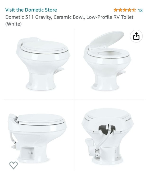

chuckstovall Posted November 7, 2022 Author Posted November 7, 2022 Update: The Dometic 310 Gravity Toilet, White, Standard Height but upgraded to wood, slow close seat was initially priced at $220 on Amazon. Then went up to $295. Late last week it dropped to $150 so I just bit the bulllit and ordered it. If for some reason it's not correct, it's free returns.  I'll add the Beech Lane upgraded valve (see Brian's recommendation above) just because it'll be easier prior to installing the toilet. When I'm done, I should have some toilet parts to sell here!

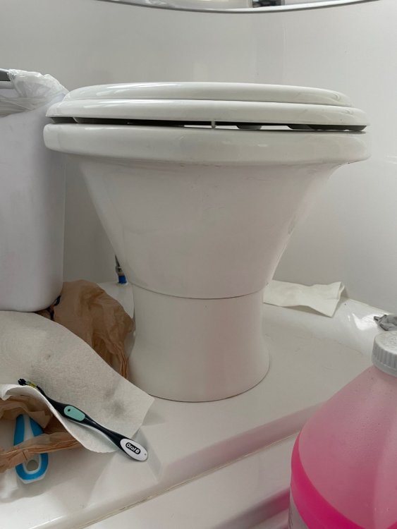

chuckstovall Posted January 9, 2023 Author Posted January 9, 2023 Ain't nuthin' easy! 🙂 I've exhausted every avenue I can think of and am resigned to just ordering another toilet and throw out the perfectly good (except for the broken underengineered connection from pedal shaft to flusher ball) one the came with the Ollie.  I'm ready to order a new 310 which is what the sticker on the OEM toilet says. Went out to measure and verify and found that my toilet is 15 inches from bottom of base to top of the lid (when closed) or 15.5 inches from base to top of porcelain at the back of the hinged lid area.  Dometic's specs for the 310 (standard height) say 18 inches and for the 311 (low-profile) say 13.5 inches. Looking at my pictures of mine (first pic), mine is just between heights. What?? I'll reopen my ticket with Oliver and see what they have to say. (I also note the fluted shape of the bowl on mine is similar to the 310, but very dissimilar to the rounded shape of the 311, but the stand on which the porcelain bowl rests appears much shorter on mine than the 310 and more similar in height to the 311). So confusing.  Anyone have any thots? .
Geronimo John Posted January 9, 2023 Posted January 9, 2023 Chuck: That height tilt got me as well. I'm thinking I'm all "flushed out" on this brand. In the mean time, maybe a few Sears and Roebuck catalogs can be found for foot rests. 😞 Please do advise on what you figure out about this dung home cover.  OLLIE OWNERS: Are there other brands that are maintainable out there we could migrate to? thanks GJ TV: 2019 F-150 SuperCrew Lariat, 3.5L EcoBoost, 10 Speed Trans, Max Tow, FX-4, Rear Locker    OLLIE: 2018 OE2 Hull 342, Twin Bed.   OLLIE DIY’s: Timken Bearings, BB LiFePO4's, Victron 712 Smart, 350 Amp Master Switch, Houghton 3400, Victron Orion DC - DC, 3000-Watt Renogy Inverter, P.D. 60-amp Converter, Frig Dual Exhaust Fans, Kitchen Drawer Straps. Front Wardrobe Shelves, Snuggle Shelf.  TV DIY’s: 2 5/16" Anderson System, Nitto recon’s, Firestone Rear Air Bags, Bilstein 5100’s, Mud Flaps & Weather Tech all, installed Ham Radio (WH6JPR).  Â

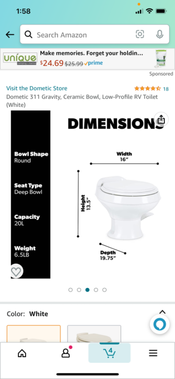

bhncb Posted January 9, 2023 Posted January 9, 2023 It's my understanding that the 310 and 311 use the same porcelain bowl but with different height polymer bases. Here's a picture of the sticker on my 2018 311. It measures 13 inches from floor to top of bowl rim. I'm replacing this with a Thetford Aqua-Magic Style II low profile. It is about an inch shorter however.

chuckstovall Posted January 10, 2023 Author Posted January 10, 2023 4 hours ago, bhncb said: It's my understanding that the 310 and 311 use the same porcelain bowl but with different height polymer bases. Here's a picture of the sticker on my 2018 311. It measures 13 inches from floor to top of bowl rim. I'm replacing this with a Thetford Aqua-Magic Style II low profile. It is about an inch shorter however.  Thanks so much. You got me looking at the Thetford Aqua-Magic Style II low profile. Have you already done the swap? You mentioned good experience with Thetford. Can you elaborate? From what I can see, it should be plug and play?  For us, it could be a great swap, very minimally lower than the current (older model 310 at 15" high) which would be good for my wife. Cheaper (at least from Amazon) but without Free Return and I'm guessing it wouldn't be cheap to send back. Â
