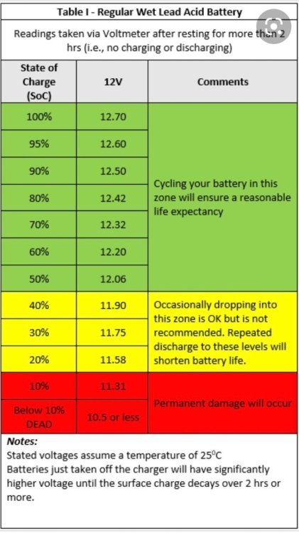

I have the 4 x 12v wet cell battery setup as well.  If you are reading only 11.6 volts on the display, your batteries  are very close to completely dead (see chart), and may be damaged (shortened battery life).  Since you don’t have power available at your storage location, removing the batteries and taking them to your home and putting them on a battery tender is your best option.  I store our Ollie at home and just plug it into house AC power every two weeks or so to keep the batteries from dropping below 12.2v.

Your FLOODED lead acid batteries should be kept in a garage, not your house, they vent hazardous and flammable H2 gas when charging. Maintaining them correctly is a PITA and you need to wear safety goggles when checking the electrolyte specific gravity. You should have a small digital voltmeter to check each battery individually. This chart shows the normal "open cell" (NO load) voltages for a single 6 volt battery.
11.6 volts on your inside meter indicates completely dead batteries (IF there are no other loads running)! Were there any 12 volt items operating when you checked that? If no loads,  they may not be usable, except as core trade-ins. You definitely don't want your discharged batteries to freeze, they will split open and spill acid everywhere

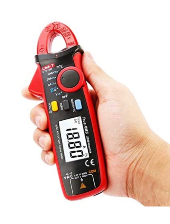

Parasitic (stray) electrical loads are common in RVs. There are certain items that just don’t turn off unless you physically disconnect the batteries (or install a master cutoff switch). If you have solar and park outside, it is not an issue because the batteries remain topped up. If you don’t have solar you should flip off all the circuit breakers except the battery charger. A super super easy way to check for stray current loss is by using a clamp on ammeter. I have one of these and it is excellent for stuff like this, and checking out brake current. In fact, I like mine so much I bought two more to gift to my kids.
YIRU UNI-T UT210 Series True RMS Digital Clamp Meter AC/DC Voltage Tester with ohm, Capacitance Measurement

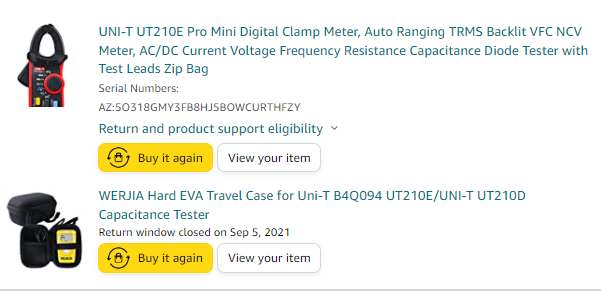

JD: On your recommendation some time ago, I purchased one for my mainland Ollie and Beast.  Then one for here in Hawaii.  Then two for my sons.  Then one for my bother.
In summary now five.  When I purchased, the case was separate.  If getting one be sure to get the case if it is not included.  (See below)
Obviously I highly recommend this tool unit and appreciate your highlighting it here on our forum.
