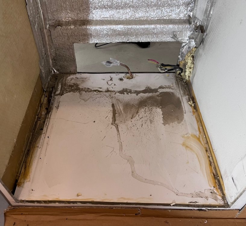

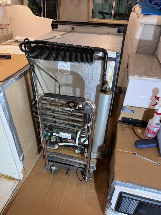

I just finished removing the fridge, it has never been out since 2017 and I am going to install a Fridge Defend kit. Removing it is the only way to access the coils and burner . The early hulls have TINY vent openings. You cannot even remove the burner jet from the outside!!!!  Grrrrr. Double grrr. Rats.
First question, the bay and coils are filthy, being open to the outside is the issue. Is there any simple way to help, short of turning it off and taping plastic across the vents when on dirt roads? (Or installing a compressor fridge.)

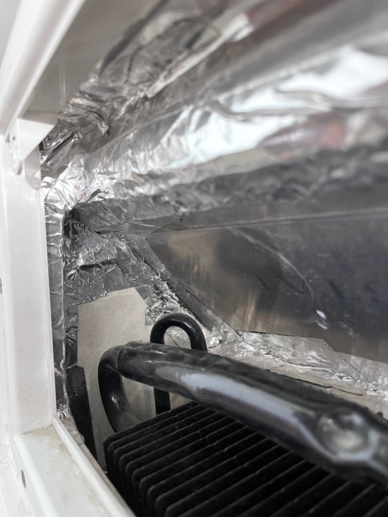

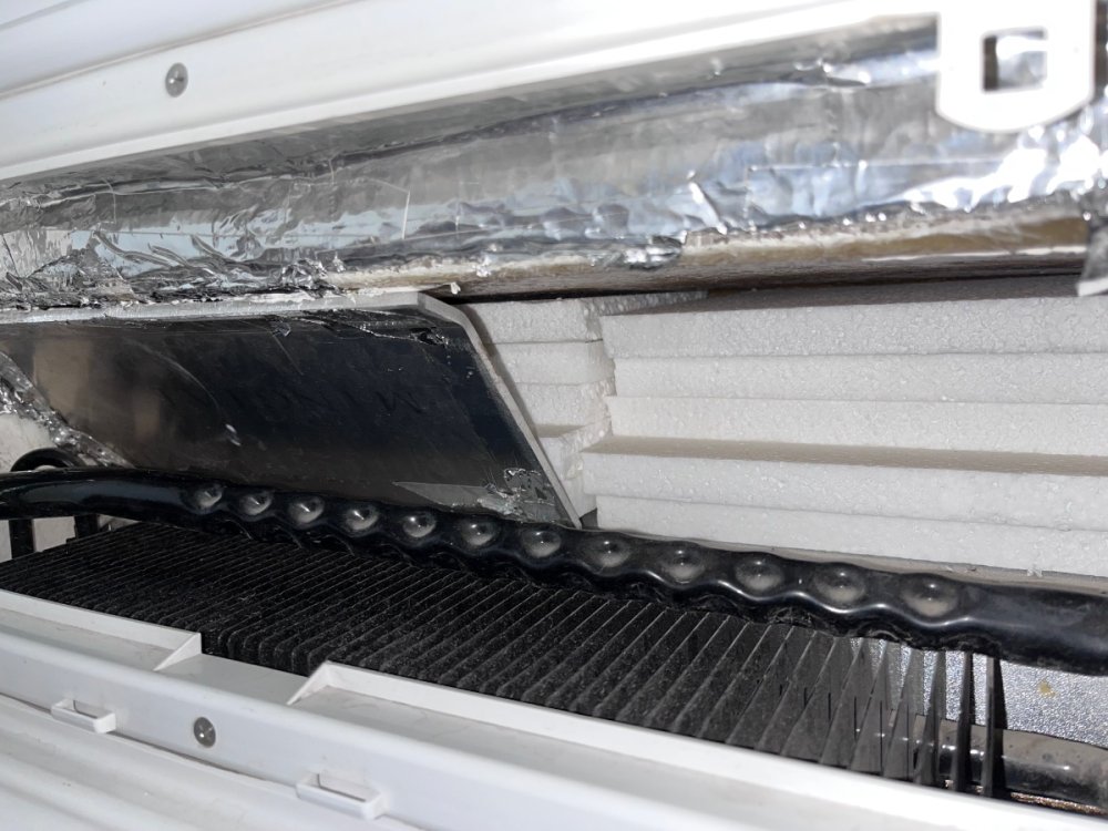

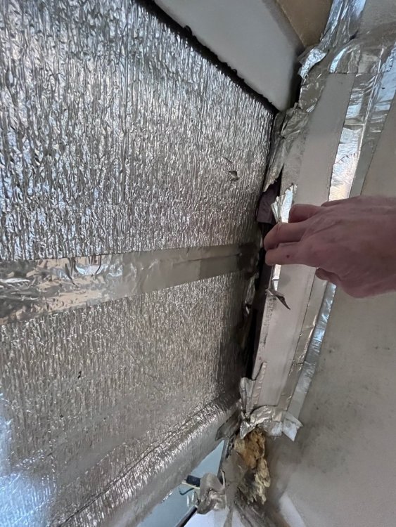

The upper vent is very weird, they used massive 1/8” aluminum plate to direct hot air to the outside, any idea why such big pieces? Maybe to act as a heat sink for the hot exhaust coming up from the burner?
I hate all the HVAC tape that is everywhere, it isn’t sticking well or doing a good job of keeping dust out up top.,., But I don’t know of any better solution. Maybe I will try sealant instead, for the areas that I can reach.

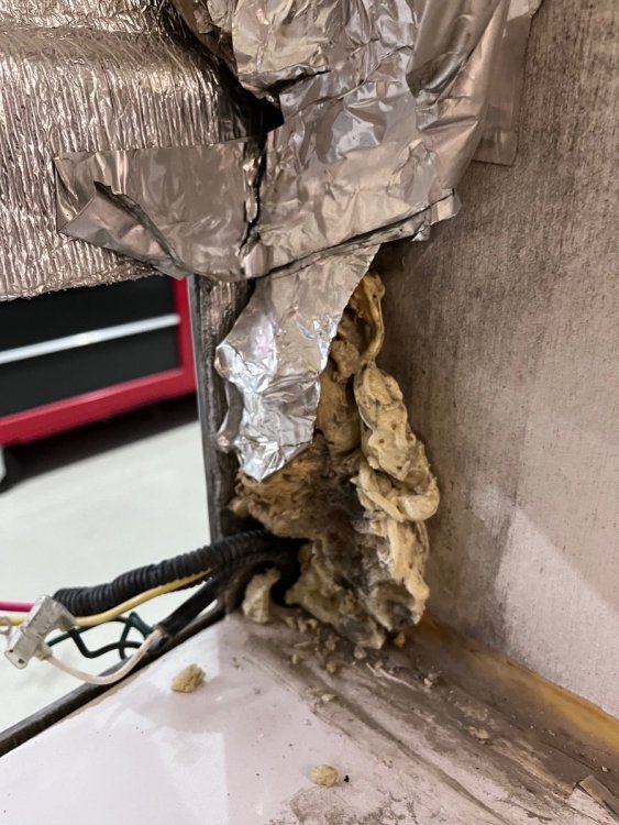

I laughed out loud when I saw the insulation on top, it consists of about a dozen small pieces shoved in and left loose.

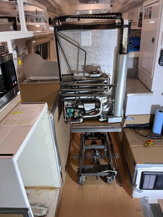

I used my Harbor Freight hydraulic lift to support the fridge, it works great and I can roll it down the floor toward the beds if I need more room.

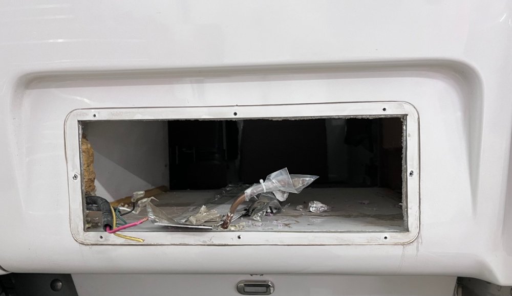

If I could source a bigger vent cover I could enlarge the bottom opening 2” toward the front 1” toward the top… that would provide welcome room for service.
EDIT, I searched really hard and long and can’t find anything suitable, all the “standard” sized vents are too tall for the molded-in flat area. I have submitted a ticket to see what the Mother Ship says.
The existing hole is 18” x 6.25” tall, and there is about 10” from the top lip to the lower curve of the hull.

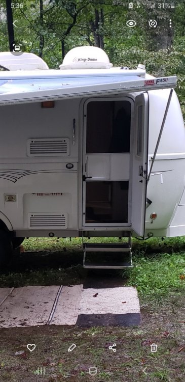

I think our very early vents were possibly smaller
It's def a pita to move that fridge out.
The lower one looks like both of mine, but at least you have lots of room to install a much taller one, if nothing inside intrudes.
Yes, second look, our vents are likely similar, though the hooded indent is shorter on yours.

I expect your "really long and hard" search covered this possibility, so you are likely aware that the 2022 Elite II models include a frame for the lower fridge access hole that is screwed to the hull.  See photo below.  The OD of the "screw-in" frame is 24 1/4" W x 16 3/8" H.  The ID of the resulting hole is 21"W x 13 1/8" H.  Oliver may still have some of those screw-in frames in stock, with corresponding vent covers.
While such a screw-in frame might provide sufficient additional structural integrity to enable you to expand your access hole even further than the "2" toward the front 1" toward the top" you specified above, it appears it is too big to "nicely" fit your 2017 hull contour.  But, I thought it best to provide the photo, with measurements, so you can decide for yourself whether the screw-in frame might enable you to cut your hull above the contour line while still preserving an acceptable fit.

Rivernerd, seeing that pic makes me weep, the access is so great. There is no way that will work well unless I had a big hole cutout and new fiberglass and gelcoat added.
