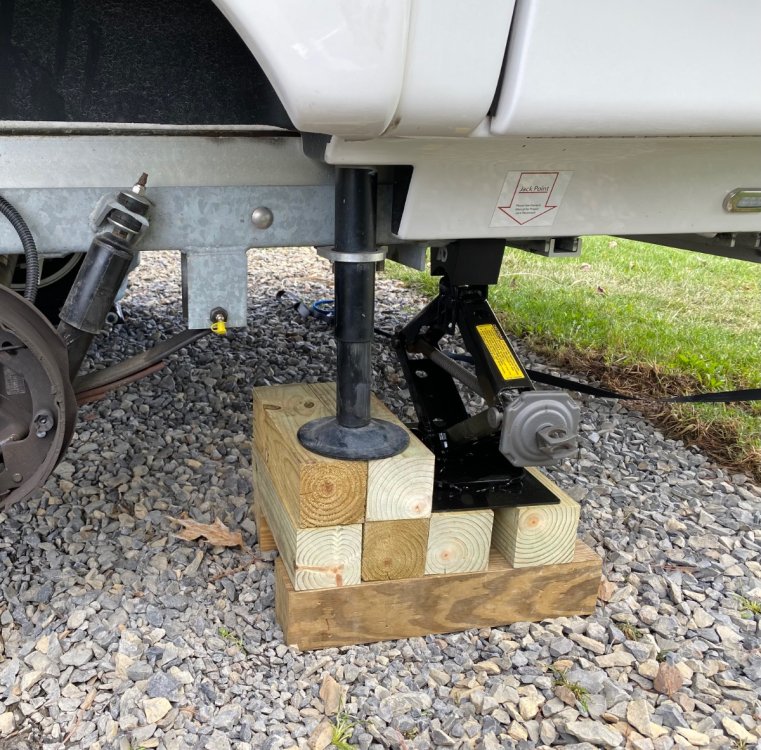

Moderators Mike and Carol Posted February 5, 2023 Moderators Share Posted February 5, 2023 2 hours ago, Frank C said: We’ve seen Oliver owners stranded just from a flat tire because they didn’t have a decent jack to even handle a flat tire on their trailer while on the road. I don’t want to hijack this thread, but…. A flat tire can be changed using the onboard jack. I have raised my trailer several times at Discount TIre for tire changes and balancing and while on the road when a grease cap came off. Oliver doesn’t recommended it anymore, but it was a selling point when I bought and picked up my trailer. Some even use the onboard jack to level the trailer with the wheels off the ground - not something I would ever do. But, for a temporary tire change on the side of the road I certainly would. Now, back to F150s and sudden loss of power. Mike 6 Texas Hill Country | 2016 Elite II #135 | 2020 Ram 2500 6.7L Link to comment Share on other sites More sharing options...
Frank C Posted February 5, 2023 Share Posted February 5, 2023 9 hours ago, Mike and Carol said: I don’t want to hijack this thread, but…. A flat tire can be changed using the onboard jack. I have raised my trailer several times at Discount TIre for tire changes and balancing and while on the road when a grease cap came off. Oliver doesn’t recommended it anymore, but it was a selling point when I bought and picked up my trailer. Some even use the onboard jack to level the trailer with the wheels off the ground - not something I would ever do. But, for a temporary tire change on the side of the road I certainly would. Now, back to F150s and sudden loss of power. Mike After seeing how tiny the welds are on the rear jack mounting brackets, I don’t trust them for anything other than leveling the trailer at a campsite. I know they are rated for 3,000 lbs each but I still prefer to use a very large heavy duty scissor jack (rated for 3 tons) to raise the trailer for tire and bearing work when I need the trailer completely off the ground. I do use the stabilizer as a backup. Sorry for hijacking the thread again. 🙂 5 Link to comment Share on other sites More sharing options...

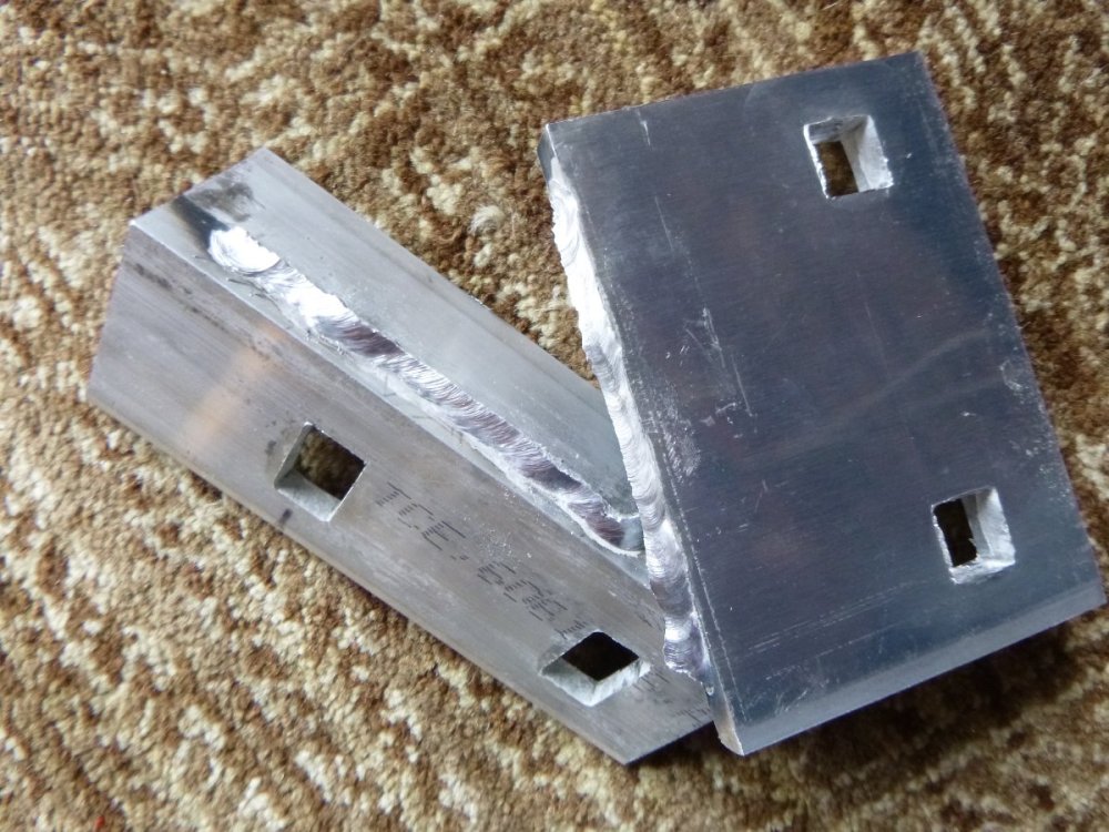

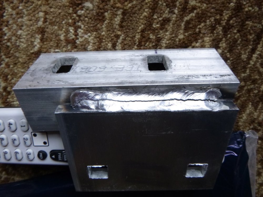

Moderators topgun2 Posted February 5, 2023 Moderators Share Posted February 5, 2023 55 minutes ago, Frank C said: After seeing how tiny the welds are on the rear jack mounting brackets, Frank - Could you post a picture of those welds? There was a time when two steel plates were welded together forming an "L" bracket. Unfortunately, there apparently were times when only "spot welds" were performed and the full welds were never completed on those brackets. If you suspect that you have any of these brackets you should take a picture of them and send it to Service. Bill 7 2023 Ford F150 Lariat 3.5EB FX4 Max Towing, Max Payload, 2016 Oliver Elite II - Hull #117 "Twist" Near Asheville, NC Link to comment Share on other sites More sharing options...
Rivernerd Posted February 8, 2023 Share Posted February 8, 2023 On 2/5/2023 at 6:51 AM, topgun2 said: Could you post a picture of those welds? I would also like to see a photo of those welds, so I can compare it to what I have on our Hull #1291. 3 Hull #1291 Central Idaho 2022 Elite II Tow Vehicle: 2019 Tundra Double Cab 4x4, 5.7L with tow package Link to comment Share on other sites More sharing options...

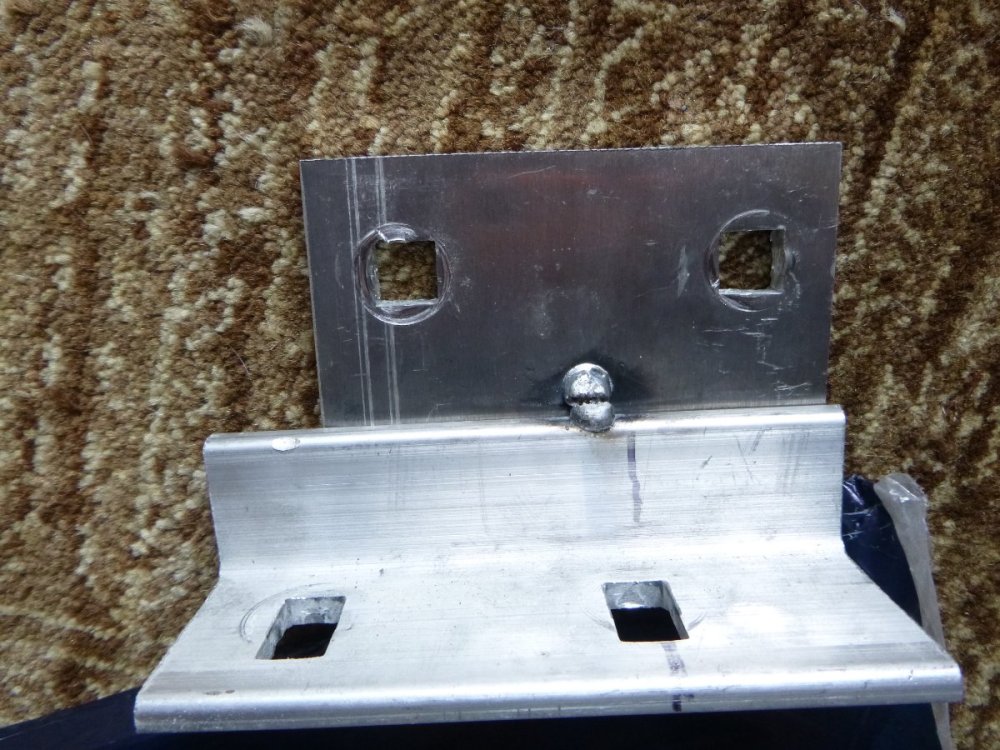

Moderators topgun2 Posted February 8, 2023 Moderators Share Posted February 8, 2023 1 hour ago, Rivernerd said: I would also like to see a photo of those welds, so I can compare it to what I have on our Hull #1291. Here are a couple of pictures of the brackets in question and the "spot" welds that obviously failed. Note that I do not believe any "recent" Oliver has this type of bracket. And, I'd still like to see pictures of the one(s) mentioned above that broke. Bill p.s. sorry for the thread hijack. If this goes much further I'll split this "bracket" portion off. 4 2 2023 Ford F150 Lariat 3.5EB FX4 Max Towing, Max Payload, 2016 Oliver Elite II - Hull #117 "Twist" Near Asheville, NC Link to comment Share on other sites More sharing options...

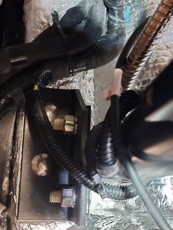

Rivernerd Posted February 9, 2023 Share Posted February 9, 2023 Wow! That is very different from the brackets installed in our Hull #1291. Ours are steel, not aluminum, and appear to me to be robotically welded angle "iron" (steel). See photo below. Given the significance of the difference, and the impact on jack stability, maybe this last part should be broken off into its own thread. Maybe "Aluminum vs. Steel Jack Brackets"? 4 Hull #1291 Central Idaho 2022 Elite II Tow Vehicle: 2019 Tundra Double Cab 4x4, 5.7L with tow package Link to comment Share on other sites More sharing options...
Moderators topgun2 Posted February 9, 2023 Moderators Share Posted February 9, 2023 2 hours ago, Rivernerd said: Maybe "Aluminum vs. Steel Jack Brackets"? I don't exactly know when but Oliver stopped using the aluminum ones within a year of so (2018?) after the photos above. 2 2023 Ford F150 Lariat 3.5EB FX4 Max Towing, Max Payload, 2016 Oliver Elite II - Hull #117 "Twist" Near Asheville, NC Link to comment Share on other sites More sharing options...

Moderators topgun2 Posted February 9, 2023 Moderators Share Posted February 9, 2023 Everyone - please note. I have never heard of any of the aluminum brackets failing as long as they were welded properly in the first place. The issue with the bracket in the photos above is that while there was a "spot" weld completed on the one side of the bracket, the finish weld that should have gone across the entire length of the bracket on that side - as it did on the reverse side - was never completed. And that is the reason the bracket failed. Those with aluminum brackets that are welded on both sides of the bracket should experience no issues. Recalls and/or Service bulletins are only issued if there is a known problem that affects a number of trailers - not a one off. Bill 5 2023 Ford F150 Lariat 3.5EB FX4 Max Towing, Max Payload, 2016 Oliver Elite II - Hull #117 "Twist" Near Asheville, NC Link to comment Share on other sites More sharing options...
John E Davies Posted February 10, 2023 Share Posted February 10, 2023 3 hours ago, topgun2 said: Those with aluminum brackets that are welded on both sides of the bracket should experience no issues. Recalls and/or Service bulletins are only issued if there is a known problem that affects a number of trailers - not a one off. All well, and good, but I believe that you cannot inspect the hidden side of the brackets without physically removing them, so additional hulls could have defective ones. So a Tech Bulletin is definitely needed to verify that they are correctly built. If those bottom welds are visible with a borescope, or a light and a mirror, it would take minimal down time. John Davies Spokane WA 3 SOLD 07/23 "Mouse": 2017 Legacy Elite II Two Beds, Hull Number 218, See my HOW TO threads: Tow Vehicle: 2013 Land Cruiser 200, 32” LT tires, airbags, Safari snorkel, Maggiolina Grand Tour 360 Carbon RTT. Link to comment Share on other sites More sharing options...

Moderators topgun2 Posted February 10, 2023 Moderators Share Posted February 10, 2023 10 hours ago, Geronimo John said: What's the definition of Recent Owners? I do not specifically know - however, as I said above, I believe that Oliver changed from aluminum to steel brackets in 2018 or so. Certainly, it is easy enough to inspect any particular trailer to ascertain if that trailer has steel of aluminum brackets. 11 hours ago, John E Davies said: All well, and good, but I believe that you cannot inspect the hidden side of the brackets without physically removing them, so additional hulls could have defective ones. So a Tech Bulletin is definitely needed to verify that they are correctly built. If those bottom welds are visible with a borescope, or a light and a mirror, it would take minimal down time. All I can do is answer this question relative to the brackets that are on my Oliver. For BOTH rear brackets it is easy to see that they are aluminum AND for BOTH brackets it is easy to see that the welds on both sides of the bracket extends to close to the ends of the bracket. No borescope or light or mirror is needed. 10 hours ago, Rivernerd said: I expect they would send you the steel angle iron jack brackets at no cost. I can tell you that this is exactly what Oliver Service did for this owner. I can also tell you that I was told that Oliver Service inspected all "completed" brackets in the parts bins and all brackets on any trailer on the production line with no additional brackets being found that were not welded properly. 10 hours ago, Rivernerd said: If I owned an older Oliver, I would make it a priority to remove the hatch covers under both the curb side and street side beds to enable examination of the welds on the jack brackets. Indeed, in reading this thread, I'd certainly take a look at my rear brackets - just to make sure - "trust but verify" (The phrase became internationally known in English after Suzanne Massie, an American scholar, taught it to Ronald Reagan, then president of the United States, the latter of whom used it on several occasions in the context of nuclear disarmament discussions with the Soviet Union.) This is particularly true given that it appears that there just may have been two instances (that we know of) that had failures of this nature - even though no pictures of the bracket failure that started this thread have been given. 4 2023 Ford F150 Lariat 3.5EB FX4 Max Towing, Max Payload, 2016 Oliver Elite II - Hull #117 "Twist" Near Asheville, NC Link to comment Share on other sites More sharing options...
Frank C Posted February 10, 2023 Share Posted February 10, 2023 On 2/8/2023 at 12:49 PM, topgun2 said: And, I'd still like to see pictures of the one(s) mentioned above that broke. Bill I never said the welds broke on my jack mounts. I just said I didn’t trust them for lifting the trailer completely because they are small welds and I don’t trust them for lifting ~ 1/2 the trailer weight when I’m working on the trailer. Mine have the steel angle channel brackets. Next time I have the access hatches open I’ll take a picture. 3 Link to comment Share on other sites More sharing options...
Moderators topgun2 Posted February 10, 2023 Moderators Share Posted February 10, 2023 9 minutes ago, Frank C said: I never said the welds broke on my jack mounts. That's great to hear! So, now we are back down to a single instance - that I know of. Bill 4 2023 Ford F150 Lariat 3.5EB FX4 Max Towing, Max Payload, 2016 Oliver Elite II - Hull #117 "Twist" Near Asheville, NC Link to comment Share on other sites More sharing options...
