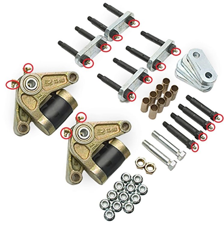

There was a thread on Zerks I was following, with some discussion on Zerk Count, which I believe ended up being '16', at least for the LE2.  While crawling around underneath, I was able to locate 12.  So I was looking for a diagram to show locations, but I believe a picture provided by John Davies, is a good substitute for a diagram.
I just circled them in red on JD's picture, but did not number them, and I am now seeing 16.
I will go back to the Quonset to verify, but is this the number and location?

Correct, there are the 16 that you have circled.  The 4 (2 each) on the two EZflex couplers are very well hidden and hard to get to.  Removing the tires makes it a lot easier to reach those ones.
FC - Thanks for the confirmation.
We will be removing tires to do the bearing replacement (Timken's) & greasing.  While off, I will do a few more tasks in that area.
