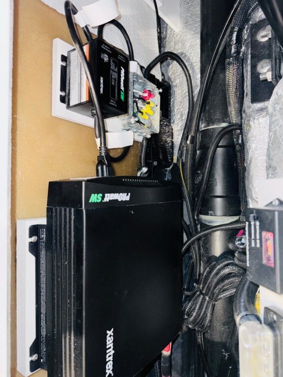

I am thinking about swapping out Xantrex 2000 for a Victron Multiplus II 3000 and installing upgraded Lithium batteries. The part that I need help with is the wiring from the PD 4000 distribution panel and bypassing or disconnecting the charger.  Still need converter portion for shore 110v?
MP2 for Inverter DC to AC, power switch (Shore to DC, DC to Shore) and charging.
Does the OEM wiring from the junction box on Xantrex end just go into the AC IN and AC OUT on the Victron Multiplus? Or do you need to run the shore power out of EMS to Multiplus AC IN and then back to distribution panel.
Do you simply disconnect charger?
If you run new longer feed from the EMS to MP 2 AC IN then can you use the AC OUT back to the PD 4000? OR does the EMS to MP2 go back to shore power in the same AC in on back of PD 4000.
Any clarification on these questions or pics would be greatly appreciated. Just trying to figure it all out before hiring someone or diving in myself. I, also, just want to understand how it works.
Thanks in advance for any feedback.
Mike
IMG_7210.thumb.jpeg.164a71469dcb6f174ddbb19477a8c179.jpegIMG_7209.thumb.jpeg.889327eba96b9f048913789167fe56bd.jpeg
I my xantrex had dc charger built in. I rewired my total dc side though did not like wiring from factory. You should be able to remove the dc xantrex charger. Yours is different layout would have to follow your wires. Never touched ac side at all except hooked up proper breaker to proper spot. AC on fridge and ac on air conditioning were wired backwards from factory. Found that out when tried running AC off my batteries alone. Rewired dc side with victron shunt and lynx distribution on fender well. Very tight

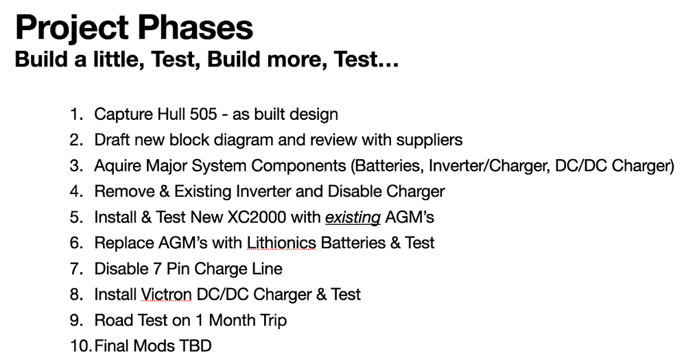

Try reading my upgrade article here...
In it I describe all the steps to an upgrade -
Also - check my personal message I sent today.
Full Article in our Blog Here:
https://4-ever-hitched.com/ggs-blog/f/lithium-battery-upgrade?blogcategory=Electrical+Upgrades
Slides of the upgrade & Pix in this PDF:
12V Layout.pdf
Craig - Hull 505 - (Galway Girl)

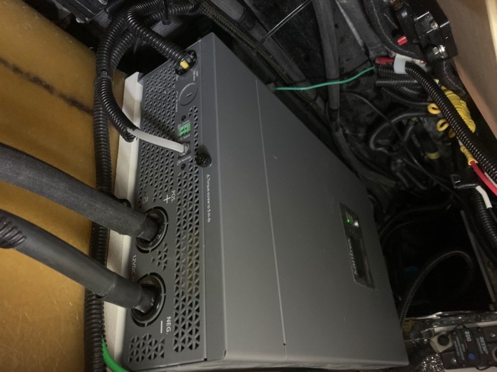

Finally finished the Victron system retrofit.  Everything seems to be working well and playing nicely with the other components.  Haven't modified the truck yet with the DC cables to power the DC-DC charger, but no reason to think it won't work properly.  Still a little programming to do to get all the settings and configuration correct. The Victron stuff is top notch and would be a good option for a premium package from Oliver.
2020 Elite II Hull #628 "Pearl" - Houghton Heat Pump, Victron MP2, SmartSolar, Orion, Cerbo, Lynx distributor and shunt
