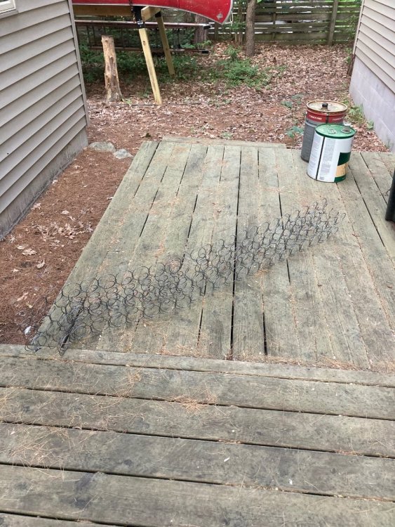

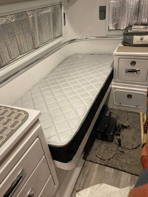

I decided I would try to modify a standard twin (39x75”) to fit the E2, including the radius corner. I have a spare twin mattress at home but it has top and bottom perimeter 3/16” wire which I didn't want to deal with splicing back together. So, instead I found a new innerspring twin and brought it home. After using my Ollie cushion to trace the new shape onto the new mattress I cut into the mattress and using wire cutters, snipped away two rows of coils plus a single coil on the corner to accommodate the radius, stitched the batting and cover back together and here is the result.   So far I am liking the result. It is very firm and is rigid and light. Will sleep on it in a few nights to see if it passes the test
First pic is of new mattress. Second pic is the rows of coils I removed

Not sure how much lighter the new mattress is over the standard cushion and air mattress combination it replaces.  Probably close to a wash.  However, it is likely much lighter than its peer latex mattress.  Slept on it last night and it is nice and firm.  A good night sleep if you like that sort of thing.  It was simple to make the bed.  Lifting the mattress as a single unit, without flopping around and not heavy at all.  I like it and best of all it was less than $200 for the new mattress.
