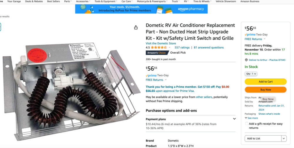

MAX Burner Posted November 8, 2023 Share Posted November 8, 2023 11 hours ago, Steph and Dud B said: No heat strip in our 2022 Dometic A/C. Hull 1150. Wish there was. FYI: We added a heat strip in our previous camper's non-ducted Coleman Mach 8 AC unit - easy install and we loved it. Dometic Penguin II has a heat strip kit also (from Amazon) that may work for your unit - best to double check with Dometic or OTT Factory to be sure. Definitely worth examining, IMO. Our Hull #226 has a heat strip installed before we bought it and came in very handy last weekend with morning temps in the Hi 30's - Lo 40F's, FYI. We control the Dometic with a Breeze Air Touch Screen thermostat - it's 100% compatible with the furnace and AC unit, we've got it set to cycle between the two for ease of maintaining internal temps where we like it... Cheers! 1 2 Art, Diane, Magnus & Oscar (double-Aaarrf!) 2022 TUNDRA 2017 LE II; Hull #226 "Casablanca" HAM call-sign: W0ABX Link to comment Share on other sites More sharing options...
Moderators SeaDawg Posted November 9, 2023 Moderators Share Posted November 9, 2023 Our old dometic had a heat strip. Since the penguin ii can be purchased with a heat strip, I'd be surprised if you couldn't add one, as MAX Burner suggested. I'd open a service ticket, or check with dometic. 2 2008 Ram 1500 4 × 4 2008 Oliver Elite, Hull #12 Florida and Western North Carolina, or wherever the truck goes.... 400 watts solar. DC compressor fridge. No inverter. 2 x 105 ah agm batteries . Life is good. Link to comment Share on other sites More sharing options...
