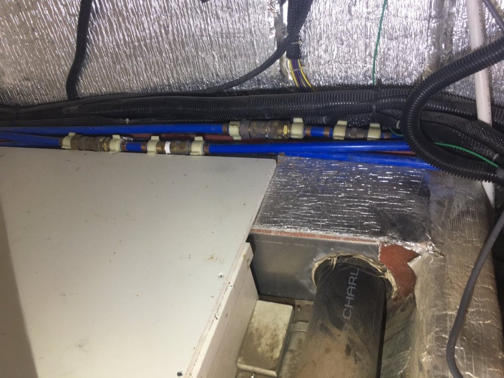

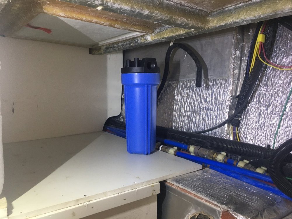

I'll present more as I build it. Though right now, I have a question, for those in the know! Please check out the second picture. Why so many connectors on the internal plumbing? I see a connector AND another connector, perhaps with a built-in pressure restrictor, or backflow preventor? Also wondering why I see a third Pex line without any connectors?
Please advise, before I tear all of this apart! It's just like Oliver to install devices that may need maintenance, so deep and out of reach!

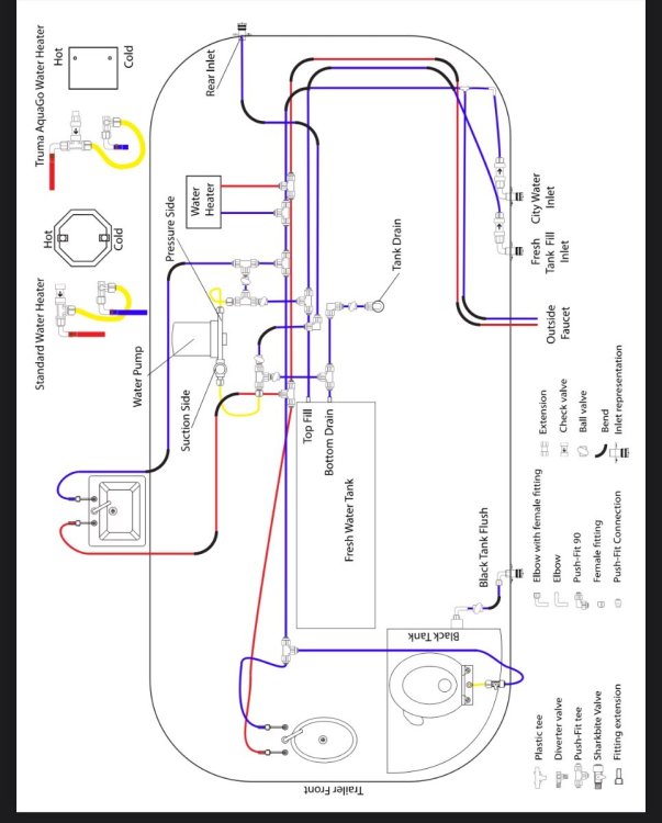

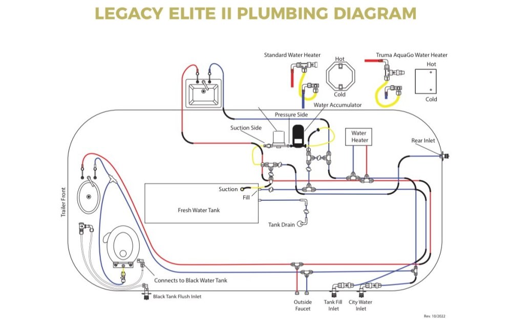

Ok if it will help, here's the plumbing diagram of a 2017, not sure if it’s the same as your 2016.
This is cool.  Where can I find one for a 2023 LE2?

Here you go, in the 2023 manual, there’s more good stuff here
Thanks Rich! Your diagram shows me the third line is for the outdoor shower. This is very helpful. Anybody know why there are so many fittings on the incoming water lines? Looks like an inline pressure regulator but would like confirmation, for those who can identify the inline parts. Thanks
4 hours ago, jd1923 said:
...Looks like an inline pressure regulator but would like confirmation, for those who can identify the inline parts. Thanks
Those back-flow preventers (Allows water to flow only in one direction - note the tiny arrow on each of them in the plumbing graphic).
Thanks Steve, I thought backflow or pressure regulator. Yes, the drawing shows it on the hose bib vs. the rear of the trailer. Wonder why do they need the second brass connector on each line? Are there both backflow and pressure regulator in-line?

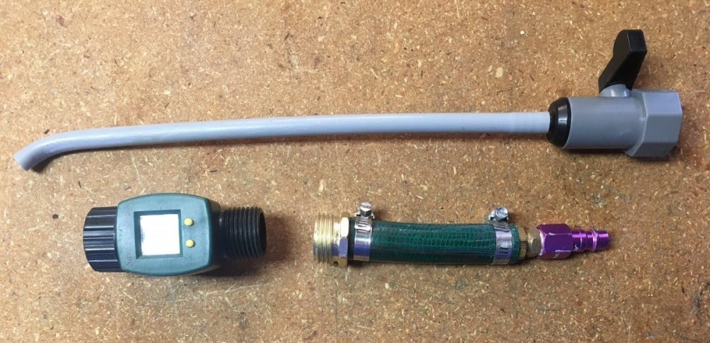

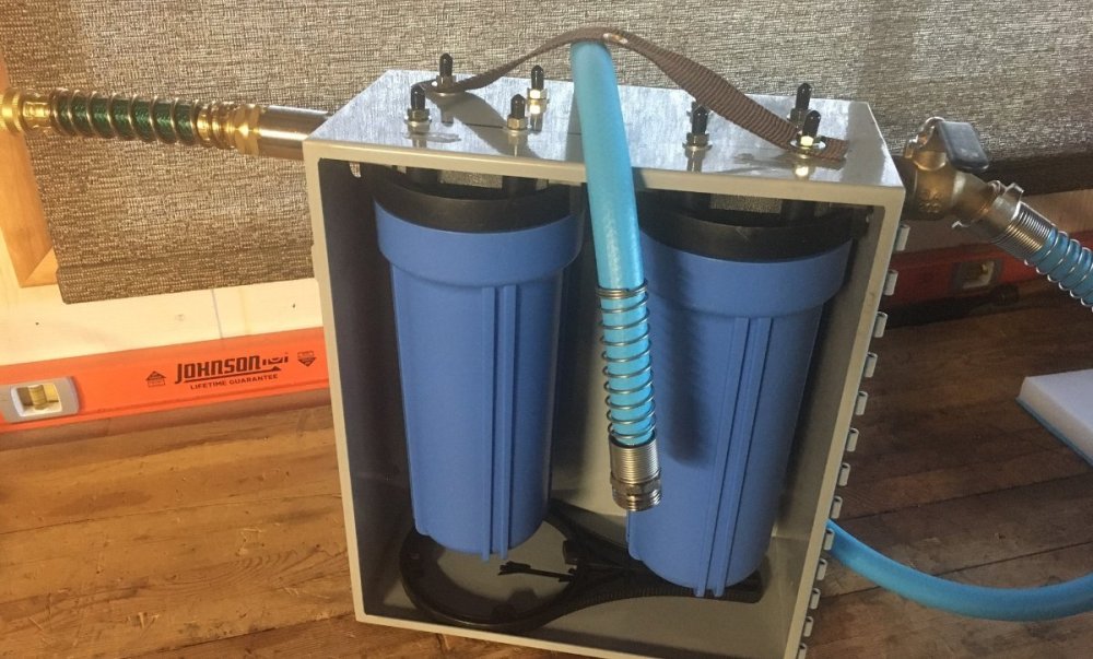

I decided the external filter made more sense. This way I can fill the 35-gal tank on my truck bed using it also, or when boondocking fill via the rear winterizing port. Mine looks like this -
Even though I built this for just over $200 (all parts and first filter set) and ClearSource sells their unit for $400 plus tax, I would never suggest you go this route. It's way easier to buy their pretty well-built unit. It is extremely difficult to drill the 8 holes for the top-mounts without a template. Same for the side openings, to be centered at right depth! Just as hard to find a box, plastic or metal, that is 14x12x6" and not larger or smaller.
Water will come in from the left. I had to add the 4" hose since my first female hose connection does not turn. I have a 4 FT hose on the right, that will stay on the filter and connect to the Oliver. I purchased a 10 FT hose for the connection and then of course we have a 25' and 50' hose when needed. I wasn't thinking of a faucet at first but found this one in a plumbing parts drawer and it's perfect. With this, you can run on City water when available, close the valve and switch the hose to the Fresh Tank inlet to bring some with you for the next stop (and refill my truck mounted tank). The junction box came with a cover. You can see the hinge for it, but I'm thinking it just adds unnecessary weight, and filled with water this will be very heavy. Waited long for some of these parts, and it's done!

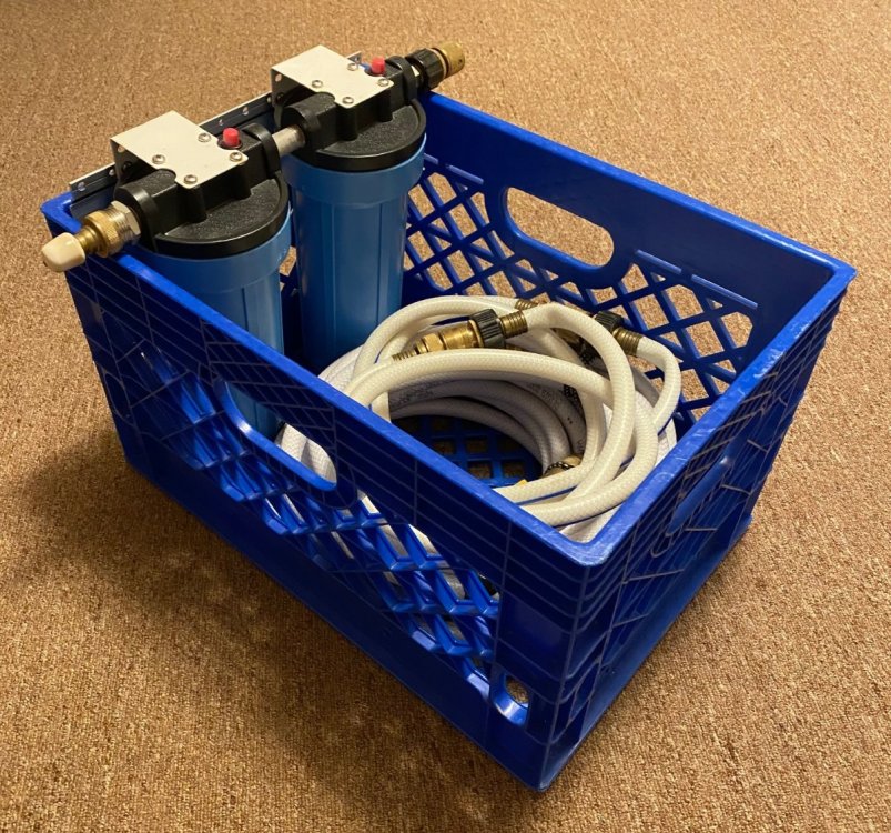

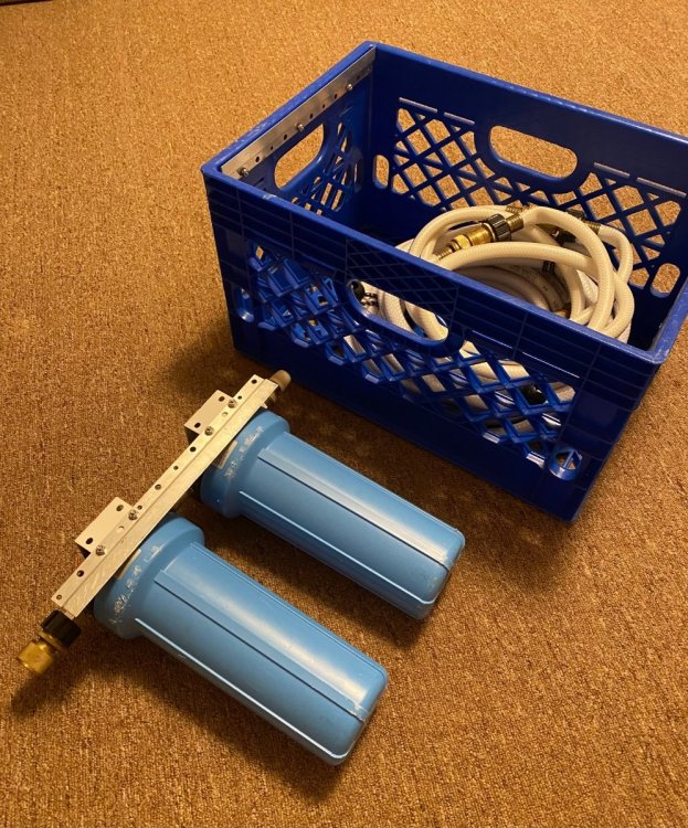

I built a similar 2 stage filter system but mounted it in a standard 6 gallon milk crate.  All hoses, regulator and fittings store in the crate and the whole thing slides easily into the basement storage area for travel.  The filters are mounted using Camco filter mounts attached to aluminum “Z” hanger picture hanging brackets (one bracket on the filters and one bracket screwed to the milk crate) so the filter assembly lifts out to do filter changes.  Quick connect fittings on everything so setup at the campground is quick.
