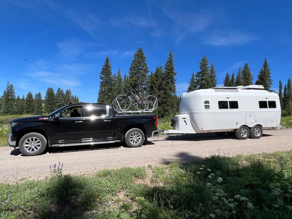

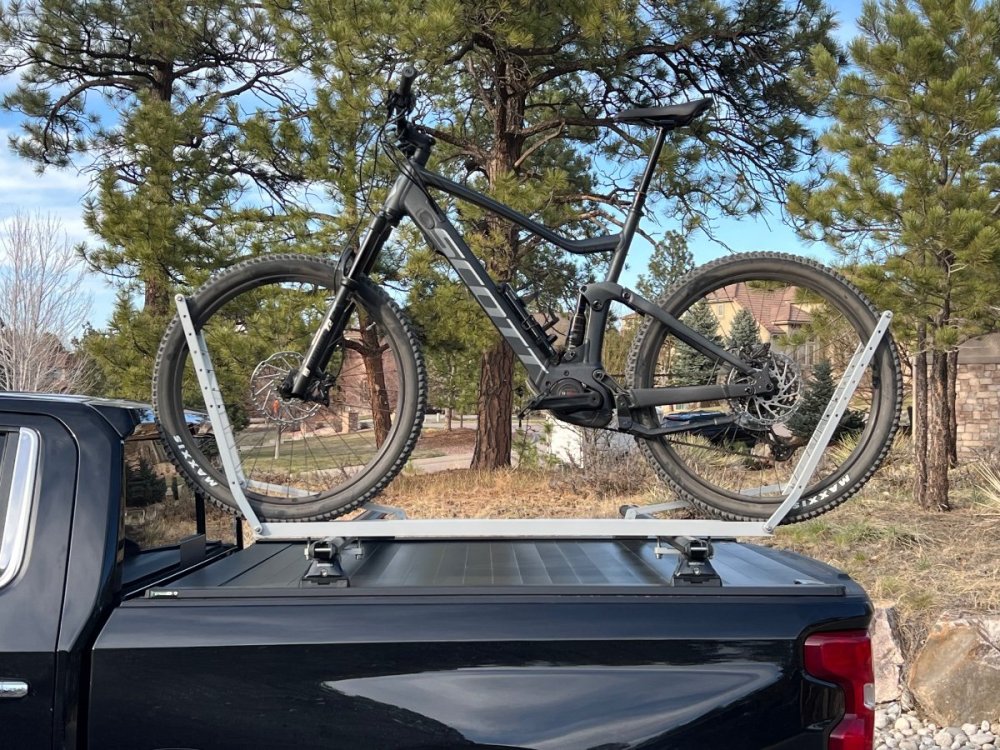

I have the Retrax tonneau cover with the T-track sides.  This allows install of Yakima crossbars.  On the Yakima HD crossbars are two 1Up bike carriers.  These are rated for E-bikes.  The bike in the photo is my size XL E-MTB with 29er size wheels.  This setup has worked well and is surprisingly stable for my beast of a bike.  It’s 50lbs but I remove the battery to be under 40lbs.
For me this setup works great.  I am able to hoist it up on to the rack as I’m 6ft5in tall with good shoulder strength.  It would be tough for someone smaller and likely would need something to step up on.
