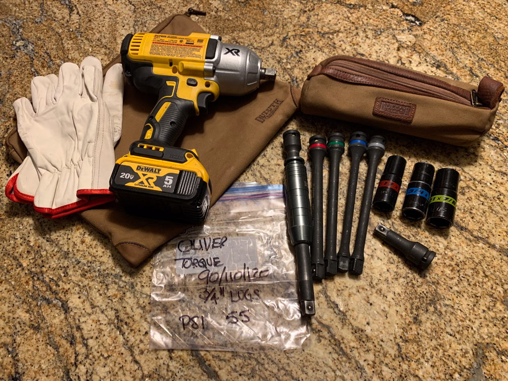

3 hours ago, Tom and Doreen said:
You need one of those!  I had to change a tire in Yellowstone and I was glad to have mine! Mine is the 1/2 inch.
This 3/4" impact has an insane amount of torque, at "1900 ft-lbs of breakaway torque." and you would need the 3/4" to 1/2" reducer most of the time to turn nuts and bolts 1" or less which includes TT and TV lug-nuts.
This 1/2" model would be better for everyday use. A little more expensive, but smaller, 1.5 lbs. lighter and breakaway torque spec'd at 1750 lb-ft. Still a beast!
https://www.homedepot.com/p/DEWALT-20V-1-2-in-High-Torque-Impact-Wrench-Tool-Only-DCF961B/328393371
Or you could save $38 and go another 1.25 lbs. lighter and go with this very capable model with breakaway torque spec'd at 1400 lb-ft.
https://www.homedepot.com/p/DEWALT-20V-MAX-Cordless-1-2-in-Impact-Wrench-Tool-Only-DCF900B/317991357
Either model would be preferred by most of us vs. the 3/4" beast!
I have a 3/4" to 1/2" reducer for when I need sockets >1" like the 1 1/4" socket shown above required for the bearing press. The 3/4" breaker bar shown removes wheel lug-nuts easily or just put the weight of your foot on it to get it started! 🤣
However, not all 1/2" models have the required torque. Check the torque specs. I purchased one years ago, when they were not as strong as some today. It could pull lug-nuts off 12mm or 1/2" studs torqued to 120 lb-ft but it would not budge lug-nuts on a 2500 series truck with 14mm or 9/16" studs torqued to 140-150 lb-ft. I returned it after it failed to loosen a lug on my Dodge Ram. Ever since I've used my pneumatic 1/2" impact in the workshop and work to keep our vehicles well maintained so not to breakdown on the road, having hand tools for this rare case! I work on the TT and TV too much at home and thankfully we did over 50 days of travel in the last 3 months and all my tools stayed in the bottom of the TV toolbox! 😂
I also have the 1/2” model, plenty of torque for both the Oliver and TV needs. And yes, used on many occasions roadside and for general maintenance. I also carry respective torque limiting extension bars and impact flip sockets, as well as a regular torque wrench and speed collar impact extension. Smaller bag with accessories and DeWalt stowed in the larger Duluth bag. A battery charger is carried separately in like manner. Note the quick reference ZipLok bag with specs for the Oliver.

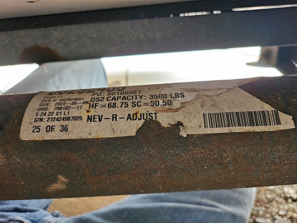

So...does D52 mean a 5200 lb axle?

I contact Alcan to upgrade/replace my Oliver springs. They replied and asked do I want to also upgrade my axles to 5200 lbs. Why would/should  I do that?

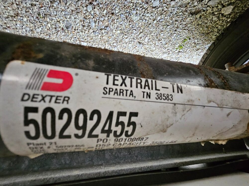

You have the 5200 on your 2022. It is on your axel sticker
D52 is the 5200 axel, but rated 3500 due to the 4-leaf springs
 This is the sticker you should see
Yes, as our friend @John Dorrer stated you already have the D52 axles.
When the label states D52, you have the 5200 LB axles. Reason it states 3500 LBS is the factory build plan called for 3500 LB leaf springs.
Just send Alcan your axle label picture and they will know your axles are A+ and with the Alcan leaf spring upgrade you’re good to go. Lucky you! 🤣

Alcan now agrees that I 5200 lb axles the same as a couple of you also stated so.  Thanks.
A follow-up question. Alcan points out based on my axle label states that I have "nev-r-adjust" Dexter axle NOT "nev-r-lube" Dexter axles as the 2022 Oliver Legacy Elite II Owners Manual state are on the 2022 trailers. Is one "better" than the other? Should I be concerned that my 2022 Legacy Elite II does not have the "nev-r-lube" axle as the Owners Manual states?
Does the question of "nev-r-adjust" vs "nev-r-lube" have any bearing on my decision to have Alcan leaf springs install.

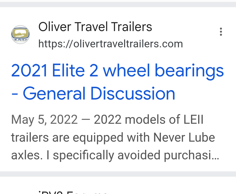

Never Lube are warrantees for 100,000 miles. The hubs shouldn't be touched. In fact I believe the hubs are sealed.

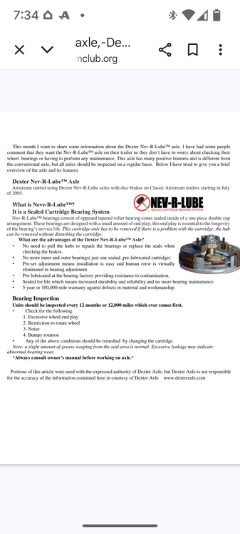

JD, He has a 100,000 mile warranty on the hubs/bearings. He shouldn't have to do anything with the bearings according to the 2022 manual. I also believe the hubs are sealed.
You should never have to touch bearings on the Nev-R-Lube axels for 100,000 miles. Your suspension should be inspected every 12,000 miles. Contact Dexter and Oliver.

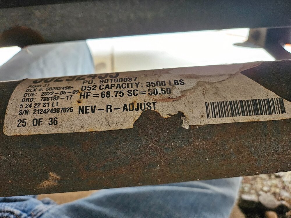

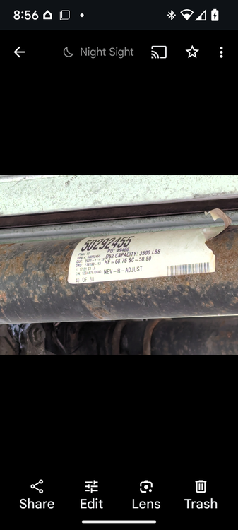

My 2022 has Nev-r-adjust...not Nev-r-lube axles.

According to Oliver the 2022's are Nev-R-Lub. I suggest you contact Oliver on Monday.

Alcan confirmed with Dexter...

Nev-R-Adjust is the brake system not the bearings.
I tried to help them🙃. Our 2022 axel sticker, posted earlier in this thread, also has the reference to the Never Adjust brakes.
