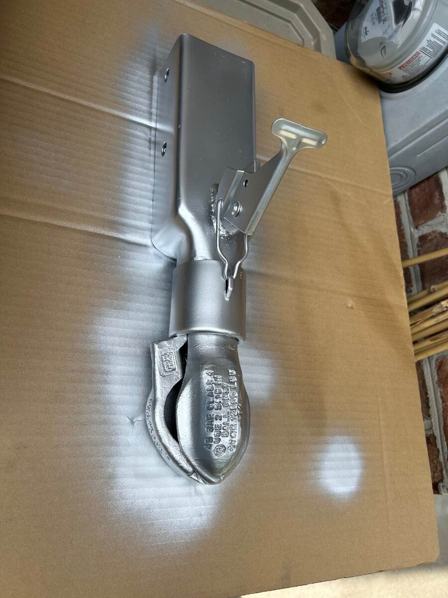

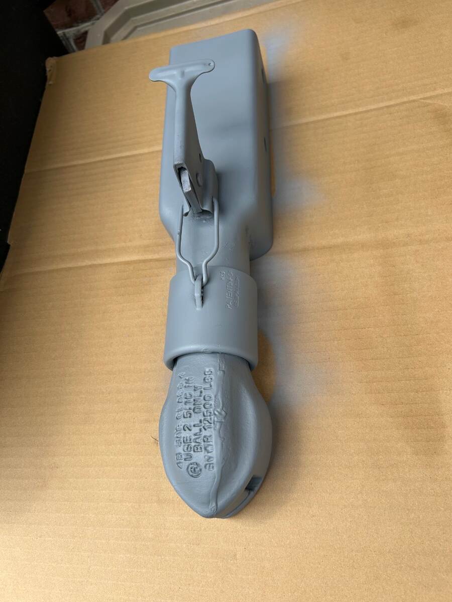

New Bulldog 4B4 coupler drilled, de-burred, cleaned, primed and painted, installed and torqued down. Another project completed despite the smokin heat and humidity of the day. I could not be happier with the final product fit and finish of this mini mod. A big thanks to a close friend who owns a machine shop that does precision work. He measured twice and drilled once. For those running the S/S coupler, I applied double sided tape a few years ago on inside of the coupler to keep it from the metal to metal wearing the paint thin on the coupler. It worked great, so I reapplied it again with new tape. I opted for silver metallic to match the swooshes on XPLOR. A few mod/upgrade photos.😎 Safe Travels! My buddy Brian gotter done! Thanks Brother!! -

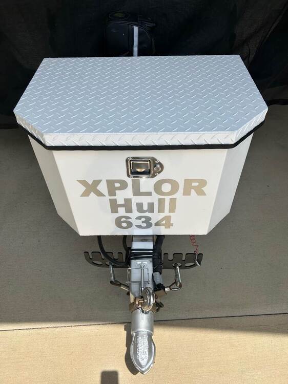

When parked at camp, I use a Proven Industries coupler lock with the optional S/S puck and Medco lock which is extremely robust. It’s just about bomb proof. **** A note to any owners upgrading to the 2 5/16 BD coupler and IF you presently use a Proven coupler lock for with a 2” ball, no need to purchase a new Proven Industries lock. Your current 2” coupler lock will work. I mocked mine up this morning on the new BD 2/16 coupler and its fits perfectly. Do not loose the keys, as I cannot imagine trying to remove either of these this locks. -
