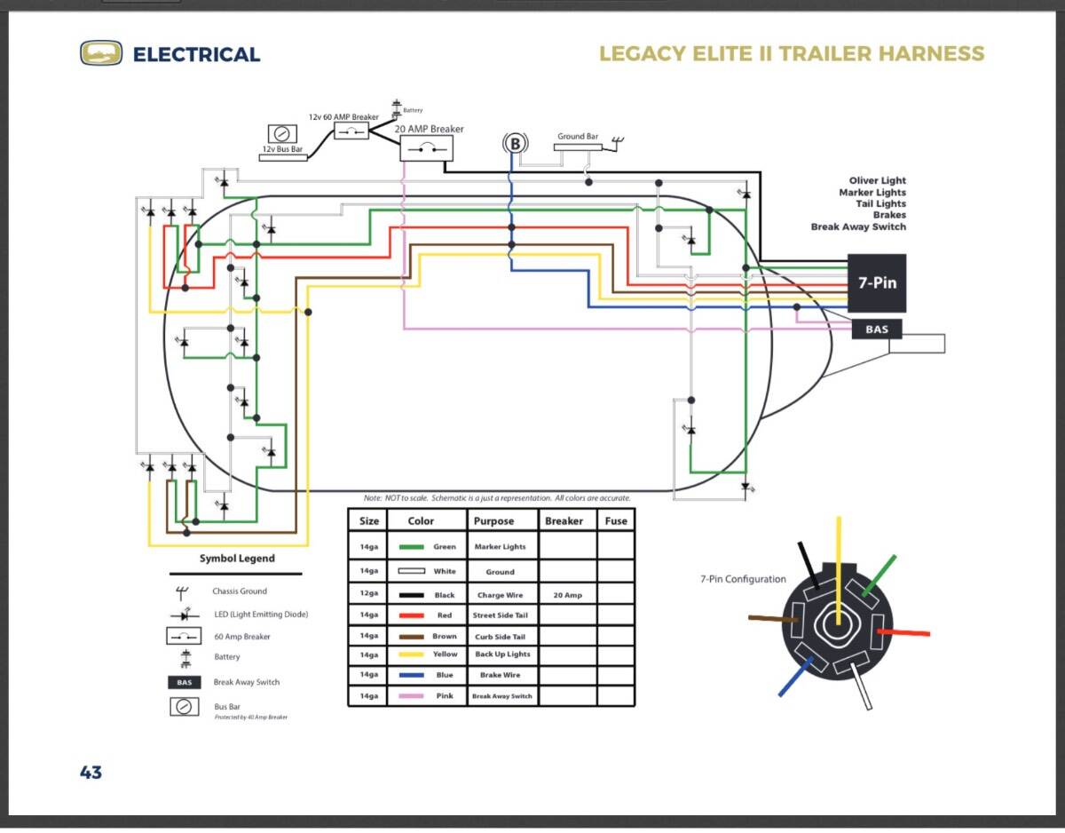

My 2021 E2 has an OptiFuse 12V 60A breaker under the street side bunk. The best wiring diagram I have found that’s close to my model is the 2019 manual (page 43) from the Oliver University. See the breaker in the upper left side. Another quick check is the CO monitor under the dinette. That usually is always on, does not go through the circuit breaker. If that has a light on, you have power coming in, so it is likely the breaker.
