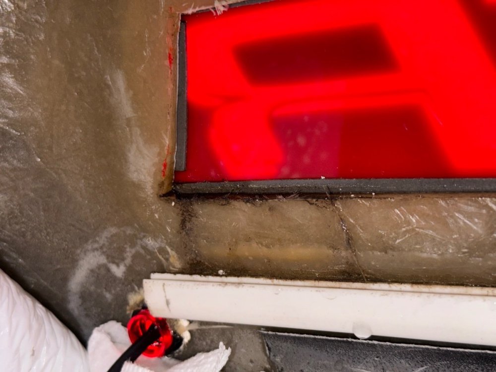

Wondering if a fiberglass boat repair business could take the Oliver sign out.
Grandson did that today before he put white duck tape over the whole sign.I am scheduled to go camping in a few days for 2 weeks and I was just going to cancel, but decided to rig it and just camp.I camp with a bunch of "Sisters on the Fly" ladies and most of them only paid a couple thousand dollars for their 30 year old campers..but you know what??? Theirs do not leak!!!
Leaking into the trough and out both ends making it look like the lights were the ones that were leaking.
Hull 267. Very poor design. Should have been solid fiberglass. with no Oliver sign or little lights. And I am not the only one that has had many problems with those.
This time an RV tech came and said the little round lights were leaking between the silver ring and the bulb. Ordered lights from e-trailer. Installed lights. Put water hose on back side of Oliver AGAIN. Still leaking. Ripped off the insulation and found the water coming from the damn Oliver sign AGAIN. Caulked everything one more time, but this time put white duck tape over the whole sign. Grandson will fix this when I get back from camping and this time will use J B Weld. I am so sick and tired of this camper leaking.
Hey Max, do you happen to have Mike's phone number? Thanks, Nan
Etrailer.com and here is the information on the lights. Red MCL10RKB and Amber MCL10AKB. These new replacements do not have the silver ring around them anymore, but are a much superior product than the ones we replaced. Oliver is out of them right now and Mike Sharpe is the man that gave me these part number which etrailer had the red ones in stock and will ship the amber ones when they receive them.
E-trailer just called me back and they do have them. Thanks everyone.
Can someone please tell me where I can buy the little leaking 3/4" red and amber marker lights? Oliver says they do not have any in parts and I cannot find them on etrailer.com either. They are leaking between the red or orange bulb and the silver ring that goes around it. Thanks, Nan
