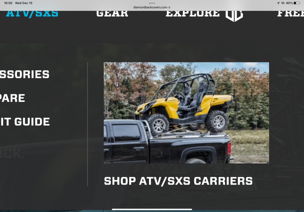

  20. Depends on weight obviously but if your truck is capable you might look into Diamondback covers. I have one (light version) on my GMC 2500 and I love it. It makes your truck bed like a vault and if you buy the HD version of the cover you can load 1600 lbs on top of it.
