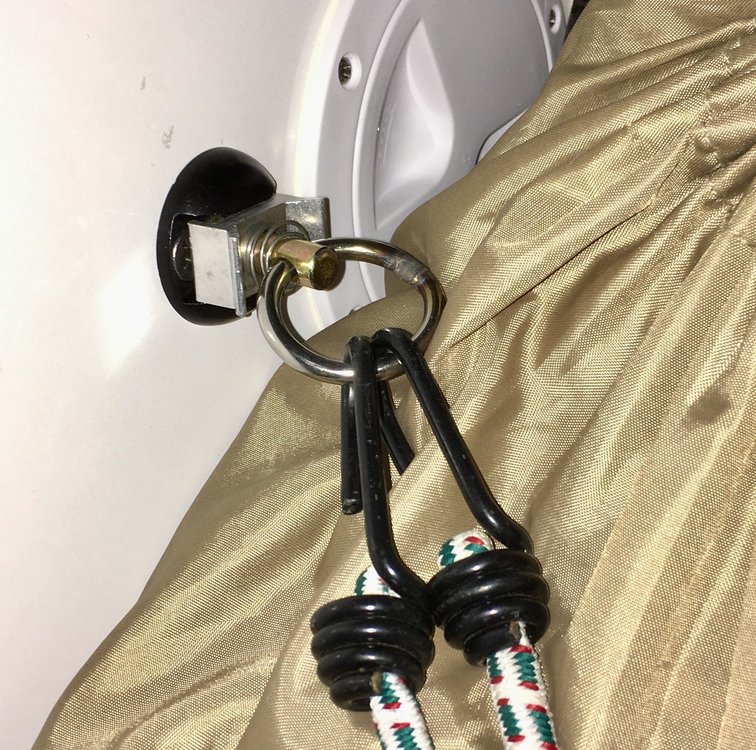

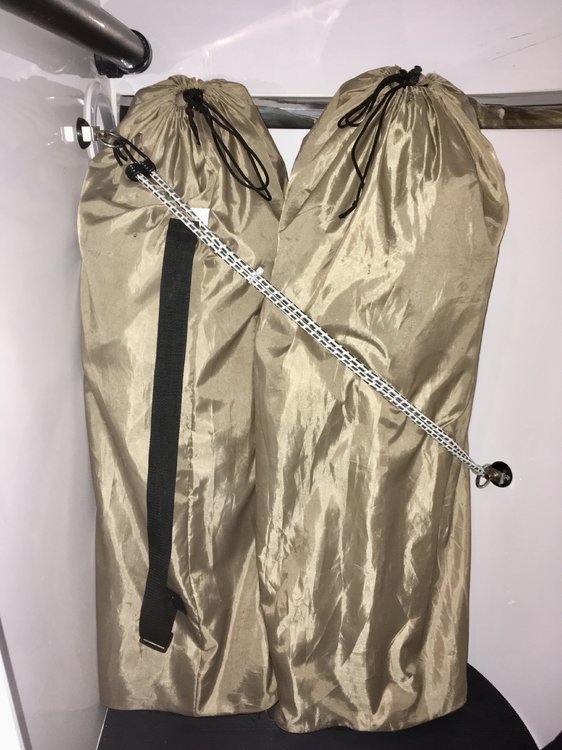

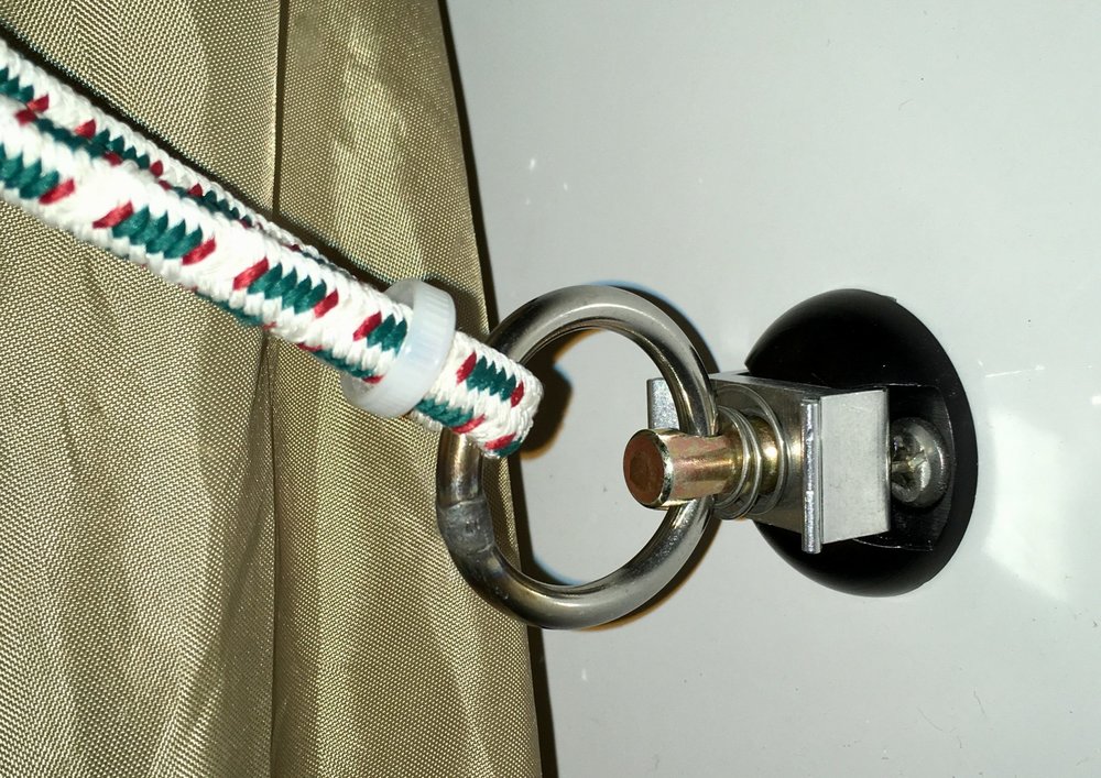

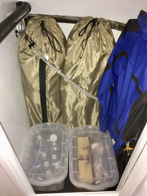

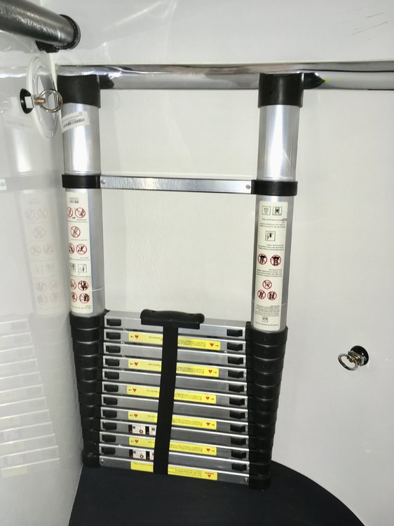

  1. Please refer to this thread for info about the Macs tie downs used here. I ordered extras when I did that mod. http://olivertraveltrailers.com/topic/how-to-wire-cable-clothes-line-full-cabin-length/ I carry a telescoping ladder and two folding camp chairs in the closet, and they flop around on rough roads and make it harder to access stuff on the floor. The outer one sits on a curved surface, and there is not much space between the inner and outer walls. I cut off some #12 screws and used 3M VHB tape in the center to help fill the gap and to add some strength. The upper base sits on the inside closet wall, and I had a small inspection port there, so I mounted the base where I could reach in and feed the threaded backing plate into the correct position. There are water hoses RIGHT THERE, so you need to be careful if you use sheet metal screws. Don't drill through a hose! I used a 3 ft bungee cord doubled back on itself and secured the bottom part with a nylon tie wrap to keep it in place when disconnected at the top. It is a very secure restraint, but it doesn't put too much strain on the attach points. With my two large bins in place, there is a little more usable floor space since the chairs and ladder are now held tight against the front wall: John Davies Spokane WA
  2. With towels hanging from the line, you can still open the overhead doors.... The new cable system sure beats the old setup, where I strung a rope between the front clothes hook and an eyebolt in back... Cool mod, a little time consuming, but I think it will be a very useful setup. Most of my time was spent scratching my head and doing R&D. With the measurements provided it should go quickly if you want to try this. John Davies Spokane WA

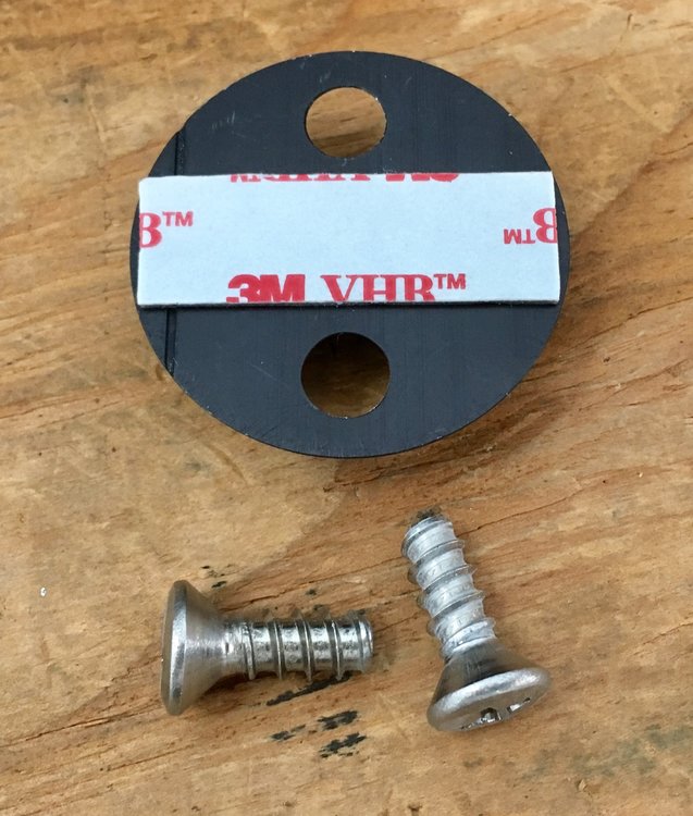

  4. The ceiling base,: the maybe hard one. I originally planned to use one of the heavy stainless backing plates, and fish it through the gap between the inner and outer roof panels. I did check to see if there was room. I removed the trim panel from the Fantastic fan, and there was a 1 inch gap in the wood supports that would have let me get a trimmed plate in there. Unfortunately, the spot where I wanted the base to go was right at the edge of the bonded honeycomb material, one hole would be in the 1/2" honeycomb and one would be in the thinner material. There was no way the plate would sit properly in that spot. So, I used #12 Philips screws and just went straight into the fiberglass, and did not use backing plate. So the center base is strong, but not Uber Strong. I think it will be fine. You could add 3M VHB tape here if you wanted some extra grip. I used a rope stretched tightly between front and rear bases to locate the center base. I wanted the final line to be straight and also parallel with the side walls. I taped it in the correct spot and drilled the holes. The cable lies almost perfectly straight between all three rings, and aligned with the ceiling and the wall. Cool. John Davies Spokane WA
  5. The FRONT base: the hard one! Same measurements as the rear base, use tape and level the holes. (Notice the wood core in this wall!): I was dismayed to discover that the main wall/ bulkhead is held to the ceiling with a strong adhesive, and apparently no real hardware. I am very surprised since the mirror door and closet door hang off this wall, you would think there would be mechanical fasteners along the top. When I first installed this base, in a similar manner as the rear one, and hooked up my fabricated cable, the wall would visibly flex rearward with just a small amount of weight on the cable, no more than ten pounds. That was NOT good. I did not want to rip the wall loose with a few wet bath towels... I took the base apart and fabricated a beefy reinforcing plate out of 2" x 2" x 1/8" 6061T6 aluminum angle, the good stuff. It is very strong and is a similar alloy as to what the trailer frame is made from. I screwed the upper part to the ceiling with #10 stainless screws and silicone sealant, and mounted the base through the angle with more sealant. It won't move now, it is very solid. The reason I used sealer here is that it is a wet area and I did not want moisture penetrating the core of the wall. The other bases do not require sealer. John Davies Spokane WA
