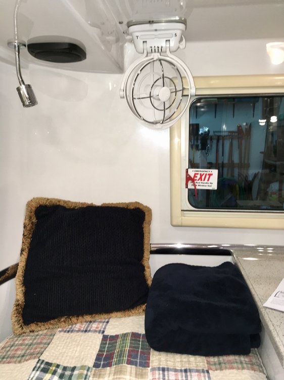

Yep, and I've read through that a couple of times. I'm not going the separate base route, just through the fiberglass. John doesn't say how long the screws were or how thick the material. Thanks, @KenB I have the hinged door off and left side panel out. I didn't have my light to see the speaker opening. Good, idea! I'll be adding a Blue Sea fuse panel, with the input coming from the current 12V socket, and outputs to: 2 Sirocco fans Alexa Echo Dot Apple TV (eventually, currently 120V) the 12V socket Pepwave cellular router
A quick question for anyone who has mounted something in this area. I'm about to mount my Sirocco fans, and gathering hardware. I need to get some #6 screws to mount the base to the fiberglass, and need to determine a length. How thick is the fiberglass in the area where @John E Davies mounted the fan? Thanks!
