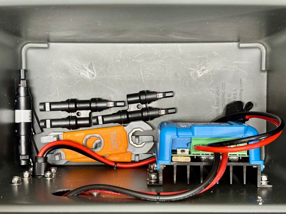

Don already answered, but yep, I did what he did but without the cigarette lighter portion. I used 12G wire, because I have a 100' spool. -

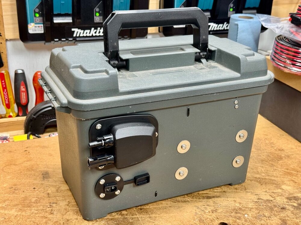

@dhaig Thanks again for the tips. I received all of the POE bits, so mocked it up in the garage. Makita battery powering POE box -> thru-hull port -> 50’ Cat 6 shielded cable-> waterproof junction-> Splitter -> Starlink Mini. I really appreciate the idea of adding the short cable from the splitter that will make assembly easier. Once installed there will be a Cat6 cable from the POE box to my cellular router, and will be connected like you did utilizing the new switch in the basement. Works like a charm! Thank you, and everyone who contributed before! -

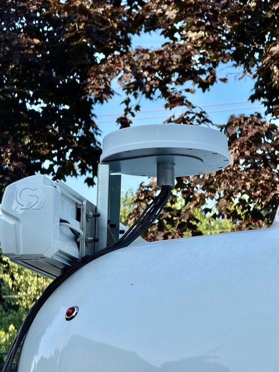

Don, Excellent timing on this post! After two years, I'm finally mounting the cellular/wifi antenna on my roof rather than rely on the stubby antennas on my Pepwave cellular router. At the same time, I'm adding the Mobile Must Have POE injector for the Starlink Mini, and converting the exterior port to RJ45. I'll be mounting the POE injector similar to your setup, and adding the power switch in the basement is a great idea, as you're already there plugin in the Ethernet cable. Nicely done. I'd really like to move the router to the same area, but there's no way I could route the seven antenna cables down there! Plus, they are not long enough. So I'll run a short Ethernet cable from the port to the POE injector, and then a longer Ethernet cable to the back of the basement, up along the nightstand somewhere, and then up behind the rear window shade and into the television port. Only a couple inches of the cable would be visible, which I can live with. It will then go into the WAN port on the Peplink to feed the Apple TV and security camera hub connected to the LAN ports. Any more, and I'm going to need a network switch! When I ordered the POE injector, I also added the optional Pepwave 12V connector, eliminating needing to power both devices separately. With the POE injector in the bilges, I won't be needing that connector, but gain the feature of the exterior switch to power the POE injector separately. That's even better! Thanks for the details. Switch and RJ45 port are on order now. -
