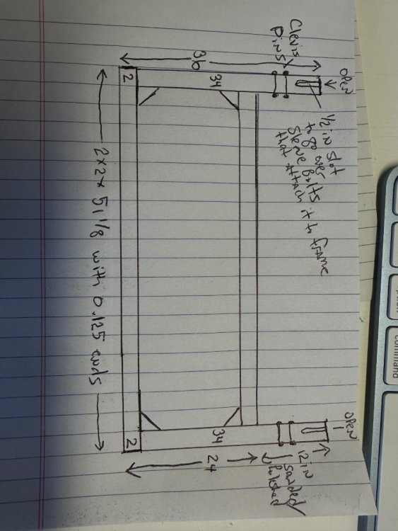

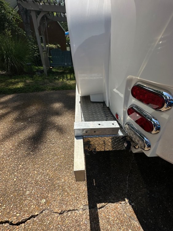

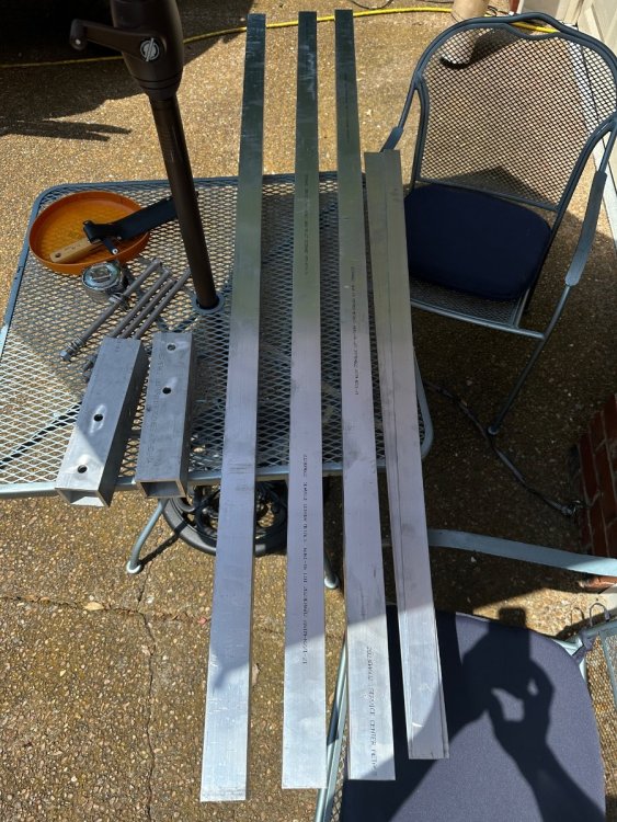

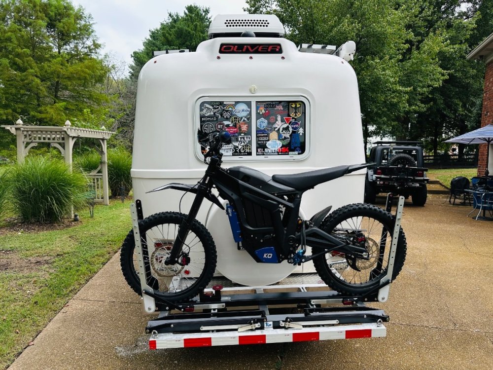

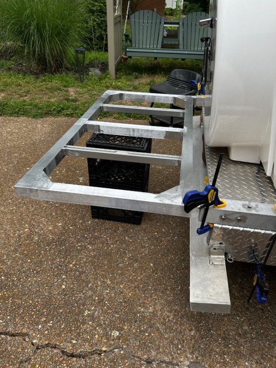

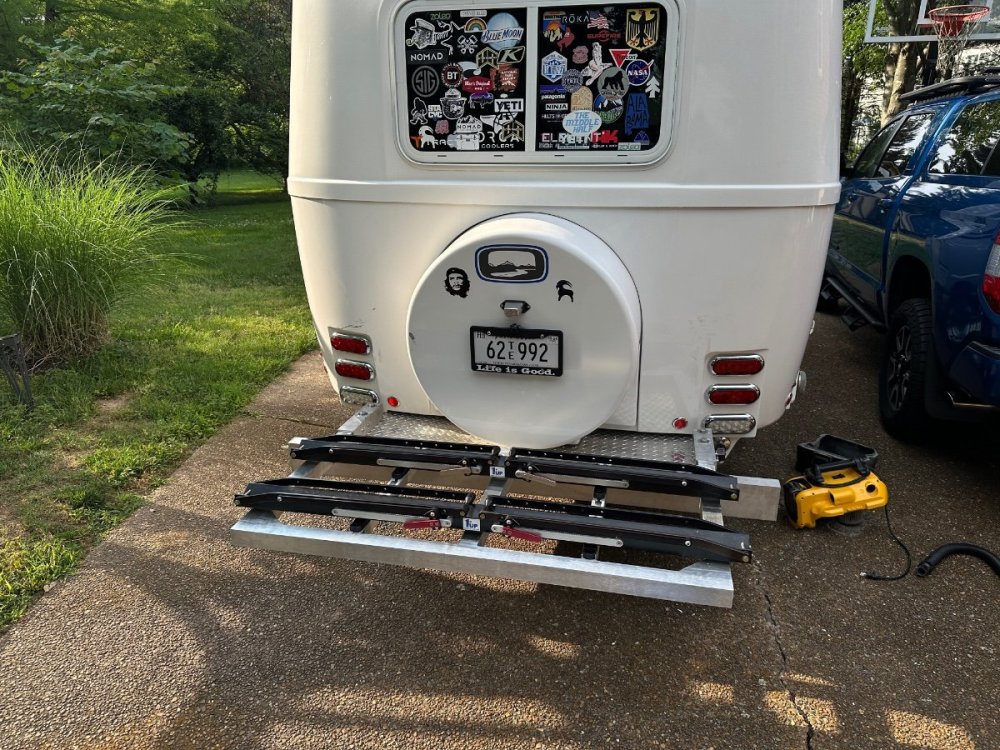

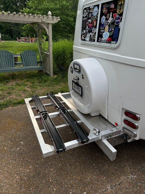

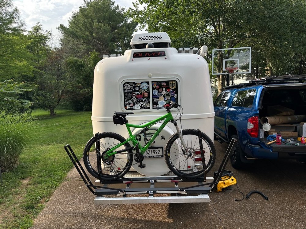

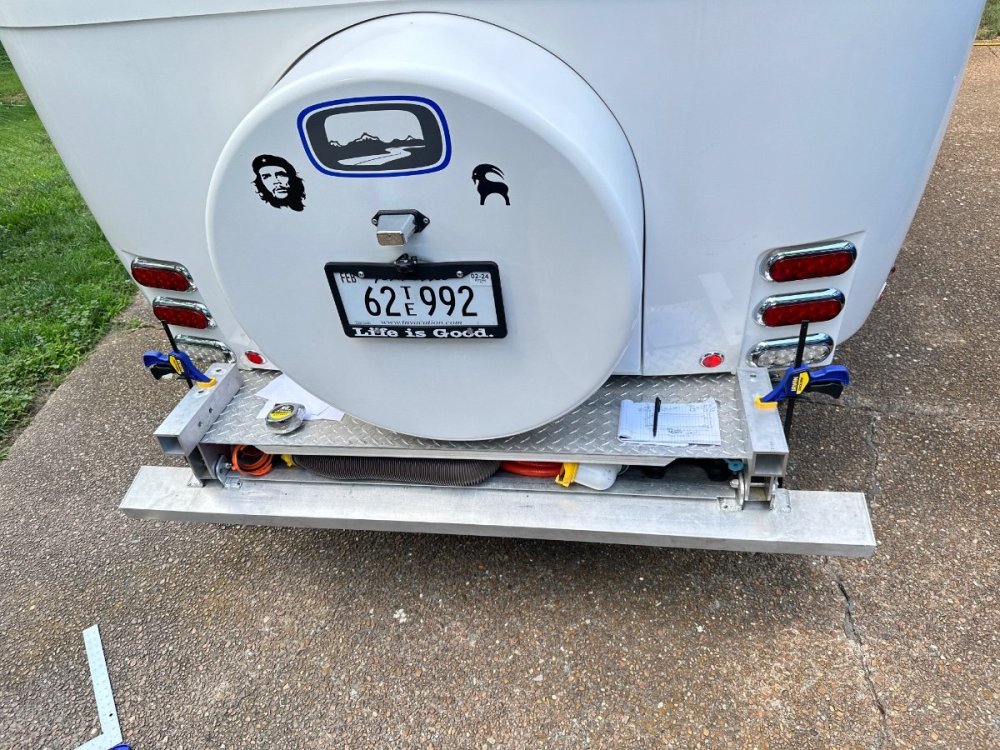

Last summer project that has enabled me to carry bikes much easier. I got the aluminum 2x2s, T-slot material online and the 2x2 sleeves and hardware from Oliver. Local guy in Nashville welded up the tray and cut out the slots to slide into sleeves clearing the bolts. Install was harder than I thought (you have to be very careful drilling the rear hole both sides to go in between downward slats on bottom of frame).

This will certainly be easier for you. Off and on in a heartbeat. You'll be happy and great project!

Is there a plan for adding rear lighting (i.e. brake and turn signals)?  And license plate location?
It's sooooo nice having a couple bikes when traveling - regardless of how you're hauling them.
Regarding @topgun2's comment, we like having the LED strip light across the back of our rack.  It gives red "running lights", yellow turn signals, and yellow emergency flashers - makes us a bit more visible when hauling our bikes at night.  Some models are now offering white "back-up" lighting - like this one:
@rideadeuce - very clean mod!  How's the departure angle when maneuvering through a parking entrance from the road?  Just curious...

@topgun2 Need to probably do both but haven't got to it yet. 3rd brake light with blinkers for sure!
@MAX Burner As far as departure angle. I have a pretty steep start to my driveway and the Ollie frame will hit occasionally but not the bike rack.
