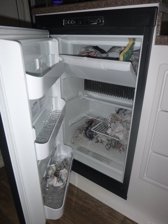

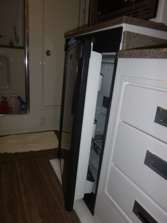

Which reminds me of a "trick" I learned a number of years ago for a fridge in storage.
After all contents of the fridge are removed and the fridge cleaned and dried, place some crumpled newspaper in both the fridge and freezer - it only takes 6 or 7 sheets.  AS Patriot says - leave the fridge door cracked.
When its time to get the Ollie out of storage, simply remove the newspaper, turn on the fridge and stock it.  There will not be that funky fridge smell at all.
Edited by topgun2
added pics
