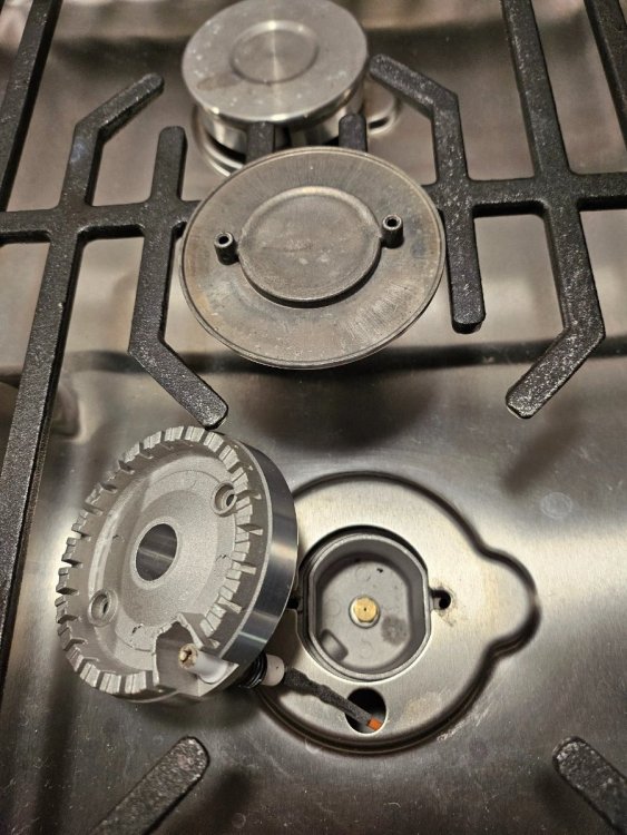

I have a 2022 Oliver Trailer with a Dometic Stove D21 installed. One of the burners is loose and there are no screws attaching it to the stove. I do not know if screws ever existed or if the screws fell out & down. If screws once existed there are likely in the underside pan cover space. I have not tried to take the stove apart. (Photo attached)
I will check when I purchased the Oliver and the stove in 2022 when home so I am unsure whether the stove is under the 24 month warranty or not.
However, if one were to attempt to repair (reinstall the two screws) is this accomplished by remove the top stove from the top of the  counter OR dropping the stove "under pan" below the stove and behind the drawers.
Depending on which repair option is correct any information on how to conduct the repair process.
Thanks

I don’t know but it looks like the two screws came up from the underside, went through the piece with the igniter, and threaded into the top cover. Are the two bosses in the top cover threaded? Can you look from underneath at the other good burner and see if there’s two screws going up into the top cover? Could that burner never been assembled completely from the start?

We also had this issue while up in northern Canada last summer.  We believe it was a problem for a couple of years, we just were not aware of it until it was loose enough to start coming apart.  When we returned home I got ahold of Dometic and received the following email reply.
From: CustomerSupportCenter [mailto:customersupportcenter@dometic.com]
Sent: Friday, September 1, 2023 9:46 AM
To: BryanB
Subject: RE: Dometic.com Support Form - US - productsupport - rv - b2c
Hello Mr. Bjornstad:
I was able to reach out to our engineering department.
The engineer indicated the information directly below:
“the bolts used to secure the burner caps are common M3x24mm socket head screws.  They can be found at most hardware stores.
He should apply blue Loctite to the screws before putting them in.”
Yes, there are threads in the underside of the burner caps.
The burner cap is made of 'pot metal' so if the screws are not of the exact sizing and ARE NOT 'Loctite-d' in, they may vibrate out again or worse yet, they may strip (as ours did) out of the soft pot metal burner cap.
There was no indication (blue) of there being any Loctite around our screw heads when we were taking it apart to repair it.  So the Loctite comment above may be a revision based upon customer experience.
The following is what we did to fix the issue.  We only had one screw per element and no Loctite at the time so we were at a less than ideal situation.
  • turn off the gas at the tanks,
  • remove the stove from the countertop,
  • disco your gas fitting,
  • turn stove upside-down and, make a note of the 'ignition wiring' if you have to disco more than one of them,
  • remove the underside heat shield,  (you have to cut the zip ties to remove it, replace zip ties to reduce vibration on re-install),
  • re-insert the screws,
  • apply Loctite where the screw head comes in contact with the assembly,
  • then re-install the stove ‘Check Gas fitting for leakage’.
We actually became quite proficient at this and I would be able to do it (less Loctite) as Maggie was doing 'meal prep', so I was done when she needed the stove.  That is until the loosening of the screws and vibrating caused the 'burner tube' coming into the mixing bowl to break.  At that point the stove was UNSAFE to use.  So I put it in the back of the truck, got a brass plug for the gas supply line and covered the area with the 'Oliver supplied' sink cover, and taped that down.  That gave us a larger meal prep area, and more outside cooking.
Our final resolution when we returned home (because stove was basically shaken apart) was to replace our D21 (AMZN Dometic outlet), because we were unable to find the replacement parts that broke as a result of the ‘burner caps’ coming loose, and shaking/breaking apart the internals of the stove.  When the new stove arrived, I took it apart at the bottom and made sure all 4 screws were there and sure enough, signs of blue Loctite on the screw heads.

Thanks for the walkthrough.  Both screws from underside one burner came out...very fortunate Wendy found them both and we were able to use your help to fix everything.  I did have to disconnect the gas line and after using gas thread tape and follow up with a "sniffer" all turned out well.  We did use blue locktite on the screws.  No evidence of previous locktite application  Thanks,

This also happened to Carrie and I several months ago. I took the stove out and I was not able to locate the screws. I just drilled through the aluminum disk and used a bolt with a nut. Definitely shouldn't come out again.

These are metric screws that come up from underneath to hold down the burner cap.
Most RV appliances are going to have metric (screw, nut, and bolt) fasteners, to be compatible with the non-USA market.
If you are going to ream/drill-out thru the burner cap and put in bolts... I would stay small, less than say 1/8-3/16"...  At that point I would probably go with a small 'round-not-slotted-head', a slotted head is just one more place for food to catch and be difficult to keep clean.
My problem was, with all the shaking (Campbell Hwy, roads to Mayo, Keno & Tuk) on our AK trip 'on roads less travelled', the threads on the underside of the burner cap had pulled/stripped away.  Also not thinking "hey, could they be metric not SAE".  So I caused some issue by trying to fit SAE into Metric.  My Very Bad!!!
If you have the D21 (ours was installed in mid-2020) and you remove it, and do not see blue Loctite on the screws, at that point, I would get some 'Blue', loosen up the screws just a bit and add a drop of Blue, retighten, and call it Preventative Maintenance time well spent.
I am not sure when Dometic started adding the Blue Loctite to those screws.  it was done sometime between 2020 & their 2023 email reply.
That is the 'million dollar' question.
When it was assembled at the Dometic factory did it have two screws on each element or one.  That would be a Dometic QC question.
I am not sure what happened with the Gliddenwoods stove, I was just posting that their issue looked similar to ours, and what our involved.
By the time the burner caps became loose, and then fell off, I fount one screw in the drawer below, and one was in the remaining element.
I searched all over for the other two screws.  The heat shield below the stove, may have helped those screws find a really good hiding place.
Kind of like where socks hide in the washer or dryer...
This D21 assembly 'Process Change' to add blue Loctite to the screws tell me, this was a re-occurring problem, and this is how they chose to address it.
And I am good with that.

Those screws definitely get HOT!  I'm not installing a 3rd unit for sure but I appreciate your help!  There are too many reports about this problem with no proven solution.  Have you had any problems with yours?
Thanks much,
John
Edited by johnwen
Thanks much,
John
I have not, but it sounds like I need to add this to the periodic maintenance inspection checklist!
Edited by katanapilot
corrected capitalization
