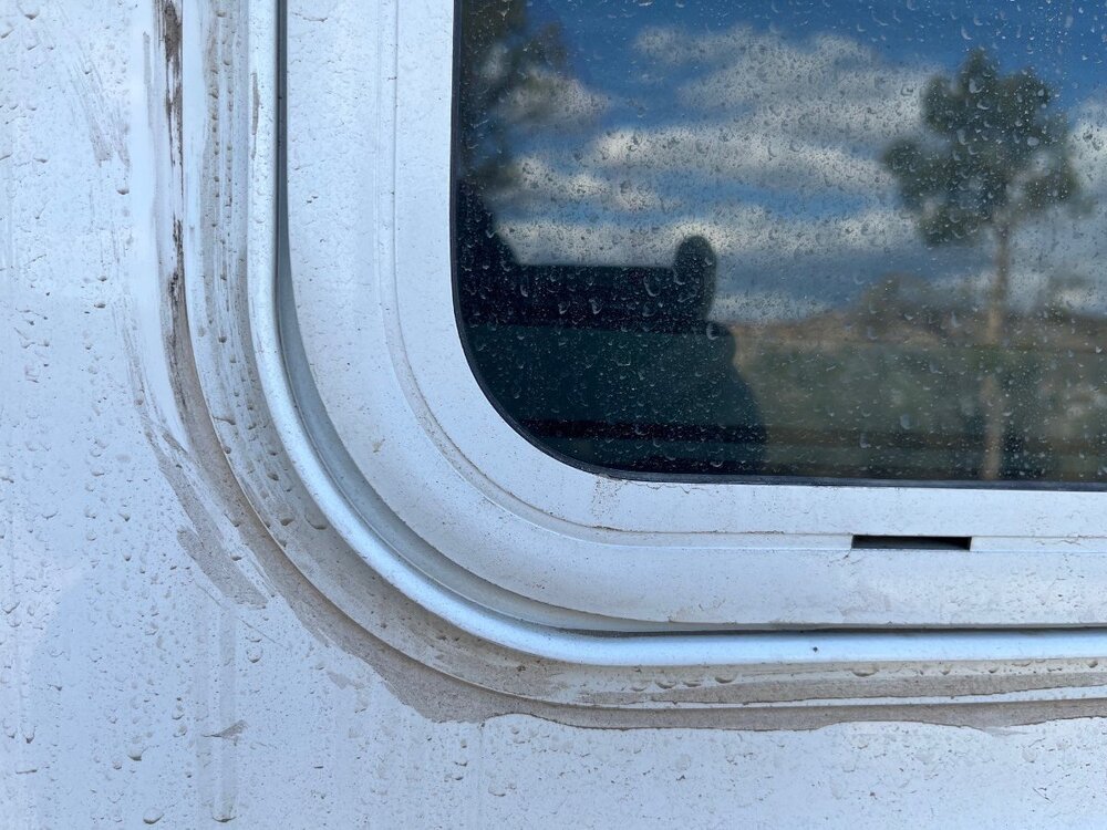

Anybody know why OTT caulks the fender flares? OMG, if water was to leak there it will get your tires wet!?! 🤣 How crazy is that? What is the thinking here? Why is our wet bath caulked everywhere? Is it not a formed fiberglass inner hull? Or is there truly a seam between the vanity and the walls? Or is it people think it looks better?

I just don't like the over-use of caulks of any kind. My hobbies have always been around restoration since the late 70s. Experiences with so many old cars, used trailers/RVs and old homes, etc. I do all my own M&R work, on auto, home and RV though will contract paint and detailing work, to which I have no strengths and experience. What I know, is I've spent/wasted way too much time removing sloppy caulk and paint.
I have seen more bad jobs than good, and our Oliver windows (pic above) is just one example in a lifetime in the witness of shoddy work. Most DIYers admit they do not have the artistic hand to apply caulk nicely. Me too and many professional tradesmen are just careless.

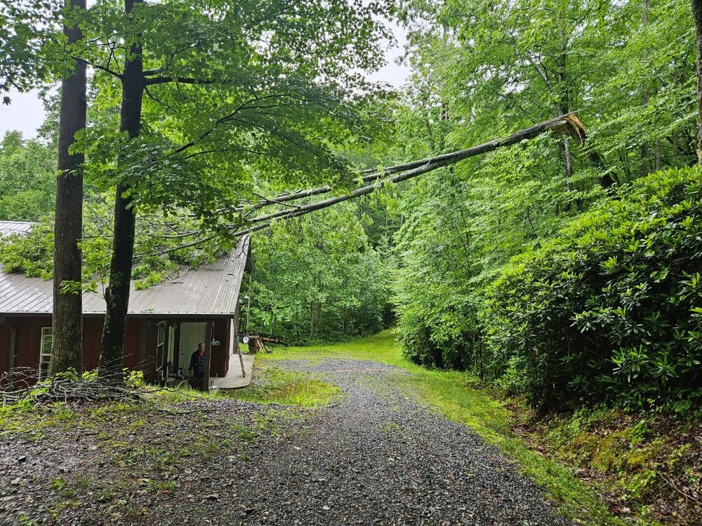

Sorry I didn't respond earlier.
We've been a bit busy with storm cleanup.
  • Wow 3
Whoa @SeaDawg! Sherry, it's a good thing that appears a light landing on the roof. Looks like the leaves and density of small branches cushioned the fall. We had an oak tree branch downed by lighting years ago. It took down a gutter, some roof damage and the rear of a Dodge Intrepid certainly needed a body shop. Hope it's just clean-up for you!
If I was in the neighborhood, I'd be over right away with my Stihl 026 and pole-pruner to help! 🙂
Sorry for the threaddrift, Mike.
We're all good now. We have a friend in the tree service. Came out to survey two hours after the tree fell Monday morning.  By Tuesday noon, his skilled crew got everything off the roof, with no other collateral damage but the original bashing of the ornamental cupola, and a few minor original dents and dings. Took down five other "suspects" for us, near rhe barn.
