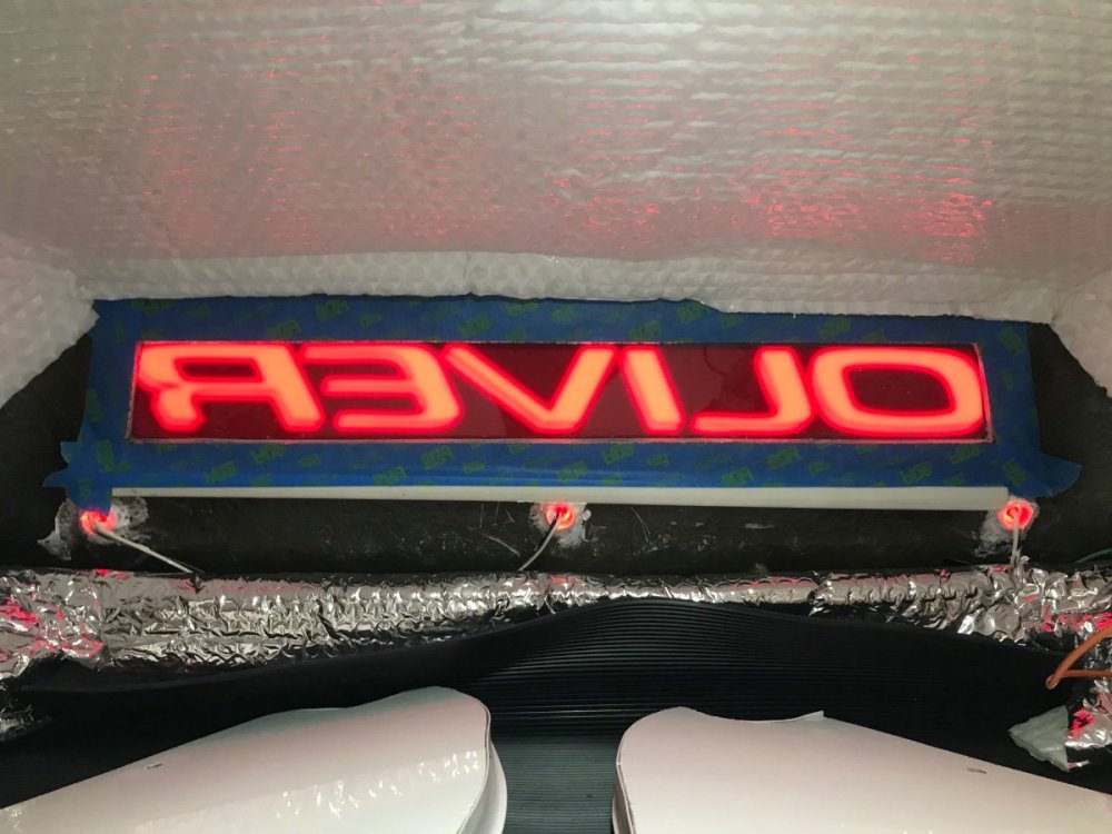

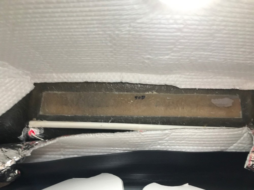

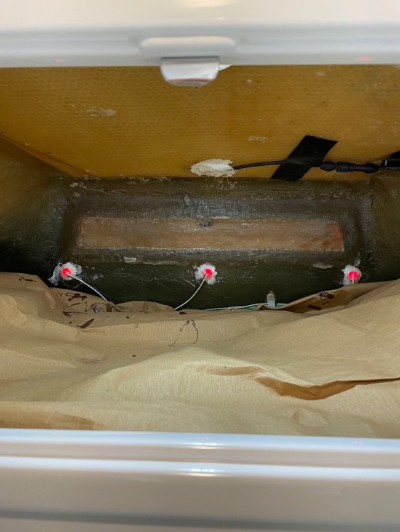

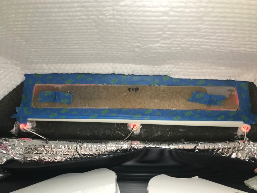

I have posted this before when talking about this light’s propensity for leaking. My light leaked four times in the first three years of owning our trailer. Oliver caulked it twice and I caulked it twice. I realized that this issue was going to come back over and over so I decided to do one final repair. When I picked up our trailer, I asked for and picked up several sheets of fiberglass scrap cutouts from windows and doors. I used a piece of this to make a plug for the hole. I removed the light and epoxied the plug into the hole from the inside. I used a high solvent based epoxy for this then I later fiberglassed over the plug to reinforce the patch. Now four years later still no leaks.
