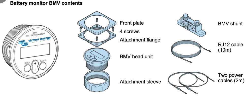

Key to the BMV-712 Smart Monitor is that it gives both a meter readout or a mobile phone application indication of your battery bank State of Charge (SOC).  When we acquired our's, the meter and the Victron Smart Shunt (necessary for this install) were sold separately, they may be a package deal at this time.
It's a straight forward install and we strongly recommend this set-up for those who enjoy frequent boondocking.
Here's a link to the Victron site that explains the "Quick Install" procedure:
https://www.victronenergy.com/upload/documents/Quick-Install-Guide-BMV-712.pdf
Many of us owners have installed a "negative" buss bar to connect all 12vDC components to the buss bar and then to the negative terminal of the Smart Shunt for a clean and tidy wiring configuration.

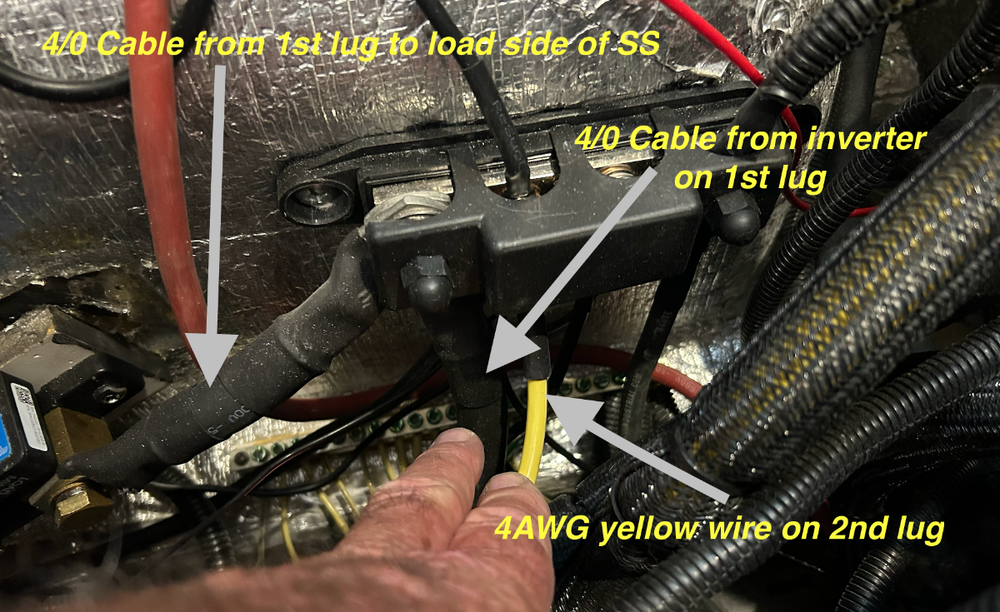

@MAX Burner, I plan to add a smart shunt when I do my solar install. Just to be sure I understand the routing for shunt. I have an inverter. My current negative 4/0 cable going straight from battery to inverter will now go to battery side of shunt.
Load side of shunt will get 4/0 cable going to inverter and the 4AWG yellow wire currently going to ground terminal?
Derek and Deana | 2019 LE II, Hull #484 | 2023 F150 EcoBoost | SE Louisiana
In my particular configuration, the NEG 4/0 cable from the Xantrax inverter goes directly to the first lug of the NEG bus bar.  The first lug of the NEG bus bar is connected to the load side of the SS with a 4/0 cable.  I've connected the 4AWG yellow wire to the 2nd lug of the NEG bus bar.
It's not easy to see from the above pic, but my middle finger is pointing to the 4/0 cable from the inverter and my index finger is pointing to the 4AWG yellow wire.  So this way, the SS can monitor current to and from the inverter because its NEG lead is connected to the bus bar which goes through the shunt.  From the 4th lug I've routed the NEG bus bar to the factory frame ground, FYI.
Hope this helps...
