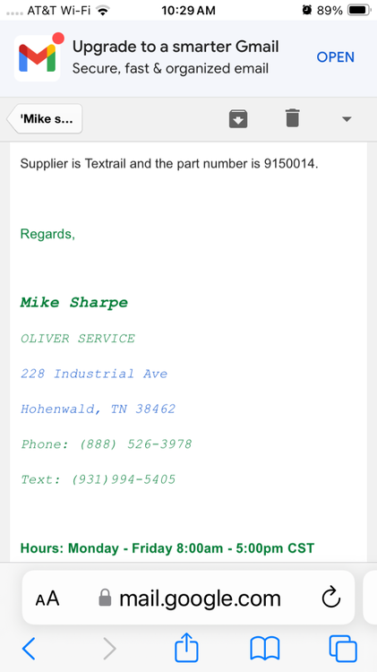

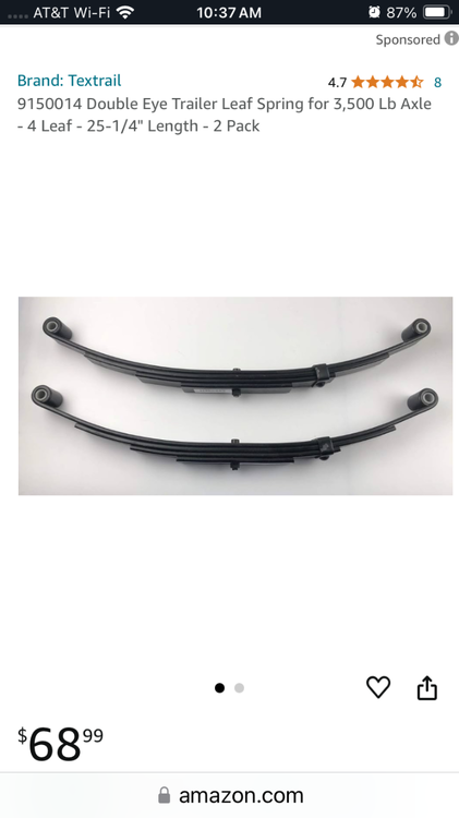

Here is the replacement spring info Oliver Service sent me for my 2021 E2.  They can be found on Amazon in pairs for $68. Note that the springs on Amazon appear to have nylon bushings rather than bronze, but they would serve to get you back on the road and home where you can figure out your final solution
Please open a service ticket with Oliver so they are aware of the issue and can advise for your exact hull#
