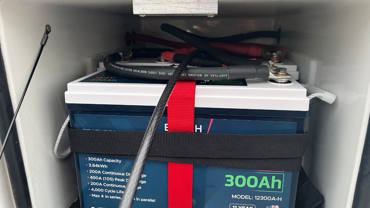

I turned the eyelet bolt on an angle so that the cable lock and strap would fit nicely. I placed foam around and between every side of the batteries. I put 2" of foam between the 2 inside batteries to give the eyelet space, keep it from rubbing.
I have an 8-ft cam-buckle strapped tightly around all 3 batteries and these cam-lock straps cinch nicely! A 4-ft strap and the cable lock go through the eyelet to pull the outer battery inwards.
I also had to make two more 4/0 battery cables. I planned the layout so the main ground is convenient right-front. And now without the battery tray, I can reach all the way in, over the batteries. I tightened all 6 battery terminal bolts after all 3 batteries were tied down, so these can be easily checked and tightened when needed.
Edited by jd1923
Once I got to this point, I started thinking a thief could possibly undo the battery cables, loosen the straps and even with cable lock in place, slide out the outer battery, then steal them all. Oh No!
So, I had a 12x12x1/4" sheet of aluminum left over from another job and it became the perfect solution. Now besides a taking a crowbar to the battery door, a thief would have to cut the 3/8" hardened steel cable. Now these expensive batteries ain't goin' nowhere!
I'll cinch down the straps and cable lock again, after putting on some miles...

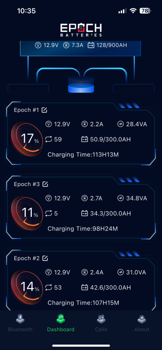

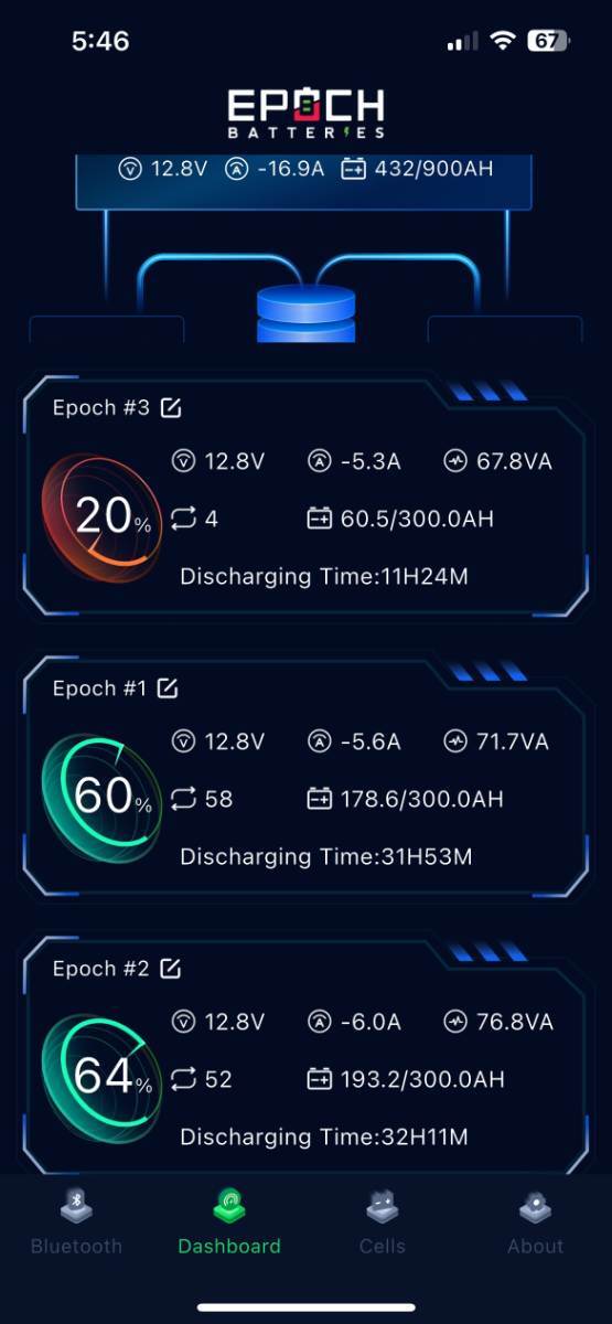

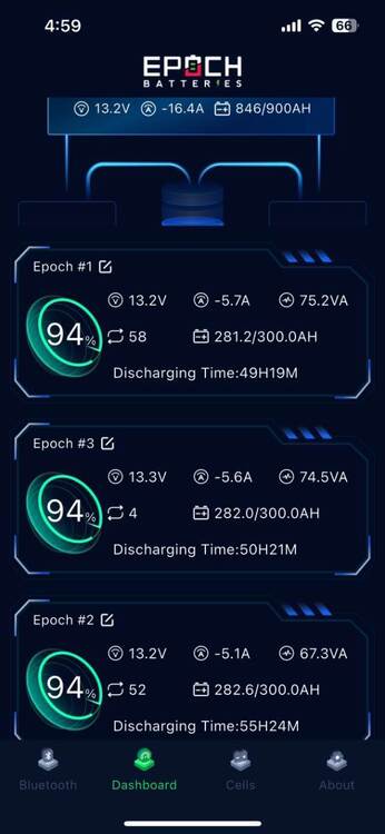

Ya gotta love the new look of our Epoch app! 900 Ah - Priceless! 😎

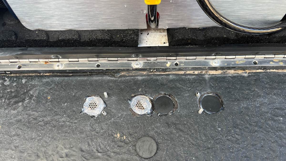

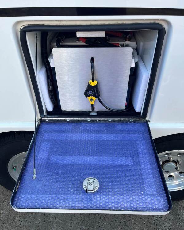

Final touches on the battery door to seal the vent openings and insulate the door...
I put a bead of clear silicone around each hole. Then pushed in the 1" rubber disc into place (pic1). The silicone oozed through the perforated openings as I wiped off the excess with many small pieces of paper towels. Final step was to clean the silicone from the outside with paper towels soak in rubbing alcohol.
Then I used some bubble insulation that came in a recent shipment. The lines you see are carpet tape to hold it in place (pic2). The insulation is only 1/4" thick and now the door is nicely tight when locked.
Really like your installation! We just purchased new Epoch batteries to replace the BB batteries, really like Epoch's App, too!
