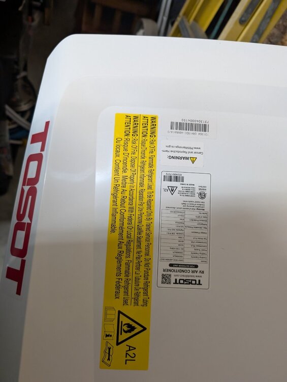

Ty J Posted April 1 Posted April 1 Wow I did take picture of Serial and specs. Looking through my pics. R32 Softstart was recommended by Tosot support 2 2021 Legacy II Hull #728 Pulled by 2015 Toyota Tundra 5.7 with 6.6 bed with Decked pullout. 300 Watt Bouge cigs flat solar. dual 30# propane tanks w/GasStop safety devices and Mopeka tank sensors, Victron Multiplus II 12volt., 400 x Battleborn Batteries ,Victron SmartShunt, Victron cerbo and screen. 2 x Victron Smart solar 100/30 and 1 x Smart solar 100 x 15. 800 watts ground panels. Mopeka tank sensors x 2 , Tempature sensors fridge battery compartment Ruuvi tags with fans. 12 volt Nova Kool refrigerator. Tosot A/C. Pecron E3600 + 2000 and 2000 Batteries with victron Orion 50amp dc to dc charger.Electric water valves and IRVWPC2 water pump controller. Truma on demand water heater. Added outdoor side Table. Bumper Toolbox, and Many more mods thank you contributors!

jd1923 Posted April 4 Posted April 4 On 3/31/2025 at 6:24 PM, Ty J said: Wow I did take picture of Serial and specs. Looking through my pics. R32 Softstart was recommended by Tosot support. Thank you and please verify. When I zoom in on the label, it gets too blurry to see. Does the label state: "Refrigerant R32?" Chris & John in Prescott, AZ | 2016 EII #113 | '01 Ram 2500 Cummins!

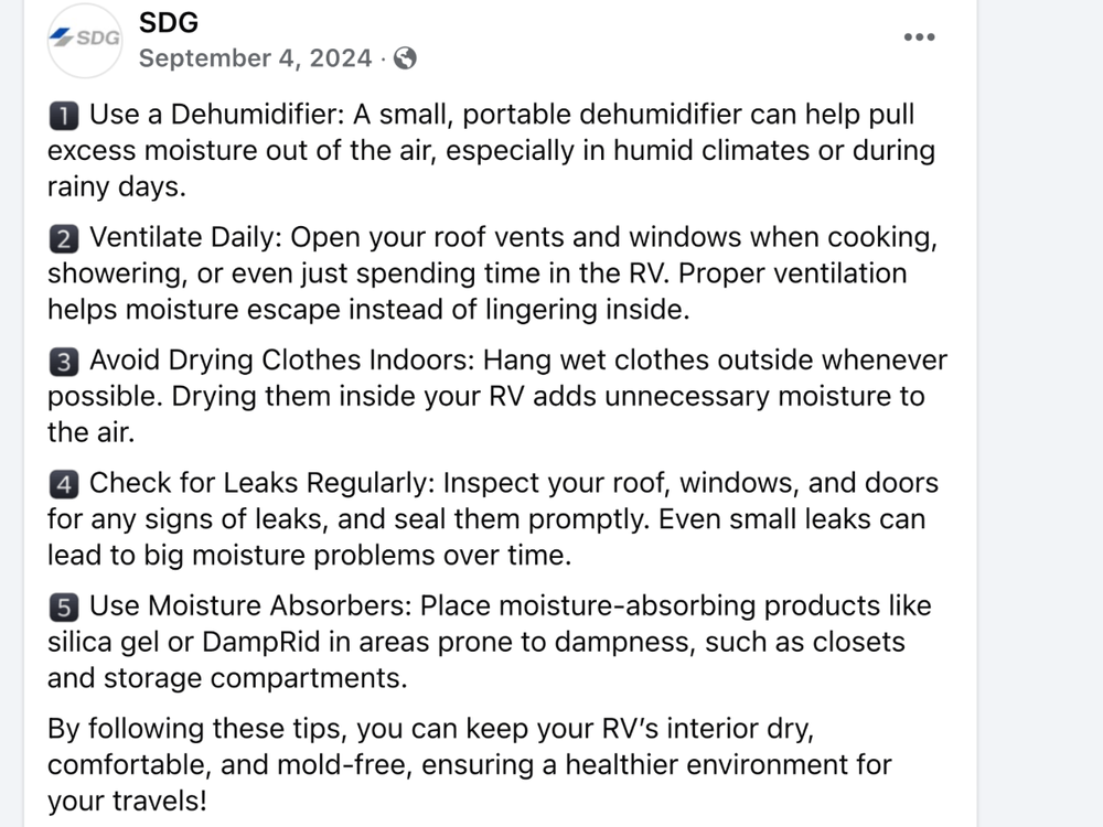

Ronbrink Posted April 13 Author Posted April 13 I read this post in SDG’s FB on general humidity control measures and thought these tips may be of interest: Ron and Brooxie | Clear Lake (Houston), Texas 2020 OLEll, Twin, 579: No installed solar, dual 30# propane tanks w/GasStop safety devices, Renogy 40A DC-DC charger, 460Ah LFP battery bank/Victron SmartShunt, auxiliary Cerbo-S GX/Victron 30A Blue Smart IP22 Charger combo, interior mounted Hughes Autoformer, twin independent sliding Lagun mount tables, extended dinette table and pantry landing, tongue-mounted hoist, Beech Lane refrigerator Ventilation/Evaporate Coil fans, metal valve stems with TST cap sensors and signal repeater, Waste Master sewer hose management system, Dreiha Atmos 4.4 A/C upgrade/Ceilo Breez Max thermostat, FlagpoleBuddy Starlink Mini suction mount kit. 2019 GMC Savana 2500 Cargo Work Van: Explorer Limited SE, Low-Top 7 Passenger van conversion, 6.0L V8 Vortec, 6-Speed Automatic, RWD; Air-Lift LoadLifter air suspension/WirelessAir compressor; Bilstein B6 4600 Series shocks; metal valve stems for TST tire pressure monitoring system; Buyers Products cargo containment boxes/DC Cargo securement system; rear bumper DC-DC Anderson power cable outlet; 100Ah 12V portable power station/Dometic CFX 75L Dual Zone cooler; front 2” receiver hitch/QuikrStuff Mach2 double bike rack; Mechman 320A high output alternator; Starlink Mini/Veritas Vans magnetic mount.

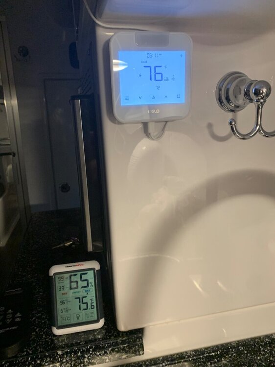

Ronbrink Posted April 20 Author Posted April 20 On 3/31/2025 at 8:54 AM, CRM said: I'm more concerned with how low the CFM's can go at it's lowest setting for controlling humidity and I couldn't get that info on the Atmos when I was researching it. Just an observation. I went to the Cow Barn last Friday to check on the Oliver and run the Atmos on the LFPs in order to drop the SOC below 75%. I do this routinely when in storage for lengthy periods to cycle the batteries and exercise the charging system, which has dual chargers kicking in at that specified level of charge. As the Atmos was running to cool the interior, I referenced the User’s Manual and learned how to operate the Sleep Mode. The unit was whisper quiet and I could only tell when the compressor was running by watching the VictronConnect app as it kicked in. During the interim however, I was also watching the humidity levels as the Atmos cycled in this mode. I observed a 5% fluctuation in the humidity between compressor cycles, which remained steady for the duration of this Sleep Mode test. As it may relate, the interior temperature inside the Oliver was 87° upon arrival (stored inside a totally enclosed storage facility), outside temp was 85°. Because the dehumidifier had shut off due to a full reservoir, a reading of 58% was observed, outside relative humidity was high (>70). During initial operation in Cool Mode, the interior temp dropped to 76° and humidity to 50% in 20 minutes. For the remainder of operational time in Sleep Mode the compressor cycled with a 3° fluctuation in temp and humidity range of 49-54%. 4 Ron and Brooxie | Clear Lake (Houston), Texas 2020 OLEll, Twin, 579: No installed solar, dual 30# propane tanks w/GasStop safety devices, Renogy 40A DC-DC charger, 460Ah LFP battery bank/Victron SmartShunt, auxiliary Cerbo-S GX/Victron 30A Blue Smart IP22 Charger combo, interior mounted Hughes Autoformer, twin independent sliding Lagun mount tables, extended dinette table and pantry landing, tongue-mounted hoist, Beech Lane refrigerator Ventilation/Evaporate Coil fans, metal valve stems with TST cap sensors and signal repeater, Waste Master sewer hose management system, Dreiha Atmos 4.4 A/C upgrade/Ceilo Breez Max thermostat, FlagpoleBuddy Starlink Mini suction mount kit. 2019 GMC Savana 2500 Cargo Work Van: Explorer Limited SE, Low-Top 7 Passenger van conversion, 6.0L V8 Vortec, 6-Speed Automatic, RWD; Air-Lift LoadLifter air suspension/WirelessAir compressor; Bilstein B6 4600 Series shocks; metal valve stems for TST tire pressure monitoring system; Buyers Products cargo containment boxes/DC Cargo securement system; rear bumper DC-DC Anderson power cable outlet; 100Ah 12V portable power station/Dometic CFX 75L Dual Zone cooler; front 2” receiver hitch/QuikrStuff Mach2 double bike rack; Mechman 320A high output alternator; Starlink Mini/Veritas Vans magnetic mount.

Ronbrink Posted April 26 Author Posted April 26 (edited) On 4/20/2025 at 8:28 AM, Ronbrink said: I went to the Cow Barn last Friday to check on the Oliver and run the Atmos on the LFPs On 4/20/2025 at 8:28 AM, Ronbrink said: I referenced the User’s Manual and learned how to operate the Sleep Mode. The unit was whisper quiet and I could only tell when the compressor was running by watching the VictronConnect app as it kicked in. I made the above comments on April 18th, at which time I played around with the Sleep Mode on the Atmos. Upon departure of these routine visits I always check to be sure everything is turned Off, except for the dehumidifier. Admittedly, there have been a few times after locking up the Oliver and then the COW Barn when I question whether or not the dehumidifier was turned back On, or the closet light and water pump turned Off and thus, back inside to check all again. I recall everything to be in good order so back to lockup and departure. Well, when I went back on April 24th to pay rent I was baffled to see a puddle of water upon entering the COW Barn; my first thought being somehow the roof developed a leak from recent heavy rains. However, when entering the Oliver I felt the cool and comfortable 73° interior and noticed the Atmos’s fan was On, then realized the puddled water was condensate. YIKES, it was SO QUIET I didn’t even realize upon last departure it was still running! Now this isn’t a testament to how wonderful the Atmos is and pleased I am with its performance, but rather that of the Hughes Autoformer I permanently installed. Fact being, the storage facility only provides 15A service and with recent severe storms that device’s surge protection may have prevented damage to my Oliver’s electrical system or even the Atmos. More importantly, upon checking the Autoformer was boosting voltage, which I have observed a few times since the install during storage. This occurs when line input voltage drops to 116 volts or below, wherein the unit’s output is automatically boosted 10% over the input. It is a known fact that insufficient voltage, both spikes and surges, can cause irrepairable damage to sensitive electronics and RV air conditioners, and the primary reason for having this extra layer of protection the Hughes Autoformer provides. There is comfort in knowing that if I inadvertently leave the Atmos On at the COW Barn, given the minimal service, or run it at a CG where service issues may occur that my electrical devices and Oliver are fully protected. ‘Nuff said! Edited May 24 by Ronbrink 1 Ron and Brooxie | Clear Lake (Houston), Texas 2020 OLEll, Twin, 579: No installed solar, dual 30# propane tanks w/GasStop safety devices, Renogy 40A DC-DC charger, 460Ah LFP battery bank/Victron SmartShunt, auxiliary Cerbo-S GX/Victron 30A Blue Smart IP22 Charger combo, interior mounted Hughes Autoformer, twin independent sliding Lagun mount tables, extended dinette table and pantry landing, tongue-mounted hoist, Beech Lane refrigerator Ventilation/Evaporate Coil fans, metal valve stems with TST cap sensors and signal repeater, Waste Master sewer hose management system, Dreiha Atmos 4.4 A/C upgrade/Ceilo Breez Max thermostat, FlagpoleBuddy Starlink Mini suction mount kit. 2019 GMC Savana 2500 Cargo Work Van: Explorer Limited SE, Low-Top 7 Passenger van conversion, 6.0L V8 Vortec, 6-Speed Automatic, RWD; Air-Lift LoadLifter air suspension/WirelessAir compressor; Bilstein B6 4600 Series shocks; metal valve stems for TST tire pressure monitoring system; Buyers Products cargo containment boxes/DC Cargo securement system; rear bumper DC-DC Anderson power cable outlet; 100Ah 12V portable power station/Dometic CFX 75L Dual Zone cooler; front 2” receiver hitch/QuikrStuff Mach2 double bike rack; Mechman 320A high output alternator; Starlink Mini/Veritas Vans magnetic mount.
CRM Posted April 26 Posted April 26 48 minutes ago, Ronbrink said: Now this isn’t a testament to the how wonderful the Atmos is and pleased I am with its performance, but rather that of the Hughes Autoformer I permanently installed. Autoformer's should be standard equipment in all RV's and probably would be if Hughes didn't hold the patent on it . And smart that you permanently mounted yours inside too.. Keeps it safe and secure plus no prying eyes to accuse you of "stealing power". 😄 1 2010 Elite II Hull #45, the first LE2 sold. 2020 Toyota Tundra TRD Off Road 4WD 5.7 with 4.30 axle and tow package.
