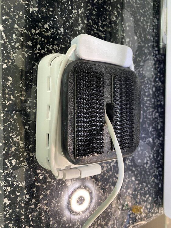

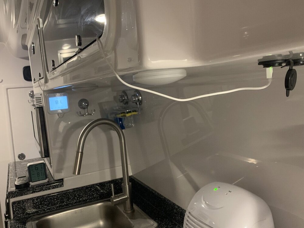

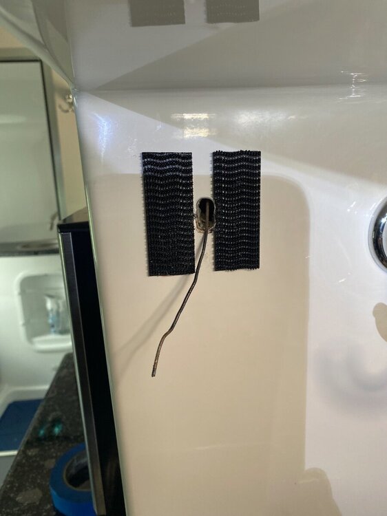

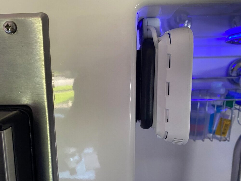

Ronbrink Posted May 30, 2025 Author Posted May 30, 2025 (edited) 13 hours ago, rideadeuce said: … now, where to place it? USB power makes things interesting. The Cielo has to be positioned for line-of-sight with the Atmos controls in the air distribution panel. And yes, an AC outlet or USB port is needed in close proximity; however it is equipped for hardwiring. When learning how to use the Cielo, I sat at the dinette and plugged into an AC outlet via the supplied 5V adapter; the supplied base stand for flat surface staging was also used. Being a wall-mount is best securement in a rolling earthquake, I first tried it on the forward bulkhead to the upper left of the wet bath door, but didn’t like the cord dangling down the wall and it seemed a bit less responsive due to the distance. I then placed it between the two curbside upper cabinets near the under cabinet USB ports above the cooktop, but the 90° orientation didn’t work as well and there would be concerns of rising heat if cooking. Finally I placed it as shown in the pic, whereby the cord runs in and out of the galley cabinet and plugs into said USB port. I used Velcro for the mount, and may eventually hardwire the Cielo through that upper cabinet and tap into the wiring within the access screw port for a cleaner installation. As positioned, the Cielo is in clear view from bed, and I like that the backlight is dimmable or can be turned off. Edited May 30, 2025 by Ronbrink 1 Ron and Brooxie | Clear Lake (Houston), Texas 2020 OLEll, Twin, 579: No installed solar, dual 30# propane tanks w/GasStop safety devices, Renogy 40A DC-DC charger, 460Ah LFP battery bank/Victron SmartShunt, auxiliary Cerbo-S GX/Victron 30A Blue Smart IP22 Charger combo, interior mounted Hughes Autoformer, twin independent sliding Lagun mount tables, extended dinette table and pantry landing, tongue-mounted hoist, Beech Lane refrigerator Ventilation/Evaporate Coil fans, metal valve stems with TST cap sensors and signal repeater, Waste Master sewer hose management system, Dreiha Atmos 4.4 A/C upgrade/Ceilo Breez Max thermostat, FlagpoleBuddy Starlink Mini suction mount kit. 2019 GMC Savana 2500 Cargo Work Van: Explorer Limited SE, Low-Top 7 Passenger van conversion, 6.0L V8 Vortec, 6-Speed Automatic, RWD; Air-Lift LoadLifter air suspension/WirelessAir compressor; Bilstein B6 4600 Series shocks; metal valve stems for TST tire pressure monitoring system; Buyers Products cargo containment boxes/DC Cargo securement system; rear bumper DC-DC Anderson power cable outlet; 100Ah 12V portable power station/Dometic CFX 75L Dual Zone cooler; front 2” receiver hitch/QuikrStuff Mach2 double bike rack; Mechman 320A high output alternator; Starlink Mini/Veritas Vans magnetic mount.

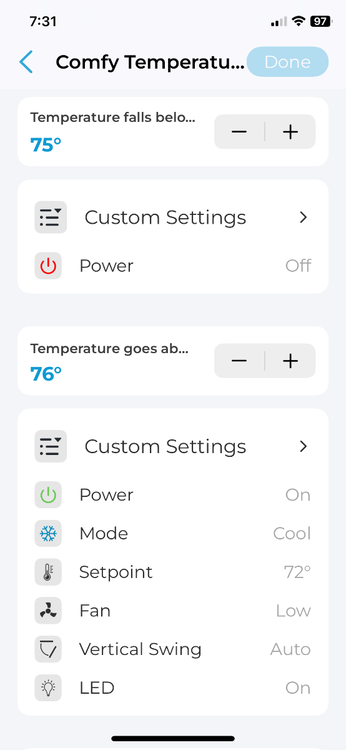

Ronbrink Posted June 2, 2025 Author Posted June 2, 2025 (edited) On 5/29/2025 at 5:36 PM, Ronbrink said: Selecting the proper temp setpoint will determine if the fan or compressor runs longer at shutdown. I will address that another time. The following has been found beneficial in ‘Setpoint’ selection in Comfy Mode, but may be applicable with use of Comfy Max Mode, as well; TBD. It is important to know that a setpoint one or two degrees below the upper range of temperature selected will have the fan run more than the compressor prior to power shutdown; whereas a setpoint of three or four degrees will have the fan and compressor turn off in sync, and the outside blower fan runs a half minute or so before total shutdown of the unit. Here’s a screenshot of the Custom Settings for my ‘Day’ Comfy temperature range. Although I have the Vertical Swing set to Auto, there are nine other positions to choose. Once the Atmos is running in a Comfy Mode, the Swing can be temporarily changed. I find this useful when sitting or lying in bed (head at rear) and don’t want the cold air oscillating downward onto me. Pos 1 can be selected to set the Swing to blow straight out. The Fan speed can also be changed, as well. These interim changes will revert back to the original settings next use. Edited June 2, 2025 by Ronbrink 1 Ron and Brooxie | Clear Lake (Houston), Texas 2020 OLEll, Twin, 579: No installed solar, dual 30# propane tanks w/GasStop safety devices, Renogy 40A DC-DC charger, 460Ah LFP battery bank/Victron SmartShunt, auxiliary Cerbo-S GX/Victron 30A Blue Smart IP22 Charger combo, interior mounted Hughes Autoformer, twin independent sliding Lagun mount tables, extended dinette table and pantry landing, tongue-mounted hoist, Beech Lane refrigerator Ventilation/Evaporate Coil fans, metal valve stems with TST cap sensors and signal repeater, Waste Master sewer hose management system, Dreiha Atmos 4.4 A/C upgrade/Ceilo Breez Max thermostat, FlagpoleBuddy Starlink Mini suction mount kit. 2019 GMC Savana 2500 Cargo Work Van: Explorer Limited SE, Low-Top 7 Passenger van conversion, 6.0L V8 Vortec, 6-Speed Automatic, RWD; Air-Lift LoadLifter air suspension/WirelessAir compressor; Bilstein B6 4600 Series shocks; metal valve stems for TST tire pressure monitoring system; Buyers Products cargo containment boxes/DC Cargo securement system; rear bumper DC-DC Anderson power cable outlet; 100Ah 12V portable power station/Dometic CFX 75L Dual Zone cooler; front 2” receiver hitch/QuikrStuff Mach2 double bike rack; Mechman 320A high output alternator; Starlink Mini/Veritas Vans magnetic mount.
Ronbrink Posted June 16, 2025 Author Posted June 16, 2025 (edited) Here’s some observations in using the Cielo Breez Max phone app, the phone’s Bluetooth must be turned on to pair the device and Wi-Fi is initially required to operate the A/C via the app. Once the A/C is powered up and set to run at a desired mode of operation and Wi-Fi is discontinued, the A\C will continue to run as set, but changes cannot be made. However, to make changes or when it comes time to turn off the A/C Wi-Fi is once again needed. I know this based on my experience a couple weeks ago, wherein I started the A/C using the phone app while at my house in order to run the Atmos via the inverter while in transit to the COW Barn for storage. Once stowed and ready to leave, I was unable to turn off the Atmos and found it necessary to use my wife’s cell hotspot in order to do so. Fast forward to yesterday, when I activated a recently acquired Starlink Mini and went back to the COW Barn to check on the Oliver and perform some tests. To no surprise, the SLM worked flawlessly, as well as the Cielo/Almos. It wasn’t a terribly hot day for Texas due to pending inclement weather, outside temp was 88°/relative humidity 77%; the Oliver registered 89°/72%. Yep, the dehumidifier was shutdown with a full reservoir and thus, the high humidity condition within! Not to worry, the SLM/Cielo phone app started and ran the Atmos for 45 minutes, at which time it powered off on Comfy Mode at the set temp of 75°/humidity was 45%. In approximately 20 minutes, the Atmos turned back on when the temp rose to 77°/humidity was 47%. It then ran 17 minutes before total shutdown again, humidity was 45%; no humidity spike whatsoever, YAHOO! Loving the Cielo Breez Max and the SLM is proving to be a worthy addition as well, as many of you already know. Hopefully other owners will try out the Cielo Breez Max on their respective A/Cs, and report on subsequent findings and experiences. Edited October 9, 2025 by Ronbrink 3 Ron and Brooxie | Clear Lake (Houston), Texas 2020 OLEll, Twin, 579: No installed solar, dual 30# propane tanks w/GasStop safety devices, Renogy 40A DC-DC charger, 460Ah LFP battery bank/Victron SmartShunt, auxiliary Cerbo-S GX/Victron 30A Blue Smart IP22 Charger combo, interior mounted Hughes Autoformer, twin independent sliding Lagun mount tables, extended dinette table and pantry landing, tongue-mounted hoist, Beech Lane refrigerator Ventilation/Evaporate Coil fans, metal valve stems with TST cap sensors and signal repeater, Waste Master sewer hose management system, Dreiha Atmos 4.4 A/C upgrade/Ceilo Breez Max thermostat, FlagpoleBuddy Starlink Mini suction mount kit. 2019 GMC Savana 2500 Cargo Work Van: Explorer Limited SE, Low-Top 7 Passenger van conversion, 6.0L V8 Vortec, 6-Speed Automatic, RWD; Air-Lift LoadLifter air suspension/WirelessAir compressor; Bilstein B6 4600 Series shocks; metal valve stems for TST tire pressure monitoring system; Buyers Products cargo containment boxes/DC Cargo securement system; rear bumper DC-DC Anderson power cable outlet; 100Ah 12V portable power station/Dometic CFX 75L Dual Zone cooler; front 2” receiver hitch/QuikrStuff Mach2 double bike rack; Mechman 320A high output alternator; Starlink Mini/Veritas Vans magnetic mount.

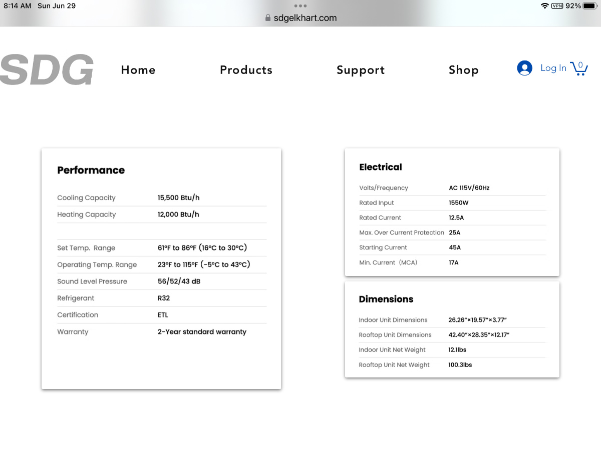

Ronbrink Posted June 29, 2025 Author Posted June 29, 2025 (edited) 14 hours ago, jd1923 said: There is a question that I do not believe has been verified. Tosot a year ago was using R-134a refrigerant. Are they now using the more efficient R-32? Anybody getting one should know this ahead of ordering. Ron can confirm, but I'm pretty sure his and other Atmos use R-32 refrigerant. Here is a screen shot of the Tosot specs from SDG’s website: And yes, the Atmos 4.4 has the R32 refrigerant. NOTE: The above shows a 15,500 BTU cooling capacity for the Tosot, which is higher than the published 15,000 rating for the Atmos. Makes me wonder! Edited June 29, 2025 by Ronbrink Ron and Brooxie | Clear Lake (Houston), Texas 2020 OLEll, Twin, 579: No installed solar, dual 30# propane tanks w/GasStop safety devices, Renogy 40A DC-DC charger, 460Ah LFP battery bank/Victron SmartShunt, auxiliary Cerbo-S GX/Victron 30A Blue Smart IP22 Charger combo, interior mounted Hughes Autoformer, twin independent sliding Lagun mount tables, extended dinette table and pantry landing, tongue-mounted hoist, Beech Lane refrigerator Ventilation/Evaporate Coil fans, metal valve stems with TST cap sensors and signal repeater, Waste Master sewer hose management system, Dreiha Atmos 4.4 A/C upgrade/Ceilo Breez Max thermostat, FlagpoleBuddy Starlink Mini suction mount kit. 2019 GMC Savana 2500 Cargo Work Van: Explorer Limited SE, Low-Top 7 Passenger van conversion, 6.0L V8 Vortec, 6-Speed Automatic, RWD; Air-Lift LoadLifter air suspension/WirelessAir compressor; Bilstein B6 4600 Series shocks; metal valve stems for TST tire pressure monitoring system; Buyers Products cargo containment boxes/DC Cargo securement system; rear bumper DC-DC Anderson power cable outlet; 100Ah 12V portable power station/Dometic CFX 75L Dual Zone cooler; front 2” receiver hitch/QuikrStuff Mach2 double bike rack; Mechman 320A high output alternator; Starlink Mini/Veritas Vans magnetic mount.
jd1923 Posted June 29, 2025 Posted June 29, 2025 (edited) 1 hour ago, Ronbrink said: NOTE: The above shows a 15,500 BTU cooling capacity for the Tosot, which is higher than the published 15,000 rating for the Atmos. Makes me wonder! We must be skeptical of specs on websites. Check the product label. Likely the R32 is correct and the 15.5K BTU is incorrect, 15K instead. i had ordered Epoch Essentials 460Ah batteries and if the website was accurate 2 would have fit in the Oliver battery bay with the tray removed. The website had width and height numbers reversed. Called Epoch and they could not confirm but the distributor did and they changed my order for two 300Ah which fit in the tray. Often bad data on websites. So much on auto parts websites for sure! Edited June 29, 2025 by jd1923 1 Chris & John in Prescott, AZ | 2016 EII #113 | '01 Ram 2500 Cummins!

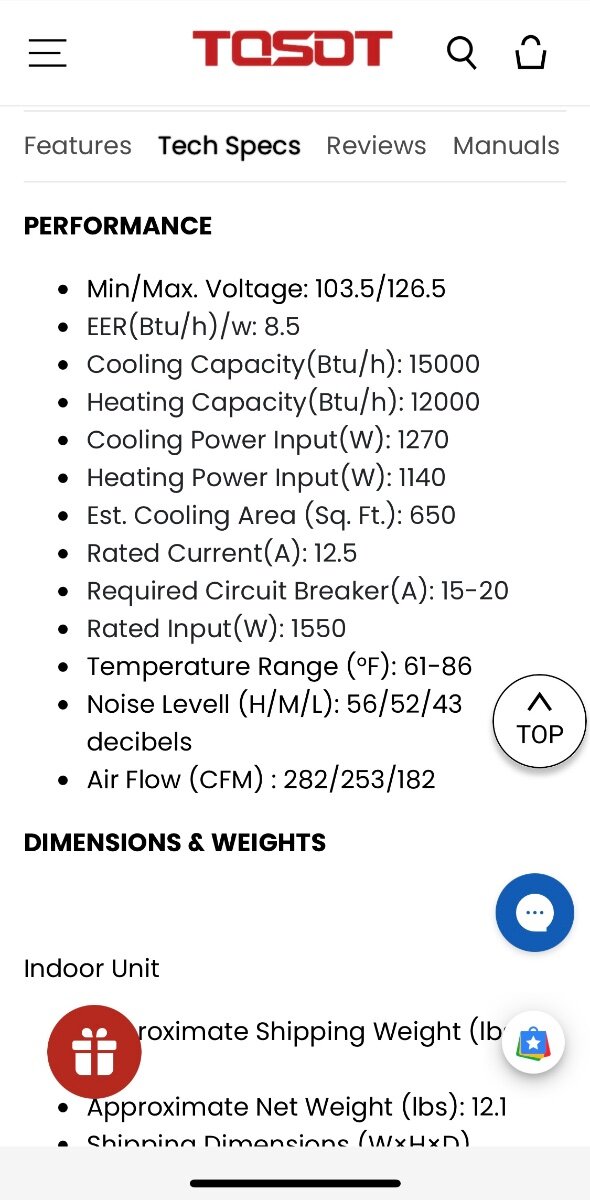

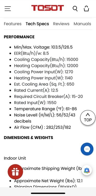

mountainoliver Posted June 29, 2025 Posted June 29, 2025 Here’s a screen shot directly from the Tosot website: 1 2017 Elite II, Hull #208 2019 Chevy HD 2500 Duramax
Ronbrink Posted June 30, 2025 Author Posted June 30, 2025 19 hours ago, mountainoliver said: Here’s a screen shot directly from the Tosot website: I remain skeptical that the Tosot and Atmos are exactly the same units. I have seen CFM ratings of 400-450 for the Atmos, and as you and JD witnessed my hair was blowing while standing in front of the bath mirrored door. The Air Flow shown for the Tosot is more comparable to that of the former DPll. There are other spec discrepancies, as well. 1 Ron and Brooxie | Clear Lake (Houston), Texas 2020 OLEll, Twin, 579: No installed solar, dual 30# propane tanks w/GasStop safety devices, Renogy 40A DC-DC charger, 460Ah LFP battery bank/Victron SmartShunt, auxiliary Cerbo-S GX/Victron 30A Blue Smart IP22 Charger combo, interior mounted Hughes Autoformer, twin independent sliding Lagun mount tables, extended dinette table and pantry landing, tongue-mounted hoist, Beech Lane refrigerator Ventilation/Evaporate Coil fans, metal valve stems with TST cap sensors and signal repeater, Waste Master sewer hose management system, Dreiha Atmos 4.4 A/C upgrade/Ceilo Breez Max thermostat, FlagpoleBuddy Starlink Mini suction mount kit. 2019 GMC Savana 2500 Cargo Work Van: Explorer Limited SE, Low-Top 7 Passenger van conversion, 6.0L V8 Vortec, 6-Speed Automatic, RWD; Air-Lift LoadLifter air suspension/WirelessAir compressor; Bilstein B6 4600 Series shocks; metal valve stems for TST tire pressure monitoring system; Buyers Products cargo containment boxes/DC Cargo securement system; rear bumper DC-DC Anderson power cable outlet; 100Ah 12V portable power station/Dometic CFX 75L Dual Zone cooler; front 2” receiver hitch/QuikrStuff Mach2 double bike rack; Mechman 320A high output alternator; Starlink Mini/Veritas Vans magnetic mount.
jd1923 Posted June 30, 2025 Posted June 30, 2025 2 hours ago, Ronbrink said: I remain skeptical that the Tosot and Atmos are exactly the same units. Kevin should know as soon as SDG has installed a few Tosot units. 1 Chris & John in Prescott, AZ | 2016 EII #113 | '01 Ram 2500 Cummins!
Ronbrink Posted June 30, 2025 Author Posted June 30, 2025 7 minutes ago, jd1923 said: Kevin should know as soon as SDG has installed a few Tosot units. Indeed, we heard a lot at the beginning with his Atmos installs. I will continue to monitor other forums and report on any testimony’s or findings. 1 Ron and Brooxie | Clear Lake (Houston), Texas 2020 OLEll, Twin, 579: No installed solar, dual 30# propane tanks w/GasStop safety devices, Renogy 40A DC-DC charger, 460Ah LFP battery bank/Victron SmartShunt, auxiliary Cerbo-S GX/Victron 30A Blue Smart IP22 Charger combo, interior mounted Hughes Autoformer, twin independent sliding Lagun mount tables, extended dinette table and pantry landing, tongue-mounted hoist, Beech Lane refrigerator Ventilation/Evaporate Coil fans, metal valve stems with TST cap sensors and signal repeater, Waste Master sewer hose management system, Dreiha Atmos 4.4 A/C upgrade/Ceilo Breez Max thermostat, FlagpoleBuddy Starlink Mini suction mount kit. 2019 GMC Savana 2500 Cargo Work Van: Explorer Limited SE, Low-Top 7 Passenger van conversion, 6.0L V8 Vortec, 6-Speed Automatic, RWD; Air-Lift LoadLifter air suspension/WirelessAir compressor; Bilstein B6 4600 Series shocks; metal valve stems for TST tire pressure monitoring system; Buyers Products cargo containment boxes/DC Cargo securement system; rear bumper DC-DC Anderson power cable outlet; 100Ah 12V portable power station/Dometic CFX 75L Dual Zone cooler; front 2” receiver hitch/QuikrStuff Mach2 double bike rack; Mechman 320A high output alternator; Starlink Mini/Veritas Vans magnetic mount.
jd1923 Posted June 30, 2025 Posted June 30, 2025 8 hours ago, Ronbrink said: I remain skeptical that the Tosot and Atmos are exactly the same units. I have seen CFM ratings of 400-450 for the Atmos, and as you and JD witnessed my hair was blowing while standing in front of the bath mirrored door. The Air Flow shown for the Tosot is more comparable to that of the former DPll. There are other spec discrepancies, as well. My feeling is Atmos was designed in Germany and the company made the mistake of manufacturing their product in China, where the copied the design and rebadged Knock-offs as Tosot and other names we’ve seen. This happened to ALL the technology patents that Motorola had, witnessed while I was there during the 90s. One of the reasons Motorola finally closed in 2011 (Motorola trademark purchased by the Chinese computer company Lenovo)! Question remains is are they quality knock-offs? SDG must be getting better wholesale pricing on the Tosot brand. Hopefully they made the decision knowing that it is at least comparable quality. If not, they will have future service and warranty issues. 1 Chris & John in Prescott, AZ | 2016 EII #113 | '01 Ram 2500 Cummins!
