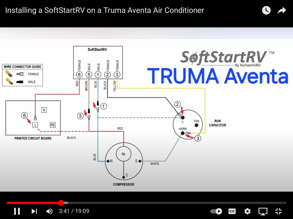

Ronbrink Posted October 20, 2024 Posted October 20, 2024 21 hours ago, Rolind said: I have been holding off on the soft start hoping a DIY option becomes available in the future. This may be of interest to Truma a/c owners, illustrates how the SoftStartRV is installed. 1 Ron and Brooxie | Clear Lake (Houston), Texas 2020 OLEll, Twin, 579: No installed solar, dual 30# propane tanks w/GasStop safety devices, Renogy 40A DC-DC charger, 460Ah LFP battery bank/Victron SmartShunt, auxiliary Cerbo-S GX/Victron 30A Blue Smart IP22 Charger combo, interior mounted Hughes Autoformer, twin independent sliding Lagun mount tables, extended dinette table and pantry landing, tongue-mounted hoist, Beech Lane refrigerator Ventilation/Evaporate Coil fans, metal valve stems with TST cap sensors and signal repeater, Waste Master sewer hose management system, Dreiha Atmos 4.4 A/C upgrade/Ceilo Breez Max thermostat, FlagpoleBuddy Starlink Mini suction mount kit. 2019 GMC Savana 2500 Cargo Work Van: Explorer Limited SE, Low-Top 7 Passenger van conversion, 6.0L V8 Vortec, 6-Speed Automatic, RWD; Air-Lift LoadLifter air suspension/WirelessAir compressor; Bilstein B6 4600 Series shocks; metal valve stems for TST tire pressure monitoring system; Buyers Products cargo containment boxes/DC Cargo securement system; rear bumper DC-DC Anderson power cable outlet; 100Ah 12V portable power station/Dometic CFX 75L Dual Zone cooler; front 2” receiver hitch/QuikrStuff Mach2 double bike rack; Mechman 320A high output alternator; Starlink Mini/Veritas Vans magnetic mount.
Rolind Posted October 20, 2024 Posted October 20, 2024 Thanks so much for the heads up. Looks like a great winter project for my list. Robert and Cheryl, Louisville, KY, Legacy Elite II 2023 Hull #1390 Oliphino, TV F250 Tremor

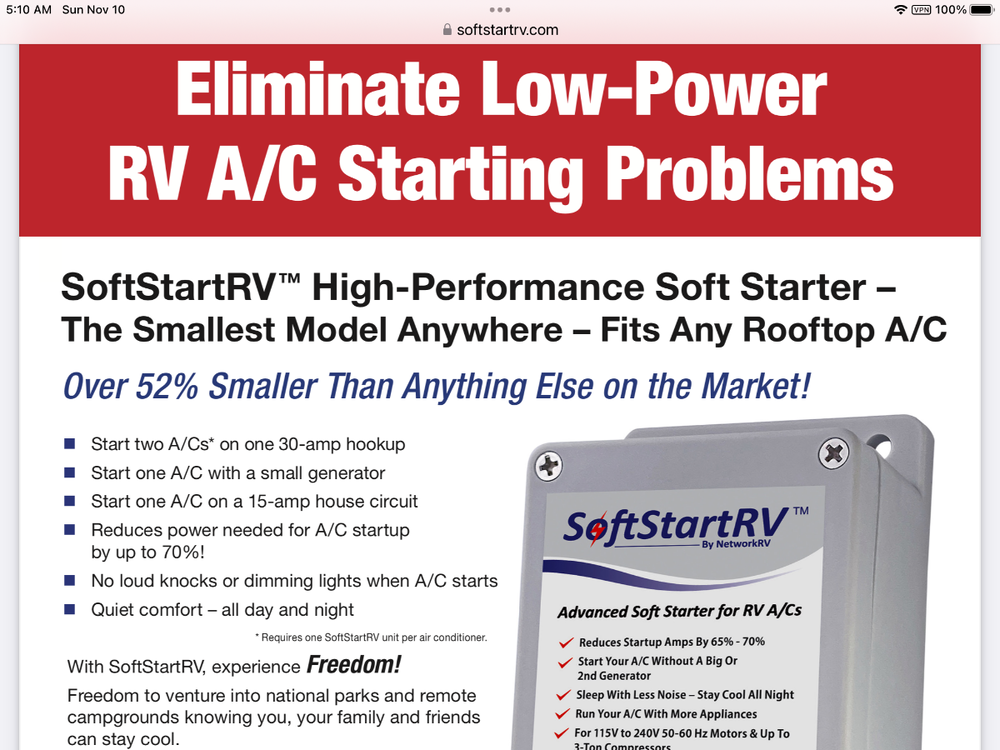

jd1923 Posted November 10, 2024 Posted November 10, 2024 On 10/20/2024 at 4:34 AM, Ronbrink said: This may be of interest to Truma a/c owners, illustrates how the SoftStartRV is installed. Can this item be purchased? My understanding is that only Truma can install their parts, not sold in the aftermarket. I observed the Truma service van install 8 of these during the recent Texas Rally. Chris & John in Prescott, AZ | 2016 EII #113 | '01 Ram 2500 Cummins!
Ronbrink Posted November 10, 2024 Posted November 10, 2024 7 hours ago, jd1923 said: Can this item be purchased? My understanding is that only Truma can install their parts, not sold in the aftermarket. I observed the Truma service van install 8 of these during the recent Texas Rally. SoftStartRV units are readily available and claim universal fit, see attached. They can be purchased and self-installed on a Truma, but It is possible such could void their warranty. Perhaps someone in the know will chime in with a definitive answer. Ron and Brooxie | Clear Lake (Houston), Texas 2020 OLEll, Twin, 579: No installed solar, dual 30# propane tanks w/GasStop safety devices, Renogy 40A DC-DC charger, 460Ah LFP battery bank/Victron SmartShunt, auxiliary Cerbo-S GX/Victron 30A Blue Smart IP22 Charger combo, interior mounted Hughes Autoformer, twin independent sliding Lagun mount tables, extended dinette table and pantry landing, tongue-mounted hoist, Beech Lane refrigerator Ventilation/Evaporate Coil fans, metal valve stems with TST cap sensors and signal repeater, Waste Master sewer hose management system, Dreiha Atmos 4.4 A/C upgrade/Ceilo Breez Max thermostat, FlagpoleBuddy Starlink Mini suction mount kit. 2019 GMC Savana 2500 Cargo Work Van: Explorer Limited SE, Low-Top 7 Passenger van conversion, 6.0L V8 Vortec, 6-Speed Automatic, RWD; Air-Lift LoadLifter air suspension/WirelessAir compressor; Bilstein B6 4600 Series shocks; metal valve stems for TST tire pressure monitoring system; Buyers Products cargo containment boxes/DC Cargo securement system; rear bumper DC-DC Anderson power cable outlet; 100Ah 12V portable power station/Dometic CFX 75L Dual Zone cooler; front 2” receiver hitch/QuikrStuff Mach2 double bike rack; Mechman 320A high output alternator; Starlink Mini/Veritas Vans magnetic mount.

jd1923 Posted November 10, 2024 Posted November 10, 2024 4 hours ago, Ronbrink said: SoftStartRV units are readily available For sure, though not sure what brand device Truma installs and I believe home installation voids the Truma warranty. What I’ve read here is that Truma brand parts cannot be purchased without Truma service. So for me, this eliminates Truma products from consideration. Also, there is no Truma and no OTT dealers in the state of Arizona. Two strong reasons. 1 Chris & John in Prescott, AZ | 2016 EII #113 | '01 Ram 2500 Cummins!
