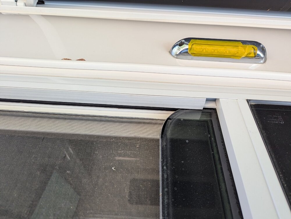

John Dorrer Posted October 27, 2024 Posted October 27, 2024 I can't find anything on this topic on the Forum. I have tried window seal, window gasket, window seal gasket, etc Our gasket has shrunk close to an inch at the top. Some have replaced it in black. Who is the source for white or black gasket? What is the product #? John & Susan Dorrer, 2013 F250, 6.2 gasser, 4x4, 2022 Legacy Elite 2, twin beds, Hull #1045, Jolli Olli -

jd1923 Posted October 28, 2024 Posted October 28, 2024 John @John Dorrer, when you install yours cut each length about 1 1/2” longer than the original piece you remove. This makes up for the shrinkage you have and the shrinkage that will occur to.the new rubber. Start at the bottom and push hard to compact the rubber to make room for the extra length. Be firm and patient. If some end up a little too long you can always cut a little off but you can’t add length. A hose cutting tool works well as it is hard to use a razor/box cutter when the piece is in place and it cuts square. https://a.co/d/gNDM9QE 1 Chris & John in Prescott, AZ | 2016 EII #113 | '01 Ram 2500 Cummins!
Patriot Posted October 28, 2024 Posted October 28, 2024 @John Dorrer here is what I used. It worked perfect and only $8. https://www.harborfreight.com/finger-release-ratcheting-pvc-pipe-cutter-62588.html 1 4 2020 OLEII - Hull #634 aka- “XPLOR” 2021 F350 6.7 liter Diesel Lariat Ultimate Tremor aka - “Beast of Burden” Truma Aventa 13.5 AC, Alcan 5 leaf pack, Alcan HD shackles & HD wet bolts, 5200lb never lube axles.XPEL 10 mil PPF front both front corners, 30 lb LP tanks, Sea Biscuit Front Cargo Storage box. ⚡️⚡️11/2025- Lithium upgrade to XPLOR - (2) Epoch 300ah Lithium batteries, Victron 3000W MultiPlus-II, Victron GX Touch 70, Victron Cerbo GX, Victron Smart Solar MPPT, Victron Smart Shunt, Victron Orion XS 1400 DC-DC charger, RV Soft Start. Zamp 90W suit case solar panel for 420W of solar.⚡️⚡️ North Carolina

John Dorrer Posted June 15, 2025 Author Posted June 15, 2025 Sorry guys. I forgot to post back up I replaced with the black and left an additional 3/4"-1" to push in. The cutters Patriot shared the link on were awesome. I did the work prior to the Rally. 1 3 John & Susan Dorrer, 2013 F250, 6.2 gasser, 4x4, 2022 Legacy Elite 2, twin beds, Hull #1045, Jolli Olli -
