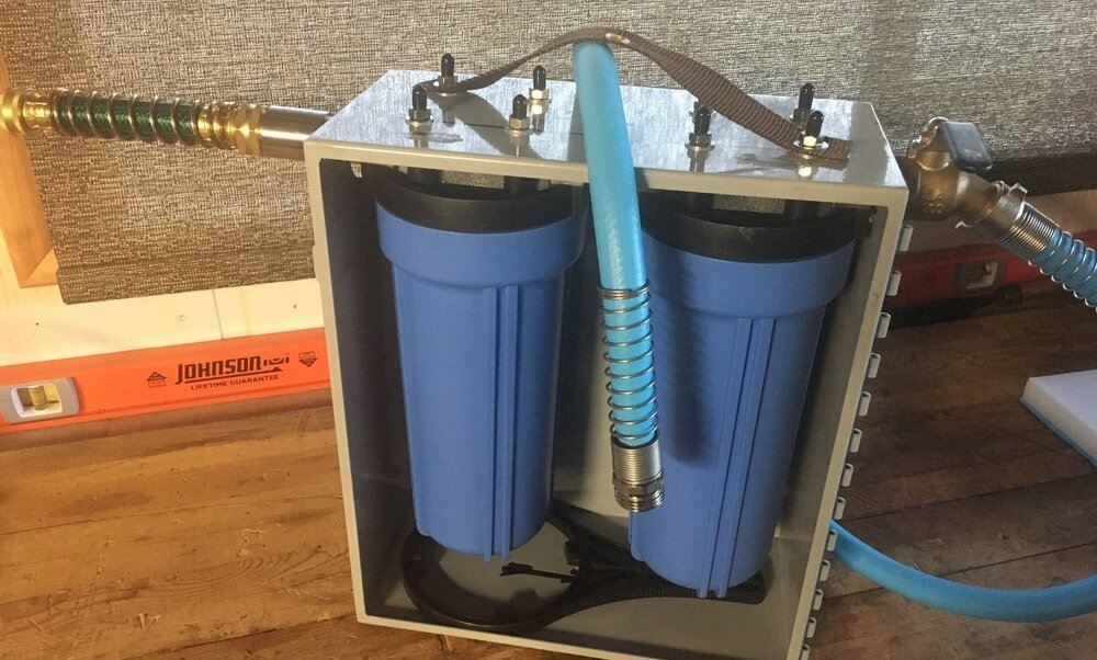

We use a two-stage filter like this, but I made one myself using their parts and filters, but way cheaper than buying the complete system: https://www.clearsourcerv.com/products/clearsource-premier-mini-rv-water-filter-system

I was thinking of building in water filtration there but after advice from @SeaDawg I went with a portable unit that I use when filling our tanks. First pic shows the idea and the second pic shows what I ended up with. I used Clear Source filters and housings. Their parts are cheaper compared to their $400+ RV filter systems. This was intended for better bath and kitchen water on the road. We do not drink the stored water.
Edited by jd1923
Any system is only as good as the replacement filters that you buy

@SeaDawg - indeed - quality filters make (or break) the filtration system. The four R/O systems I’ve installed over the years have all had three pre-filters - primarily sediment/particulate filters, the R/O element, and a final carbon filter. Because I’ve been installing these systems in locations with “good” water - treated, “city” water systems. No wells, no questionable/untested sources, and they’ve all been low-volume use (drinking & cooking water only) Filter replacements are few and far between. Literally years before a filter change is needed. Last two R/O systems I bought had a set of replacement filters included.

All great info.  Thank you.
A few reminders for what ever system you choose:
  • Be sure to locate it where you can reasonably easily get to the filters for change out and winterization.
  • For sanitization of the water system you do not want to send the sanitization fluid (Likely Bleach and Water) through your water purification system.
Having a bypass valve and easy service are good ideas the freeze protection perspective.
GJ
GJ
Will prolly just set it up so that it tees into the “city water” line with a shut/off so the whole she/bang can be pulled out and taken indoors.
If one doesn’t look at ALL the information on winterizing, they wouldn’t know about flushing the city water and fresh water tank fill lines, nor the San-T-flush lines. I hadn’t been doing that. -Luckily- where our camper lives during the winter rately freezes. Like I said - lucky.
Yes, good idea. You could mount the RO system to a metal stand that is small enough to slide into the rear basement/trunk area with quick disconnects to the water line. You are certainly hung up on that City Water line, so keep in mind you would not have RO water when taking a lunch break on the road and of course not when dry camping or whenever not connected to a hose.
Personally, I could not fathom living fulltime in an Oliver ALWAYS requiring hookups. Last trip out, I left our water tanks empty thinking there was good water at our first campsite. Wanted to use the toilet and wash up during a rest stop and we couldn't. First and last time we ever leave home without our fresh tank full, HWH full and all plumbing lines primed!
Many of us think of the four (4) water lines that need to be free of water when below freezing (City Water, Fresh Water, Boondocking inlet and Black tank rinse). One reason I use compressed air vs. the nasty pink stuff. This is my procedure. I added step 13 from input from another owner, but I've never used plumbing antifreeze anywhere in any RV. Plumbing P-traps can freeze without harm since they are not a contained system and can simply expand upwards when freezing, like making ice cubes in a tray.
Edited by jd1923
I think you’ve got a handle on that.
We generally don’t go more than 4 hours between camping stops.Its just our model. We don’t get fatigued or arrive after dark. So though we -have- had to stop for a toilet break once in a while - we try for highway rest stops - or the good old gas stations.
To save weight, we don’t tanker water or waste around in any tanks. We always dump tanks before leaving a campground. That, and we use the facilities at the campground for everything except midnight trips.  That said, there’s generally a gallon or two sloshing around in the FWT to flush the toilet if need be. If there’s not, urine still goes down. I think we’ve only put “solids” into the holding tank once or twice in three years. Never any paper.
With an R/O system with a tank, there’s always a tankful available for a drink of water or to make coffee or tea even between city water hookups.
The few times we camp without a city water hookup, I put a few gallons in the FWT before setting up. Haven’t been to a campground yet that doesn’t have a potable water tap.
We're not -really- “full time”. We do crash every couple of months with friends and relatives. That, and we store away our camper for 3-4 months a year for European travel and spending Christmas with family.
I don’t especially enjoy spending the $20 or $30 for the pink anti-freeze, but it’s cheaper than buying a pump, accumulator, or valves. Certainly less work than finding split pipes and fixing them. My dad used to “blow out” the lines on the old ‘73 mini motorhome - but it had a LOT simpler water system. I guess you’d need to make sure your air pressure stays below 50psi to avoid blowing out a line or damaging something.
