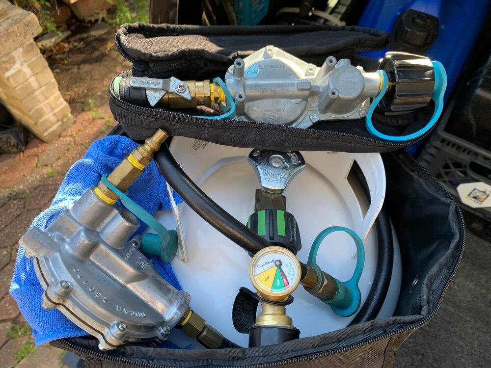

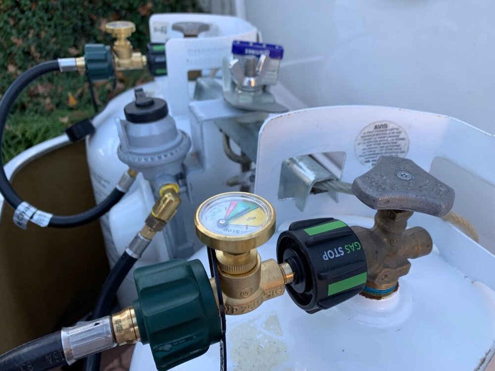

Ronbrink Posted March 5, 2025 Posted March 5, 2025 1 hour ago, Galileo said: Only had to do the purging of air using the cooktop once. I installed GasStop valves on each tank, which has an integral purging feature. Also great for use with gas grills, fire pits, etc., when auxiliary lines are connected to a spare tank or directly to one of the Oliver tanks 4 Ron and Brooxie | Clear Lake (Houston), Texas 2020 OLEll, Twin, 579: No installed solar, dual 30# propane tanks w/GasStop safety devices, Renogy 40A DC-DC charger, 460Ah LFP battery bank/Victron SmartShunt, auxiliary Cerbo-S GX/Victron 30A Blue Smart IP22 Charger combo, interior mounted Hughes Autoformer, twin independent sliding Lagun mount tables, extended dinette table and pantry landing, tongue-mounted hoist, Beech Lane refrigerator Ventilation/Evaporate Coil fans, metal valve stems with TST cap sensors and signal repeater, Waste Master sewer hose management system, Dreiha Atmos 4.4 A/C upgrade/Ceilo Breez Max thermostat, FlagpoleBuddy Starlink Mini suction mount kit. 2019 GMC Savana 2500 Cargo Work Van: Explorer Limited SE, Low-Top 7 Passenger van conversion, 6.0L V8 Vortec, 6-Speed Automatic, RWD; Air-Lift LoadLifter air suspension/WirelessAir compressor; Bilstein B6 4600 Series shocks; metal valve stems for TST tire pressure monitoring system; Buyers Products cargo containment boxes/DC Cargo securement system; rear bumper DC-DC Anderson power cable outlet; 100Ah 12V portable power station/Dometic CFX 75L Dual Zone cooler; front 2” receiver hitch/QuikrStuff Mach2 double bike rack; Mechman 320A high output alternator; Starlink Mini/Veritas Vans magnetic mount.
