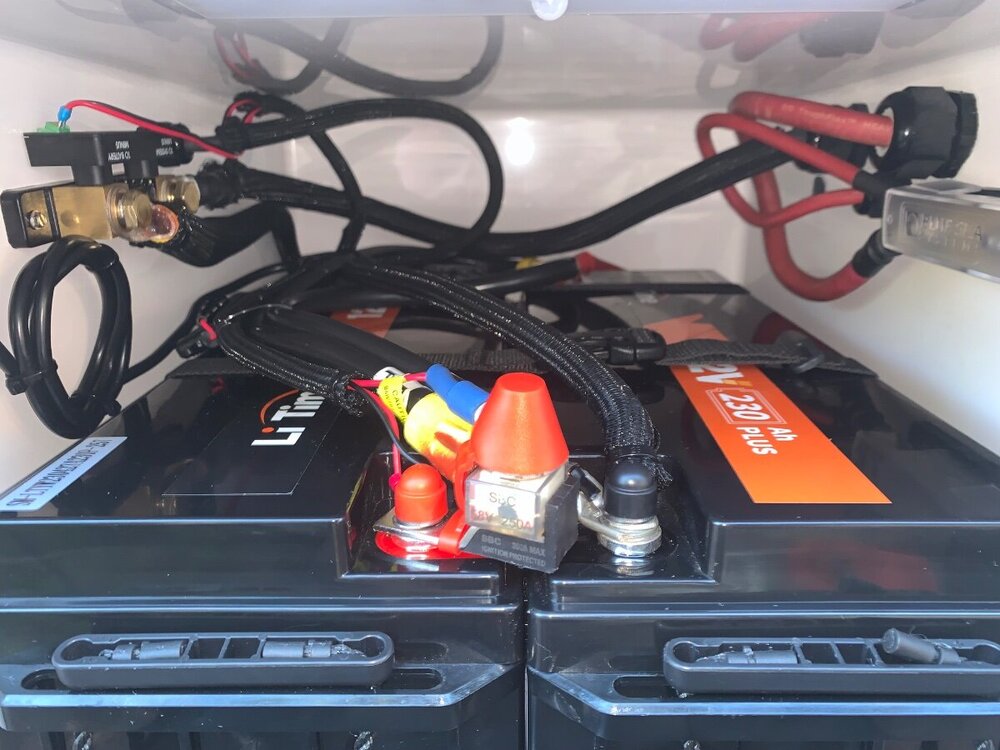

Ronbrink Posted March 25, 2025 Posted March 25, 2025 I replaced four 6V Trojans with two 12V 230Ah LiTime LFPs, a 158 lb. reduction in weight and double the usable amp hours. This was the cheaper alternative of the two options @jd1923 mentioned. Also shown is a Victron SmartShunt to the left and an ANL fuse holder to the right. 6 Ron and Brooxie | Clear Lake (Houston), Texas 2020 OLEll, Twin, 579: No installed solar, dual 30# propane tanks w/GasStop safety devices, Renogy 40A DC-DC charger, 460Ah LFP battery bank/Victron SmartShunt, auxiliary Cerbo-S GX/Victron 30A Blue Smart IP22 Charger combo, interior mounted Hughes Autoformer, twin independent sliding Lagun mount tables, extended dinette table and pantry landing, tongue-mounted hoist, Beech Lane refrigerator Ventilation/Evaporate Coil fans, metal valve stems with TST cap sensors and signal repeater, Waste Master sewer hose management system, Dreiha Atmos 4.4 A/C upgrade/Ceilo Breez Max thermostat, FlagpoleBuddy Starlink Mini suction mount kit. 2019 GMC Savana 2500 Cargo Work Van: Explorer Limited SE, Low-Top 7 Passenger van conversion, 6.0L V8 Vortec, 6-Speed Automatic, RWD; Air-Lift LoadLifter air suspension/WirelessAir compressor; Bilstein B6 4600 Series shocks; metal valve stems for TST tire pressure monitoring system; Buyers Products cargo containment boxes/DC Cargo securement system; rear bumper DC-DC Anderson power cable outlet; 100Ah 12V portable power station/Dometic CFX 75L Dual Zone cooler; front 2” receiver hitch/QuikrStuff Mach2 double bike rack; Mechman 320A high output alternator; Starlink Mini/Veritas Vans magnetic mount.

Teaney Hull 292 Posted March 25, 2025 Author Posted March 25, 2025 3 hours ago, Ronbrink said: I replaced four 6V Trojans with two 12V 230Ah LiTime LFPs, a 158 lb. reduction in weight and double the usable amp hours. This was the cheaper alternative of the two options @jd1923 mentioned. Also shown is a Victron SmartShunt to the left and an ANL fuse holder to the right. Great info Ron. Thanks 1 Gary and Anita Teaney and Ranger 2017 Oliver Elite II Hull 292 2018 Nissan Armada Tampa, FL

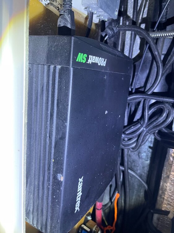

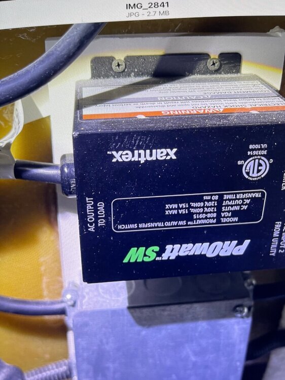

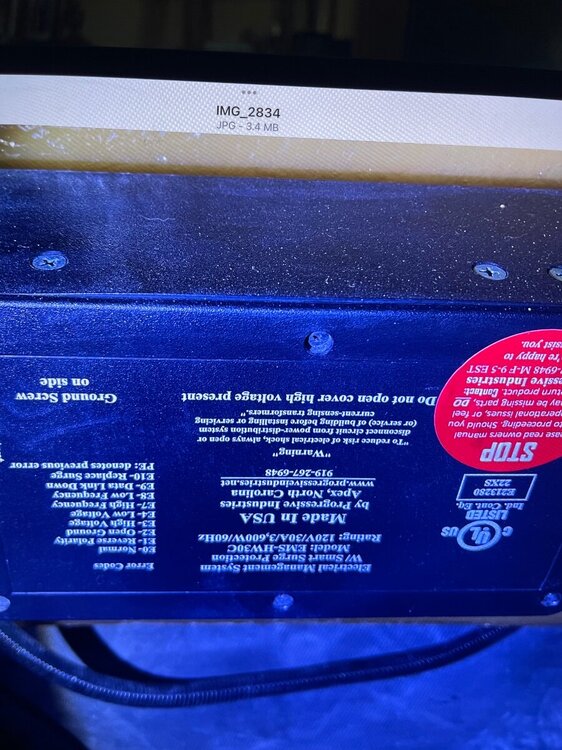

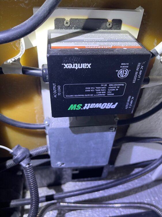

Galway Girl Posted March 25, 2025 Posted March 25, 2025 I assume in 2018 model, your xantrex is the INVERTER only function, and for 12V charging you're using the internal progressive dynamics charger (under the dinette seat). Some folks with the Progressive Dynamics charger see a jumper switch for charging lithium. The issue with that setting is it's not the "best" way to charge lithiums as it's simply a constant 14.6V voltage...not a ramped profile. The WIZ setting is a PROFILE for AGM or LEAD Acid. The LI Setting is just 14.6V (no ramp/no profile). Some battery manufacturers (including Lithionics) won't warrant their battery in presence of the constant 14.6V no profile setting. Whichever battery manufacturer you select, LI Time, Epoch, etc....be sure to check what they need as a charging profile. If a constant 14.6V works for them, then you might be able to a drop in maintaining your existing Inverter and existing charging system. I know that battle born did warranty their batteries with the Progressive Dynamics chargers. Also, there are new "Lithium compatible" plug in boards for progressive dynamics that now offer a lithium profile wizard. So just upgrading the charging board in your Progressive Dynamics energy center is a possibility. In our case (2019 model) we swapped out the Xantrex 2000W Inverter (only) for a newer Xantrex 2000 inverter charger before installing new Lithiums. My full upgrade article is here. This may be too much of an effort for what you want to accomplish. https://4-ever-hitched.com/ggs-blog/f/lithium-battery-upgrade?blogcategory=Electrical+Upgrades 7 2019 Elite II (Hull 505 - Galway Girl - August 7, 2019 Delivery) Tow Vehicle: 2021 F350 King Ranch, FX4, MaxTow Package, 10 Speed, 3.55 Rear Axle Batteries Upgrade: Dual 315GTX Lithionics Lithiums - 630AH Total Inverter/Charger: Xantrex 2000Pro Travel BLOG: https://4-ever-hitched.com Lower 48 + Alaska Achieved in Maine Aug 2024 on way to Nova Scotia.

Teaney Hull 292 Posted March 25, 2025 Author Posted March 25, 2025 5 hours ago, Galway Girl said: I assume in 2018 model, your xantrex is the INVERTER only function, and for 12V charging you're using the internal progressive dynamics charger (under the dinette seat). Some folks with the Progressive Dynamics charger see a jumper switch for charging lithium. The issue with that setting is it's not the "best" way to charge lithiums as it's simply a constant 14.6V voltage...not a ramped profile. The WIZ setting is a PROFILE for AGM or LEAD Acid. The LI Setting is just 14.6V (no ramp/no profile). Some battery manufacturers (including Lithionics) won't warrant their battery in presence of the constant 14.6V no profile setting. Whichever battery manufacturer you select, LI Time, Epoch, etc....be sure to check what they need as a charging profile. If a constant 14.6V works for them, then you might be able to a drop in maintaining your existing Inverter and existing charging system. I know that battle born did warranty their batteries with the Progressive Dynamics chargers. Also, there are new "Lithium compatible" plug in boards for progressive dynamics that now offer a lithium profile wizard. So just upgrading the charging board in your Progressive Dynamics energy center is a possibility. In our case (2019 model) we swapped out the Xantrex 2000W Inverter (only) for a newer Xantrex 2000 inverter charger before installing new Lithiums. My full upgrade article is here. This may be too much of an effort for what you want to accomplish. https://4-ever-hitched.com/ggs-blog/f/lithium-battery-upgrade?blogcategory=Electrical+Upgrades Wow, what’s a great job laying all the info out. I’m starting to realize doing this myself is way over my pay grade. Do you know if there any Oliver Owners who may be attending the rally that I could pay to do this, if I bought all the parts? I am a GREAT helper in times like this. Or, will the Mothership do this, or do I have to use all their parts. If so, do you know what they have charged in the past? 1 Gary and Anita Teaney and Ranger 2017 Oliver Elite II Hull 292 2018 Nissan Armada Tampa, FL

Teaney Hull 292 Posted March 26, 2025 Author Posted March 26, 2025 On 3/25/2025 at 10:42 AM, Galway Girl said: I assume in 2018 model, your xantrex is the INVERTER only function, and for 12V charging you're using the internal progressive dynamics charger (under the dinette seat). Some folks with the Progressive Dynamics charger see a jumper switch for charging lithium. The issue with that setting is it's not the "best" way to charge lithiums as it's simply a constant 14.6V voltage...not a ramped profile. The WIZ setting is a PROFILE for AGM or LEAD Acid. The LI Setting is just 14.6V (no ramp/no profile). Some battery manufacturers (including Lithionics) won't warrant their battery in presence of the constant 14.6V no profile setting. Whichever battery manufacturer you select, LI Time, Epoch, etc....be sure to check what they need as a charging profile. If a constant 14.6V works for them, then you might be able to a drop in maintaining your existing Inverter and existing charging system. I know that battle born did warranty their batteries with the Progressive Dynamics chargers. Also, there are new "Lithium compatible" plug in boards for progressive dynamics that now offer a lithium profile wizard. So just upgrading the charging board in your Progressive Dynamics energy center is a possibility. In our case (2019 model) we swapped out the Xantrex 2000W Inverter (only) for a newer Xantrex 2000 inverter charger before installing new Lithiums. My full upgrade article is here. This may be too much of an effort for what you want to accomplish. https://4-ever-hitched.com/ggs-blog/f/lithium-battery-upgrade?blogcategory=Electrical+Upgrades Wow. This is over my Pay grade… any idea what the mother ship would charge to upgrade to 3000 Xantrex and 3 140amp Lithium batteries? Gary and Anita Teaney and Ranger 2017 Oliver Elite II Hull 292 2018 Nissan Armada Tampa, FL
Galway Girl Posted March 26, 2025 Posted March 26, 2025 27 minutes ago, Teaney Hull 292 said: any idea what the mother ship would charge to upgrade to 3000 Xantrex and 3 140amp Lithium batteries? Gary, To help you get a range let's think of it like this: Option 1: Factory Upgrade: $10K + If you upgrade at the factory you can get an accurate quote by contacting service via email. My guess is around $10K to add 3 Lithionics batteries and a new 3000 Xantrex Inv/Charger. One reason for the high price is uprading to a new 3000 Xantrex Inverter Charger would also likely have them change around some wiring in your trailer to enable it to run your AC off of your new batteries. The other thing you discussed was a fridge replacement with a compressor fridge. Those are a very time consuming upgrade and costly. A real quote for time and cost can be had via email to Oliver Service. Option 2: Self Upgrade with help from friends: $1-2K About the lowest cost would be to drop in (1) Epoch Essentials 300AH Heated with Bluetooth battery for $999 (SKU: 12300A-H) and charge it with the existing charging circuits. You would likely be able to reuse all the big battery cables you have now. If you dropped in 2 (about $2K including cables) then you would have 600AH capacity about 3x what you have now...and that would enable you to switch to a new fridge. Hope that helps. Craig 7 2019 Elite II (Hull 505 - Galway Girl - August 7, 2019 Delivery) Tow Vehicle: 2021 F350 King Ranch, FX4, MaxTow Package, 10 Speed, 3.55 Rear Axle Batteries Upgrade: Dual 315GTX Lithionics Lithiums - 630AH Total Inverter/Charger: Xantrex 2000Pro Travel BLOG: https://4-ever-hitched.com Lower 48 + Alaska Achieved in Maine Aug 2024 on way to Nova Scotia.
jd1923 Posted March 26, 2025 Posted March 26, 2025 (edited) 3 hours ago, Galway Girl said: Option 2: Self Upgrade with help from friends: $1-2K Option 3: I mentioned before re a local solar company that works with Xantrex or better would be Victron. I spent about $3400 (parts, no labor) for the Victron 3KVA Multiplus II and two 300AH Epoch Essentials with new wiring, buses, etc. I spent MANY HOURS getting this all installed (and so has craig on all of his mods). Batteries are easy, new larger inverter is a custom install building a shelf, an overhaul of battery and 120VAC wiring, and more. Gary @Teaney Hull 292 you live in Tampa. There must be 100 custom solar installers and marine shops that work with Victron. Any local option would be better than OTT and OTT is very likely already book before, during and after the national rally. Edited March 26, 2025 by jd1923 2 Chris & John in Prescott, AZ | 2016 EII #113 | '01 Ram 2500 Cummins!
