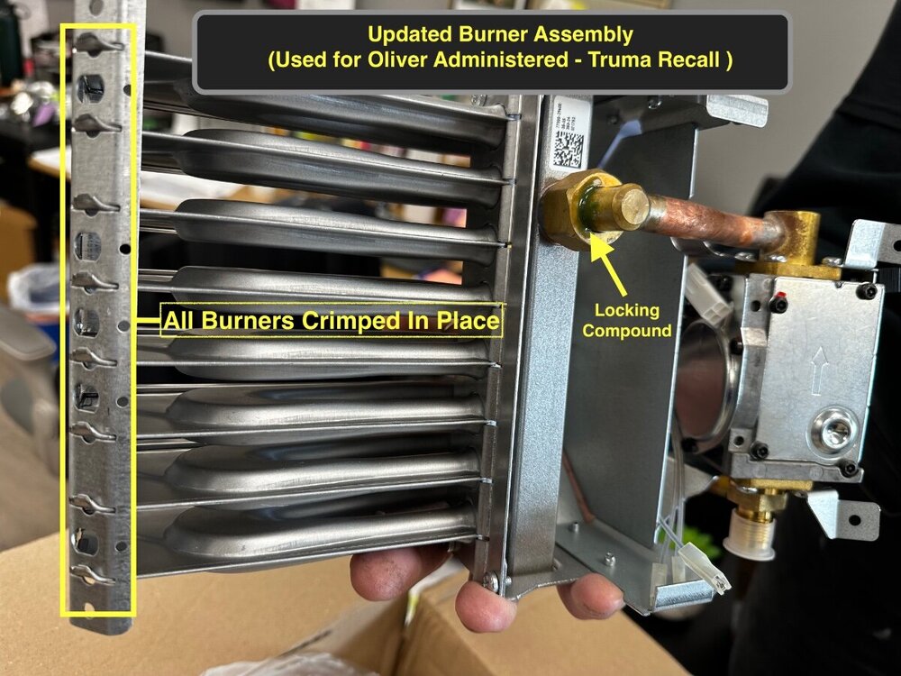

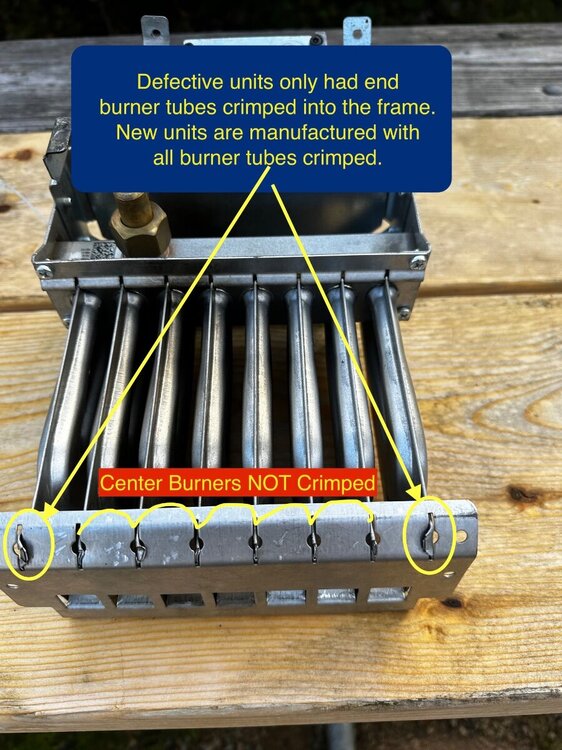

The issue addressed is that in older units from Truma the burner tubes could drop out of frame due to road vibration.  If that happens raw gas is injected into the burner area and cause faulty operation .
Edited by Galway Girl
added new burner pix

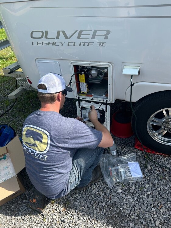

- David
New burner element installed in approx 20 min, system tested. Outstanding job Joel. Done!

Our new unit has the new crimped burners with the loc tight on the burner feed line coupler.
