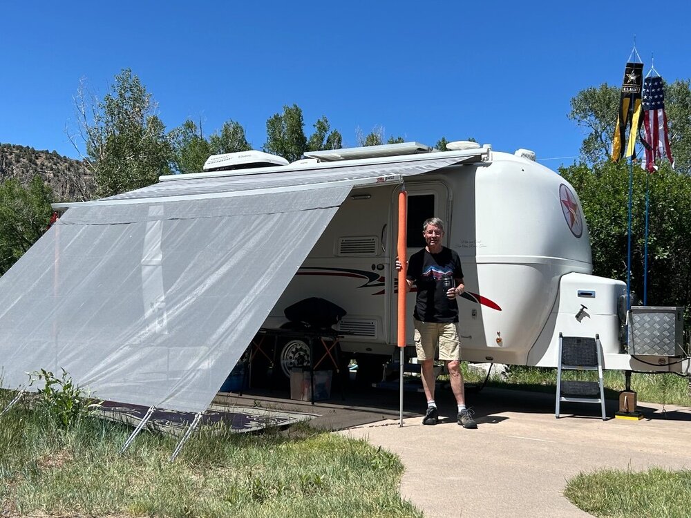

Yes, it does.  They can sit in brackets on the side of the trailer or you can drop them straight down to the ground.  You can also stake them to the ground which I have done.  With our sunshade attached the awning can withstand some pretty windy conditions.  It’s not as easy to deploy as the electrics, but is not really a hassle either.  Mike

A sunshade for an awning.  Wait a second.  I need one of those.  Is that specific to yours or is it a generic that can be used with any one of them.  Specifically, a Girard power awning like mine.  I wonder how that would work with the auto retract system?

It’s generic, we got it at Quartzsite at one of the booth vendors that are always set up selling RV stuff.  It slides into the rail on our awning (there are two).  The very top part has a zipper so you can drop the main part quickly if necessary.  The smaller top part also makes installing it pretty simple.

Aftermarket sunshade kits are readily available for a variety of awning makes and models. One would want to turn off the switched power with use on an auto retract unit.

Awesome. Definitely want the zipper style since my awning seems a bit flimsy in the wind.

I would definitely want to keep up with wind conditions since this would only increase the sail.

Right that! I’ve seen where support posts are placed at each corner of the awning (which manual awnings already have or variations thereof) and the bottom of the sunshade is anchored. Supposedly this makes for a more stable setup in windy conditions.
