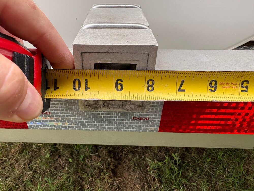

We are home and remeasured our Oliver rear-bumper hitch that will not allow the 1UP 2” bike rack to be inserted. It seems that the 2” Oliver hitch receiver is literally a hair’s width too snug. @Jason Foster, here are photos of our hitch and receiver. @Zodd@MAX Burner and @bugeyedriver, the anti-wobble bolt was not tightened, and the plain ole square end of the 1UP shank would not even begin to enter the receiver. It looked like it should, but was a teensy tiny bit too snug to allow entry.@rich.dev and @Mountainman198, it is, in fact, a 2” Oliver receiver. Perhaps it was a special request by the original owner??
So, with all that being said, do we dare file down the inside of the Oliver receiver… or the outside of the 1UP shank? By the way, the 1UP shank fits fine in our tow vehicle’s 2” receiver.
Suggestions, please.🙏

That is the new style 1 1/4 inch that is missing the interior. Someone tried to make it work but a true 2 inch reciever is 2 1/6 inches.
  • Wow 2
".. a true 2 inch receiver is 2 1/16 inches" - that's interesting!!!
Barb (and husband, Mark) in Estes Park, CO / Elite 2, Hull #941 / 2023 Toyota SequoiaAZARCOFLGAIDKSLAMSMOMTNMOKPASDTNTXUTVAWY
Yes. They add a bit of clearance because the hitch is 2 inches. If both the receiver and hitch were 2 inches with no variance, you would have difficulty getting the hetch in place. Kind of like you are having now.
