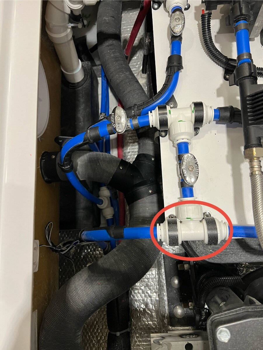

@Lori L yes check those John Guest fittings, we had a loose one.
Make sure the pex tubing is securely into the John Guest fitting until it stops, and then twist the locking nut to secure it in place. These locking nuts can come loose.
