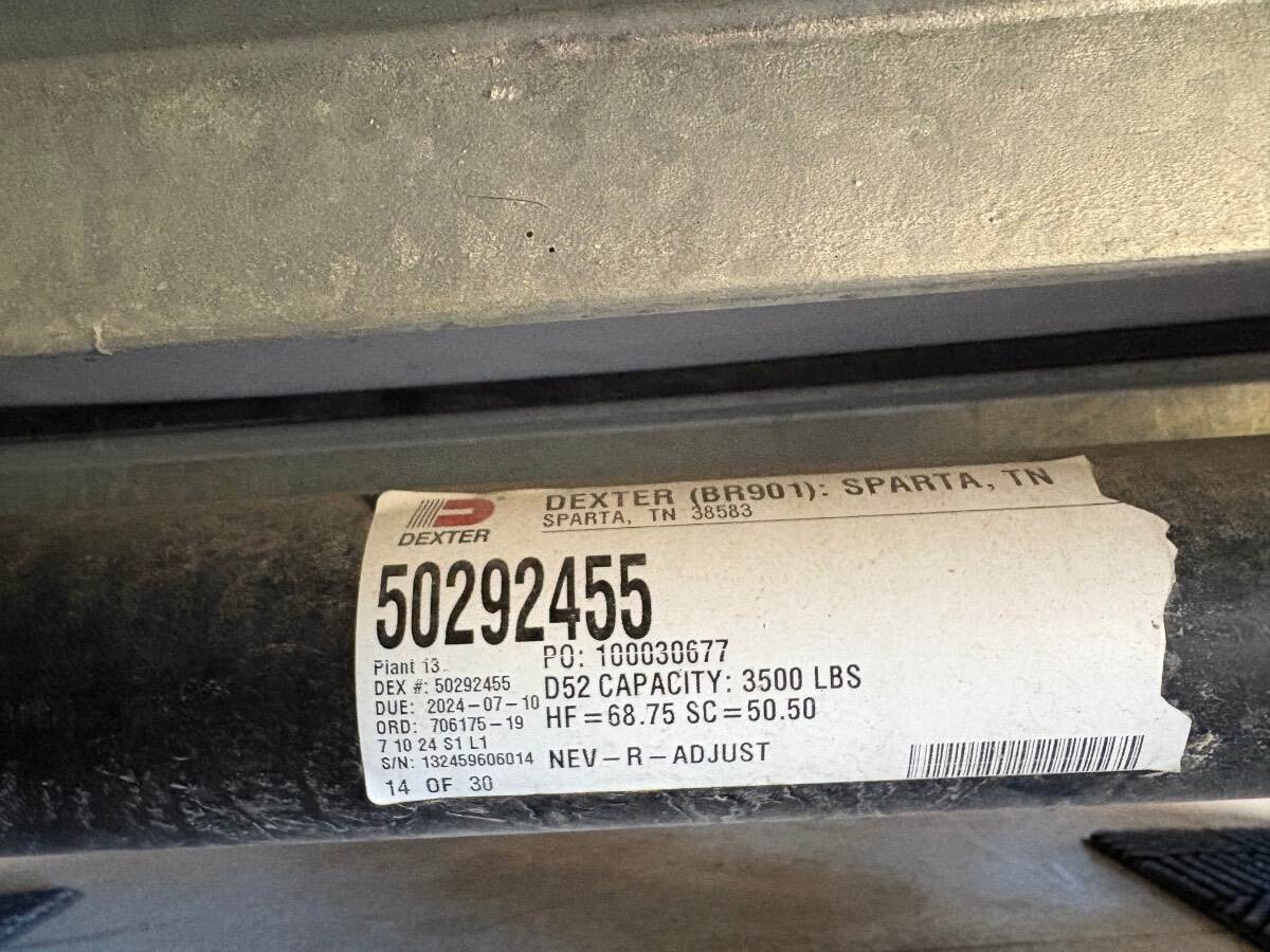

This has nothing really to do with Oliver. 3500 lb axels and 6 year old trailer. The main contributing cause for these 4 leaf failures, are living near the coast, driving on chemically treated roads, resulting in rusting.
The OP was clear on his driving on a washboard road with deep chuck holes. This is a sure way to have 4-leaf spring failure.
Starting in 2022 Oliver went to the 5200 lb axels. There have been few if any failures on the trailers from 2022 to present.
