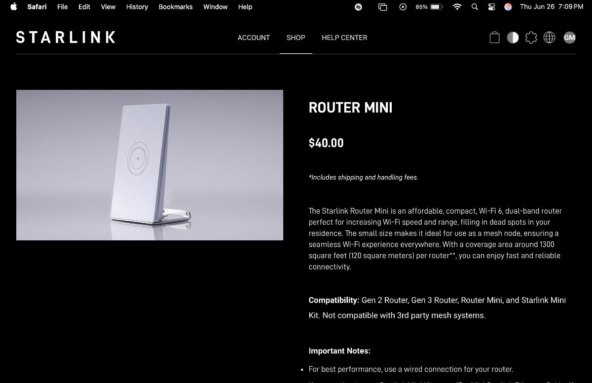

Starlink introduced the Mini Router in May, and it will hopefully address a shortfall in the Starlink Mini Dishy.  I had ordered one on Amazon for $99.99, but it was a month out for shipping.  I just checked the Starlink Store and wow!, they are only $40 with an estimated 3 day shipping!
The Mini Dishy has a built-in router, which is great!  However we often have to locate the Dishy further away from the trailer to get a treeless sky view.  The shortfall is that the farther away the dishy is, the weaker the WiFi signal becomes, which in turn slows down the internet speed.  Folks have addressed this in different ways, usually with a second router inside the trailer connected to the dishy with an RJ45 ethernet cable.  Others have combined them with Pepwave cellular routers to enhance data use, but that’s getting expensive.
The new Starlink Mini Router can be seamlessly connected wirelessly as a Mesh Node, or with an RJ45 cable.  It comes with a 120 volt wall wart for power.
Although I primarily bought this mini router to extend my home Starlink Gen-3 router WiFi coverage, I also plan to use on an upcoming trip with the Mini Dishy.  In all honesty, I’m not sure how effective it will be in the wireless mode.  It all depends if bandwidth will be lost in the WiFi signal boosting process.  Starlink recommends a RJ45 wired connection for best performance, so I’ll let you know how it works out.

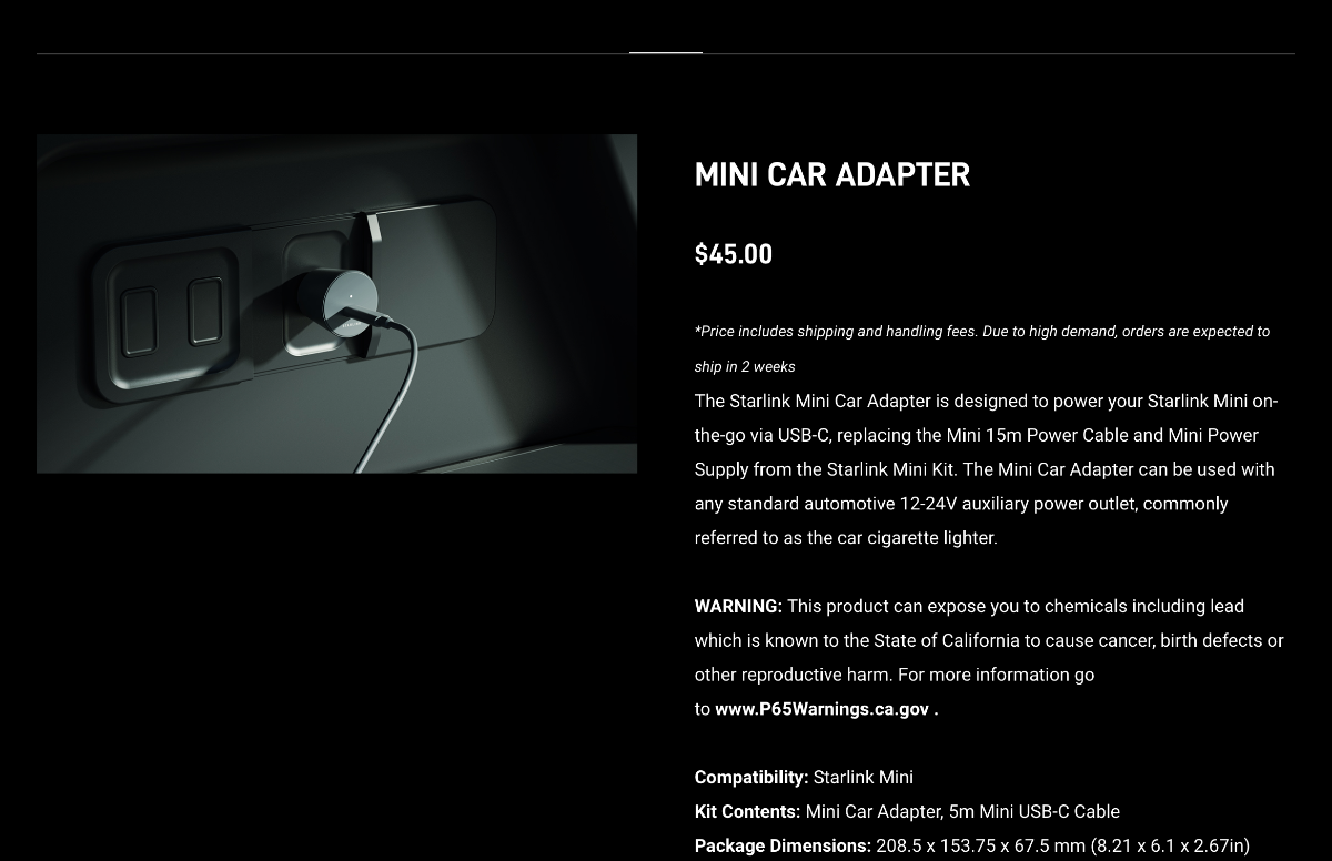

or Starlink offers the $45 Mini Car adapter to power it from a 12 volt cigarette lighter style plug.

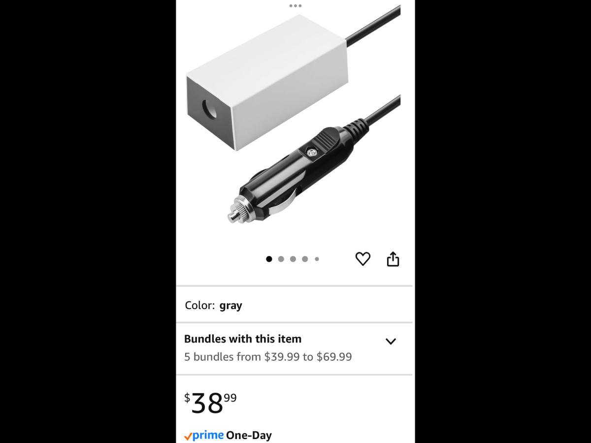

I bought an aftermarket Starlink Mini 12V cigarette lighter plug adapter/step up converter (12V to 36V) for about the same price.  I tested it with the kit 15m cable and measured 35.6V at distance. I’m primarily going to use it when traveling with the SLM on the TV’s dash or magnetic rooftop mount. This was an Amazon purchase, BarBaren/Stargear. The converter is in keeping with the design of the wall plug adapter that comes with the SLM kit, which steps up 12V to 30V.
EDIT: For additional savings, bundle pricing is offered wherein the subject adapter and a 16.4’ cable was acquired for an overall $18 price reduction; 12V adapter for $28.20 (reg. $38.99), cable for $18.79 (reg. $25.99). A bundle is also available for the adapter and a 6.5’ cable. I returned my initial purchase at $38.99 to take advantage of said bundle pricing.

Yes you can power it with a USB-C cord, but I question if your Anker charger can handle the wattage.  The router needs to be fed from a power supply rated at least 65 watts at about 20VDC.  Most USB-C power supplies, and outlets for phone chargers, cannot handle that wattage.  For example, some folks have replaced the Oliver USB outlets with USB-C outlets, but these are typically under 20 watts.
The 12vdc cigarette outlets can certainly handle the wattage, but be aware of plug-in adapters to USB-C because most are low wattage.
The Starlink power supply is good value at $45.  You would pay almost that much for an aftermarket power supply and cord, but you would not get the quality that Starlink is known for.

CORRECTION!  This post was Edited to correct some miss-information, and my apologies to anyone who ordered a Starlink Mini Car adapter to power the Mini Router.  According to Google AI, the Starlink Mini Router operates on a voltage range of 12 to 48 volts, but apparently AI is confusing it with the Mini Dishy.  From looking at the actual specifications on the Router nameplate and power supply, it operates on 9 VDC, or 120VAC.   This means that the Mini Car adapter will not work for the Mini Router, but it will still work for the Mini Dishy of course!  I should know better, because it's not the first time AI has tripped me up with bad information 🫢  I'll be looking at getting a 12 to 9VDC converter, but right now were packing for a road trip.

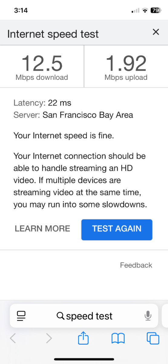

The new Starlink Mini Router showed up today, just two days shipping which is unheard of where I live.
It's only shirt pocket size, just a little bigger than my phone.   I couldn’t wait to test it, so I placed the Starlink Mini Dishy on the ground 45’ away from my bench.  It's powered from one of my home made portable rechargeable power supplies as seen in the photo.  The Mini router was on the bench separated from the Dishy by a 2x6 wall.  The results were great!
  • Standing next to the Dishy without the Mini Router, I got an impressive 163.9 Mbps download speed
  • From my bench without the Router, I got a paltry 12.5 Mbps
  • From my bench with the new Mini Router, I got a respectable 113.5 Mbps
  • If the router was hardwired with RJ45 cable, I suspect it would be the same speed as standing next to the Dishy.
The Mini Router paired in about 4 minutes using the Starlink App.  It showed up as a new Mesh-2 device, the App asked a few questions, and it was immediately working.  It really couldn’t have been easier.
IMG_4297.thumb.jpeg.f5824388e8dce24cde2587cd3da1dd56.jpegIMG_4301.thumb.jpeg.44c6ecbcdc1955973eea65fc5e21a498.jpegIMG_4305.thumb.PNG.cd0b7abee82855875be4251765542b00.PNGIMG_4308.thumb.PNG.97e9a9e316cb9eef5c407e5ff855d3ce.PNGIMG_4307.thumb.PNG.7f5d862fdf5179e8f6fa6ce06ef319e1.PNG
