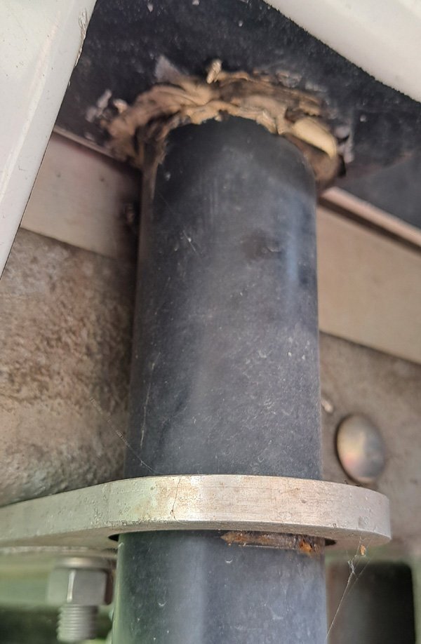

The feet on our stabilizer jacks are pretty rusty. Is this normal for our age camper?
If it's normal wear and tear, I'll leave it as is. If not, I'll remove, de-rust and repaint.
The caulking where the jack penetrates the hull is not very pretty and it looks like gravity has caused it to separate from the camper body is a few places (not visible in my soft photo).
What caulking is recommended?

That's not an unusual amount of rust for an 8-year-old trailer that lives in Kentucky.
I would apply Rust Mort to the jack foot plate, then a metal primer, then black spray paint.
I would cut off the old caulk, then apply butyl caulk at the jack penetration point.

Tony,
As a part of regular maintenance if it were me I would remove and clean and buy a quality can of black semi gloss rattle can paint up those jack “feet”. Just me.
Mine are still in good shape and have not rusted. I do not winter camp so that is likely why. Not sure if you live in a Northern State, but sodium chloride is brutal on all things metal.
While you’re under there clean off the old caulk and reapply a fresh bead. Good on you for inspecting these areas! 👍🏻
There is always something to do regarding ongoing maintenance, but once you knock it, out at least for me it’s a great feeling.

Thanks for the responses. The pad on the front jack is round and it looks fine. At least for now, I'll take our rear pads, brush off as much rust as possible, then repaint.
