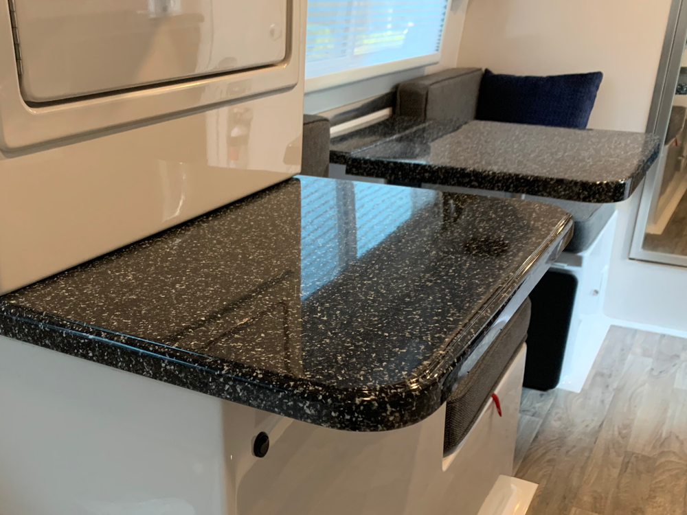

Very nice! We also found the dinette table to be too small, so I extended ours about 8” while maintaining the stock look. It, as well as the pantry landing, are now even with the outer edge of the street side twin bed. This is at the top of mods, surpassed only by the two sliding Lagon tables!
