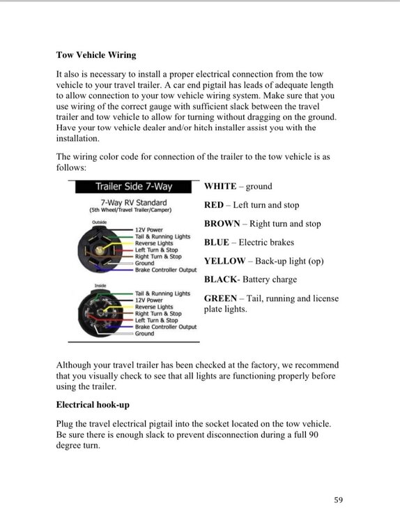

jd1923 Posted August 17, 2025 Posted August 17, 2025 4 hours ago, Gliddenwoods said: No....but after camp setup and driving around the next day all appears OK This means your truck alternator and starter batteries are fine. What is the SOC% of your LiFePO$ House Batteries when starting attached is an issue? 5 hours ago, CRM said: Put a test light between the ground and Aux on the trailer connector. You really need to test. It reads like this wire is hot, connected to your house batteries (shown RED in the picture, but it's the BLACK wire in the Oliver trailer harness). If it is, and until you can correct this, you need to disconnect the trailer harness whenever your truck engine is off for more than a short break. Anybody that does not have a multimeter and knows how to use it, should get a test light and learn to use it. This is all you need for this test (plus maybe a nail to use as a second pointer to touch inside the harness coupler): https://www.amazon.com/WINAMOO-Premium-Automotive-Extended-Circuits/dp/B08D9RY532/?th=1 3 Chris & John in Prescott, AZ | 2016 EII #113 | '01 Ram 2500 Cummins!
Moderators mossemi Posted August 18, 2025 Moderators Posted August 18, 2025 18 hours ago, jd1923 said: You really need to test. It reads like this wire is hot, connected to your house batteries (shown RED in the picture, but it's the BLACK wire in the Oliver trailer harness). The picture below is from the 2017 OTT LE2 manual. Mossey Mike and Krunch Lutz, FL 2017 LEII #193 “the dog house”
